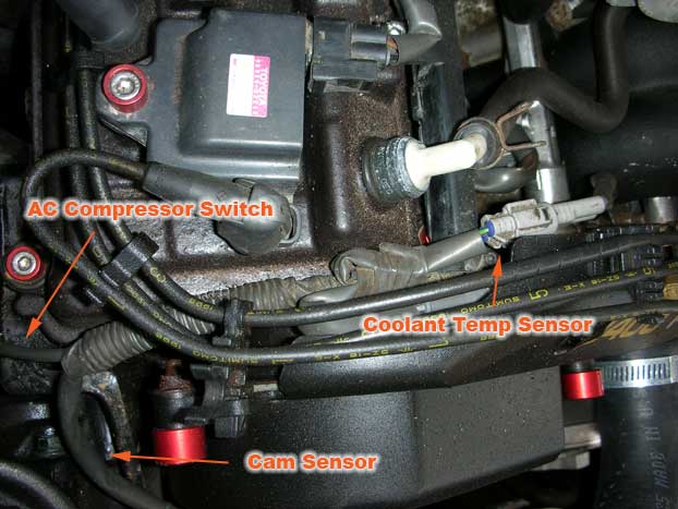

I was wondering if anyone knows if older 3.4's have an extra sensor on the intake mani. I have one clip that i cannot figure out what it goes to. Its located near injector clip #1 at the front passenger side of the engine. There is no place for it on the 97 taco intake mani and i cant remember where i unclipped it from on the t100. In the same place i believe there is a knock sensor (or something on the head) that is hooked up and another clip that ataches to a sub harness (goes to the a/c compressor)
To sumarize, there are 3 clips, 2 hooked up, third is unknown. I know this is really hard to understand so i will get a picture tonight and post it tomorrow

Is it the cam sensor connection you are talking about?

Well i got the truck running, just had to connect power to the white with red and she started sparking.
The connector that i could not identify was for some part of the egr (maybe a vsv valve). Im not using emissions as i do not have the evap box, so what should i do with the original 3.0 charcoal canister? remove?
