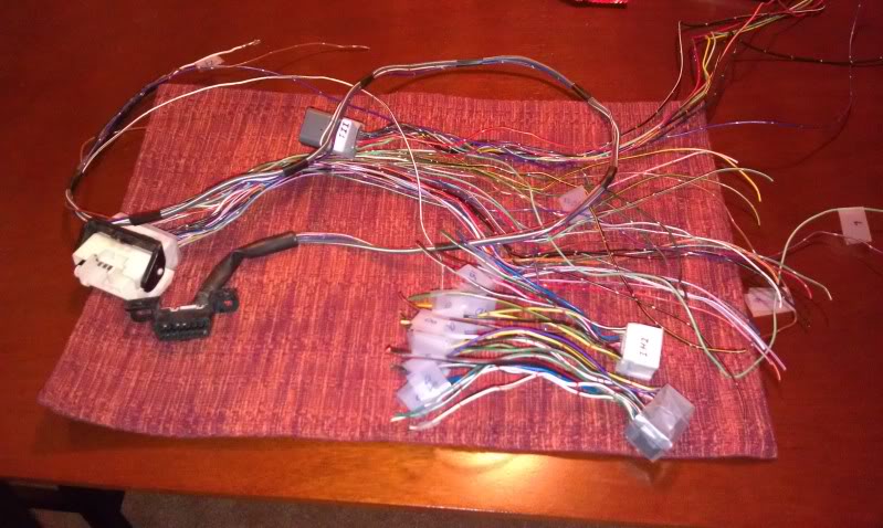

I didn't actually take any pictures of my completed conversion harness, but here's a picture of the various connectors sitting loose on my kitchen table:
On the left are the 3.4 connectors, minus the E8 connector and the small gray plug at the top (II1) wasn't needed, there was 1 wire that i moved over to a blank spot in the II3 (big white connector with the black "handle"). On the right are the 2 connectors from the 3.0 engine harness that were used to tie the 3.4 electronics to my 91's body/dash harness.
Yes, you'll want to add the OBD-II diagnostic connector (data link connector), not just if you live in an emissions controlled area (like California, where I live) but to help diagnose any swap related or future issue.
