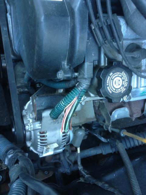

So just bought a 92 pickup originally 3.0 v6 converted to a 3.4 from a 97 4runner auto. after doing some research but not enough cause i'm asking this question now apparently... I don't have any o2 sensors wired up so wondering which one of these wires if any are suppose to be the o2 sensors? any help is greatly appreciated. thank you in advanced!
NVM I did some more research Just need to do even more to find pinouts going to switch to manual ecu so i can have a functioning CEL
