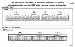

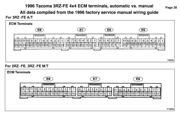

I'm doing a manual swap on my 96 2.7 4wd Tacoma, and I have a manual Ecu and was just wondering if you knew if it'll just plug in and work normally? Heard over on tacomaworld that it's just a letter of removing wires you don't need but could you just leave them there in case you ever need the auto again? Thanks in advance
Old Jan 24, 2016 | 02:04 AM
mosk's Avatar
Joined: Aug 2006
Posts: 67
From: SF Bay Area
No, not on a '96 - the 1996 A/T and M/T ECU connections are COMPLETELY DIFFERENT. For one thing, they have a different number of connectors:
1995.5 - 2004 Tacoma A/T vs M/T ECU pinouts-9kqgiva.png
But even more importantly, the wires move all over the place between the two versions. You will be moving (re-pinning) 90% of the wires in the harness to do this right.
Please read the guide I put together. The link is in the first post in this thread. It does all the heavy lifting on this, all you have to do is read it. The above image is from the guide, and it's followed by a list that shows exactly which wires you'll need to move to do this swap on a 1996.
