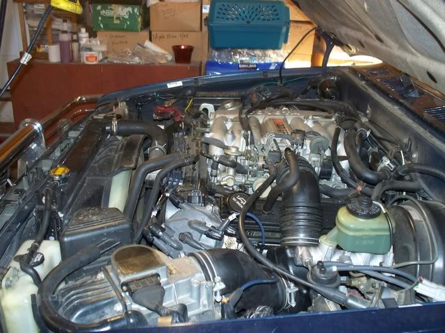

Alright so I'm a little over halfway done with my swap and figured I'd get a swap thread going on it before I forget everything I've done. My goal is to keep the a340h so I'm using an ECU from a T100 to control the tranny correctly. Anyways here's my 1992 with 196,000 that will be receiving the 3.4

And here's my 3.4 with 79,000 on it

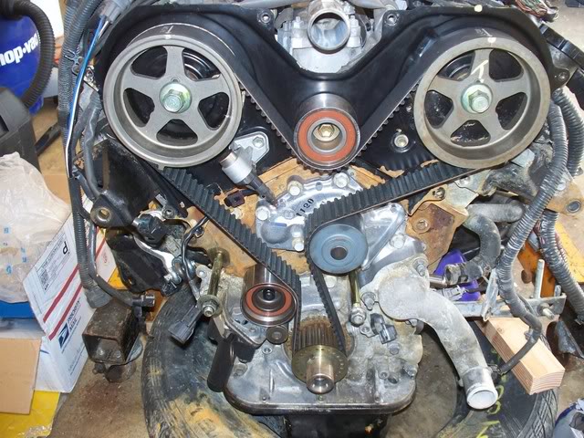

First I did the timing belt, water pump, idlers, etc. which for a newb like me took a while. I actually managed to break my crank pulley trying to get the bolt out, that thing was in there good. Had to take it back to the junkyard and they were kind enough to use there nice impact gun to get it off. Guess I heated that bolt a little too much.

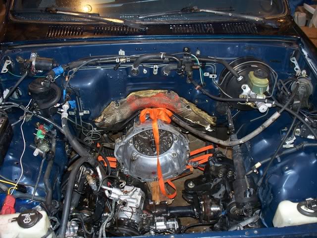

So here's my now empty engine bay

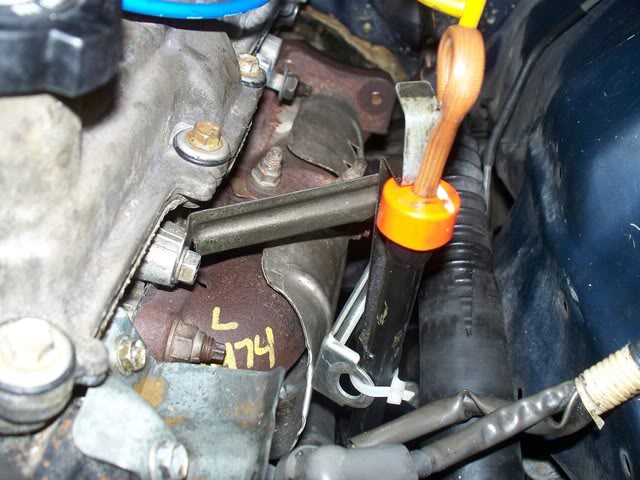

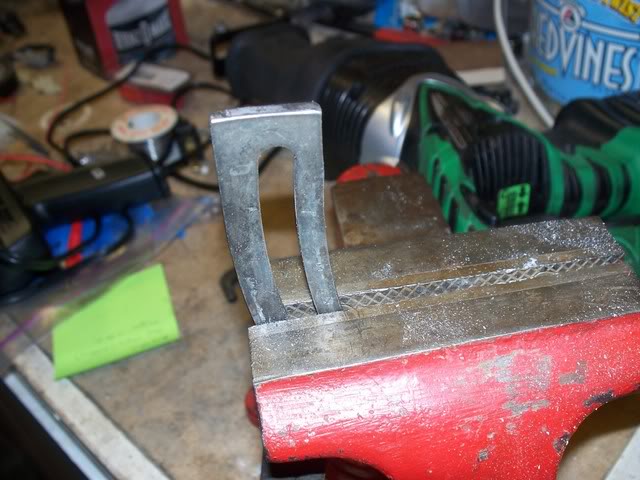

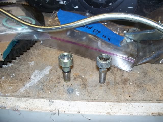

Next I removed the oil pans and knocked out the plugs to switch oil dipsticks. From what I've read these can be pretty stuck sometimes, but mine came out pretty easy. I broke them loose with some vice grips and then tapped them out from underneath with a 1/4 ratchet extension.
I then took the plug from the 3.4 and put it in the old dipstick location, had to grind it down a bit to get it to fit but tapped it in with some ratchet extensions and it went in. Found out later that I should have cut some of the end of the plug because it ended up hitting the 3.0 baffle. The 3.0 dipstick plug went in no problem. I also put rtv on both them so their sealed up good.
Next i switched the 3.0 oil pan, baffle and pickup tube over to the 3.4. As stated above I ended up drilling a hole in the baffle so the plug would fit, but not really a problem. A hint for those using the 3.0 baffle, don't forget to remove the studs used for the 3.4 baffle, I just so happened to be sitting in such a way that I didn't see them and for the life of me couldn't find out why my pickup tube wouldn't go on. After several minutes of frustration i finally noticed them and took them out and everything bolted right up.

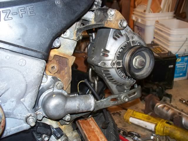

I'm using my 3.0 alt on the 3.4 brackets, the lower bracket took some bending to line up right but wasn't too hard. I'm also using the 3.0 thermostat housing as it takes up a lot less room than the 3.4's.

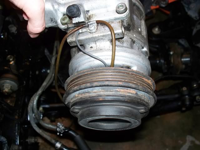

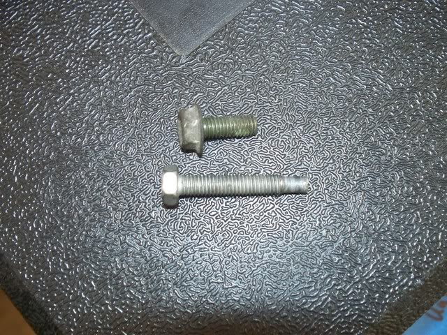

I'm keeping the A/C from the 3.0 so yesterday I took of the pulley, used a bolt off one of the 3.0's heater hose clamps to remove the top plate, worked perfectly. Hers the stock bolt and the heater hose bolt

I also finished swapping the 3.4 pulley onto the A/C compressor, here's the 3.0 and 3.4 pulley's
and the finished product, it all bolted right back up without problems

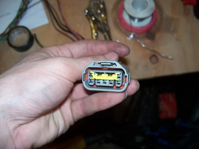

The 3.4's all ready to go in now except for a new oil cooler hose so hopefully tomorrow it goes in. In the mean time I've got some wiring to figure out. Currently I'm working on swapping the A340H plugs onto the T100 harness and ran into a few things I'm not totally sure about. First the T100 harness has this guy

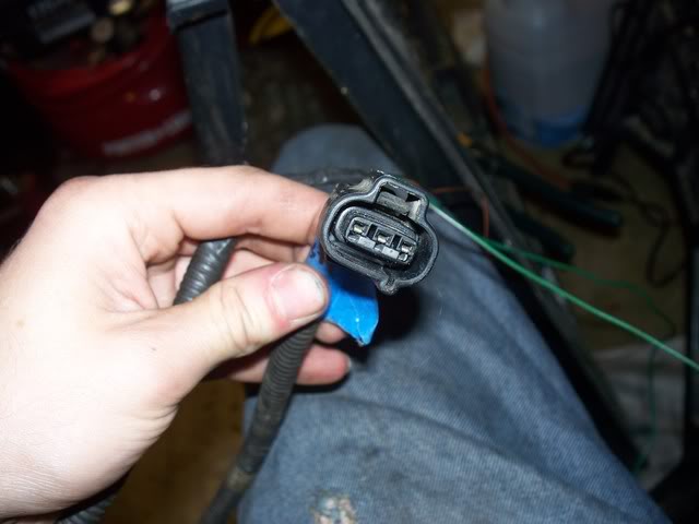

which I have identified to be plug D3 which is used for the transfer neutral position switch, not really sure what the function of that switch is for which is half my problem. The other half of my problem is that my '92 had no such wiring, it shows it in the EWD here:
http://i1097.photobucket.com/albums/...6/4wdat1-2.jpg
But my C1 plug has no wires in pin 17 or 24, so I'm just guessing that this is something I don't need to use and for now it won't be wired up to anything.

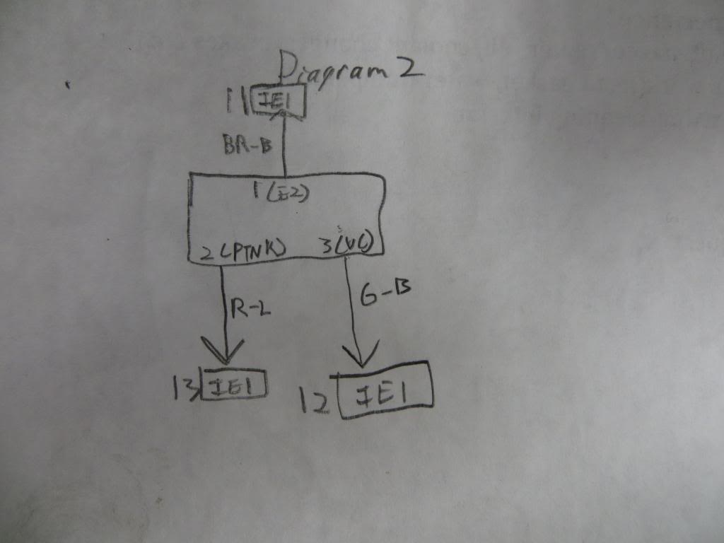

My second wiring problem I've run into with the transmission plugs is on plug E3 for the '92. Pin number 4 is a Brown-Black wire and I can't find what the purpose of it is anywhere. Searched through all my EWD's and found no usage for E3 pin4. So I got out the ohm meter and found that it somehow connects to this pin here:
http://i1097.photobucket.com/albums/...206/ect1-1.jpg
The EWD doesn't show it connecting into that wire so not sure where it goes, the rest of the plug is hooked up to the solenoids and the speed sensor. So for now its going to be left orphaned.
My last issue is also shown in that last link, the speed sensor is shown to be grounded along with all of the solenoids, however in the T100 the speed sensor appears to be grounded a bit differently
http://i1097.photobucket.com/albums/...1ect5972-1.jpg
I don't really think this will be an issue, so the BR wire on plug V1 for the T100 will be left unused as the speed sensor for the A340H is already grounded. If my reasoning seems incorrect to anyone feel free to chime in.

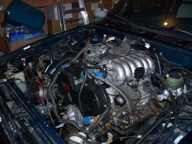

Alright so yesterday the stars finally aligned and I got the 3.4 in! It was my first time installing an engine so it took like 2 hours to get everything lined up right but it was worth it.
Granted I don't have my intake on yet or any of the accessories, but the engine bay looks so much more open with a 3.4 in there instead of the 3.0. Only hiccup of the install was I went to put my A/C compressor onto the block and the line into the cab from the compressor started leaking, the foam cover thing on it moved and I guess that was all that was keeping about 5-6 pin holes from opening up. Maybe this is a case when oil and grime on everything is a good thing, helps to seal stuff up. So looks like I'll be getting a 3.4 compressor anyways. Wish it could have leaked when I took the 3.0 out, but oh well.
Looks like I'm definitely getting a hood scoop
Just have to finish bolting up the torque converter tomorrow and I can really start to get this thing together. I finalized all of my wiring so just have to solder together my conversion harness now, after I verify it works I'll make sure and post it up.

First of... IT RUNS!!! Not perfect yet but more on that later.
So to start of where i left off. Got the torque converter bolted up to the drive plate and the tranny bolts tightened up. Next I installed all the accessories to the engine. My alternator barely cleared, which is common so I cut the end off of the 3.4 bracket:

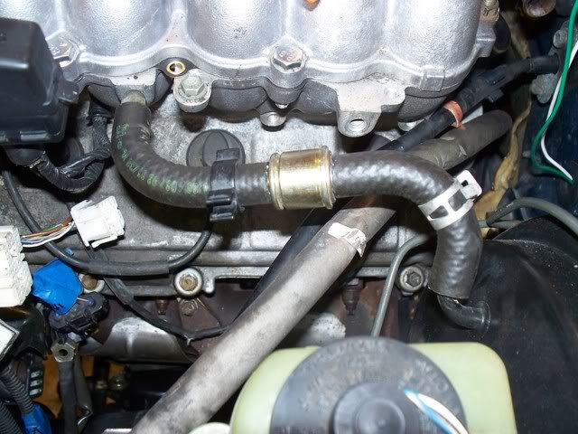

Hooked up the brake booster, just cut the old hose and put the valve in the middle

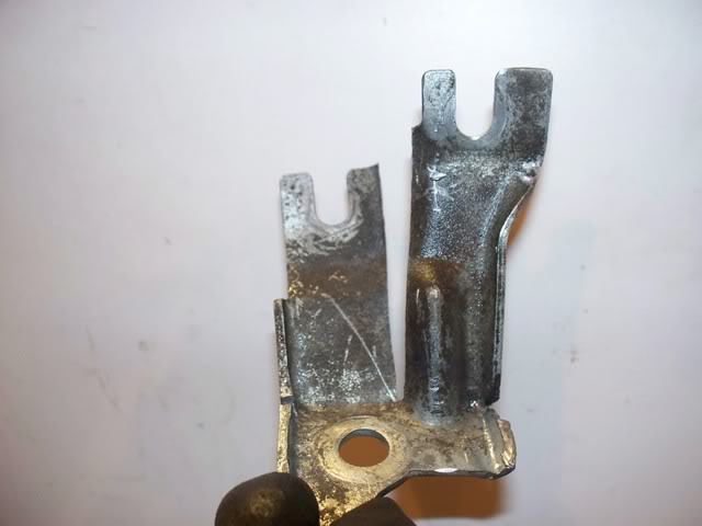

Next I had to cut and modify the throttle cable bracket so the cables would sit right
Then I used a bracket from the 3.4 I was no longer using and it worked great as a bracket for the 3.0 dipstick tube

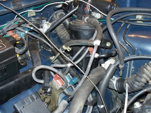

Then I set up the evap system using the 3.0 canister using the diagram in Evolta's thread

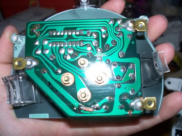

Here's the tach mod using 10k ohm resistor, worked just as I expected

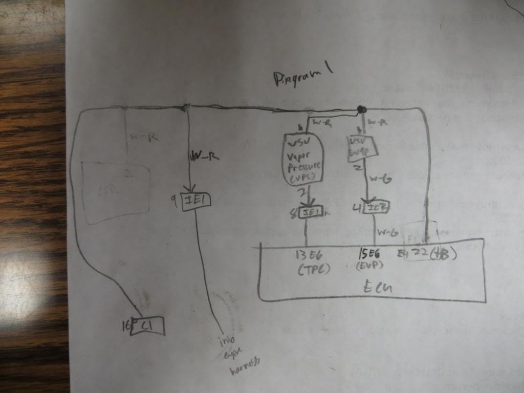

Because I used a T100 engine harness it doesn't have any VSV wiring (located in body harness) so I used the vsv wiring off of the 3.0 and it worked just fine. Heres where I pulled the vsv wiring, speedo speed sensor wiring and starter wiring through the firewall grommet

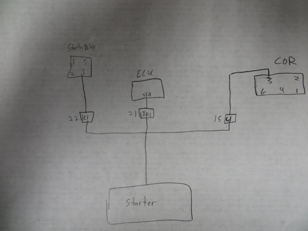

For my starter relay I had to do some wiring in the fuse box, don't trust the pinouts on the actual relay in the fusebox, pins 1 and 2 were switched on mine so look in your EWD for the correct pins.

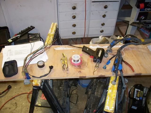

And here's some pictures of the many headed beast known as my conversion harness

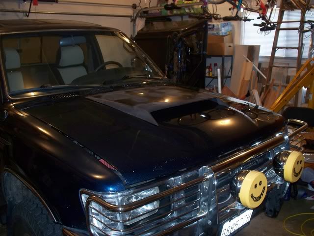

And a few pics of my hood scoop. Its for a '79 mustang got it off ebay. Definitely need to do some more work on it to make it look nice but ran out of time.
This pic isn't the finished product, but the best one I have at the moment

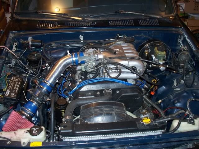

So it started on the first try which I was stocked about, made all those weeks of wiring worth it. Still have a few things to figured out though. The tranny seems to shift hard when shifting between P-R-N-D but seems to be fine when in drive going down the road. Unfortunately I got it started 2 days before I had to leave for college and had to leave the truck at home as I didn't want to drive it without having the bugs worked out and have all my hard work wasted. I do have a few codes which I'm guessing are for the second O2 sensor which I don't have put in, probably just going to get a simulator. Those are the only problems so far, 4wd appears to work and I did keep ADD, not sure if 4lo is actually engaging as I haven't wired up a relay to the 4th solenoid yet, just didn't have time to test everything as I had to leave. So my dad's going to see what he can figure out on it hopefully when I'm home for Christmas break I'll finally have a truck again.

Sorry to revive an ancient thread, but it was brought to my attention that I forgot to put up some of the diagrams I used for my wiring. So here are the diagrams my wiring references.
Diagram 1
Diagram 2
Starter Diagram
