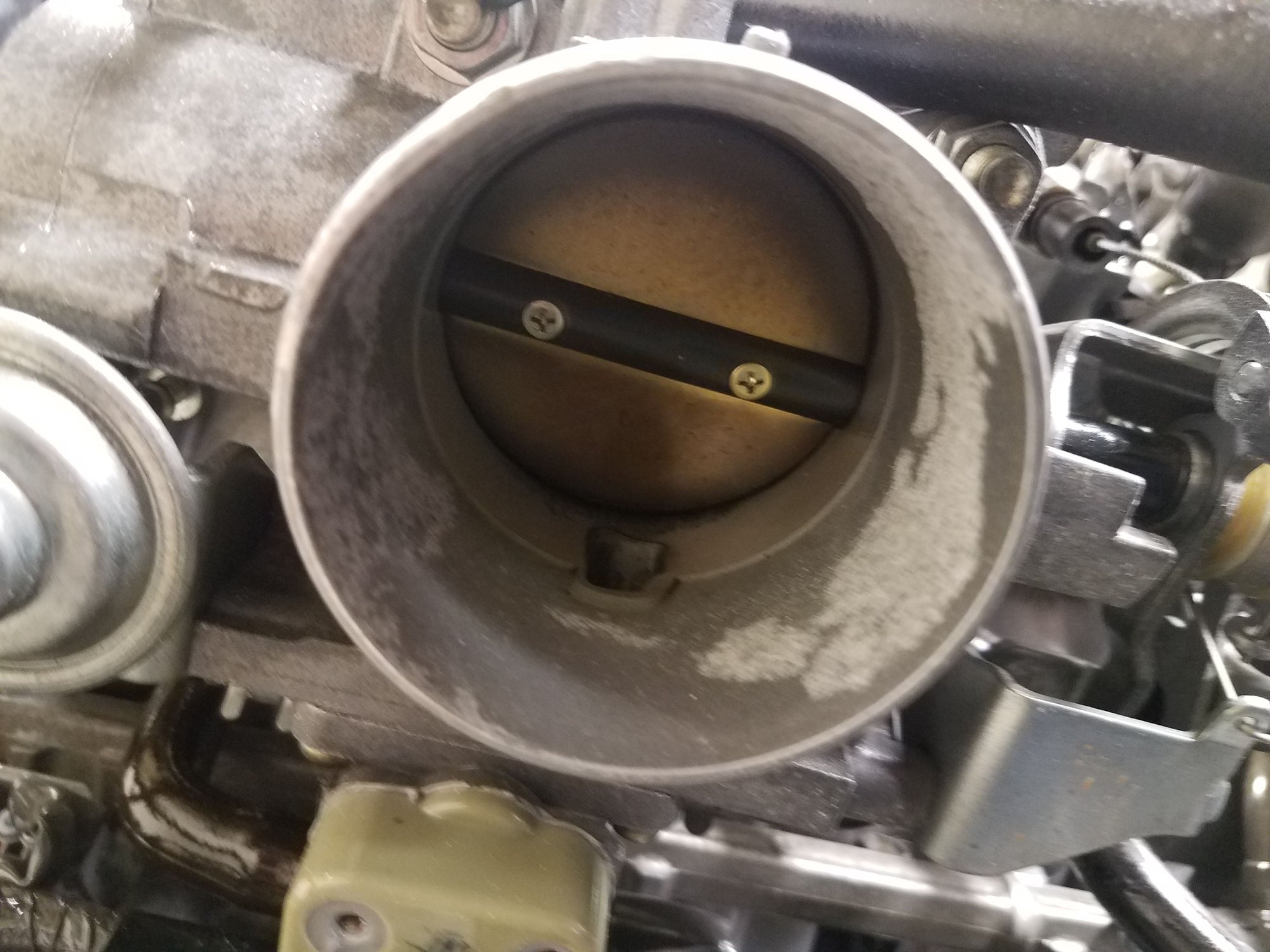

Thanks smaay, I will hope to find a 5 speed 4wd. It appears that I need an ecu that wants an EGR valve and a drive by cable? Sounds like the 2002 engine used a drive by wire so I can rule that out. I'm guessing 2003 then since the EGR is newer on the 5vz run? Maybe a 2000 ECU and harness would be a good bet too? If anyone can help identify the year of this engine that would be super helpful. Pics of the throttle body attached.

the pics cant help, i suggest a 1995 T100. It does not have an EGR. my manifolds have a OEM block off plate where the EGR would be. the engine can be any year, you just need the right sensors and ECU.
