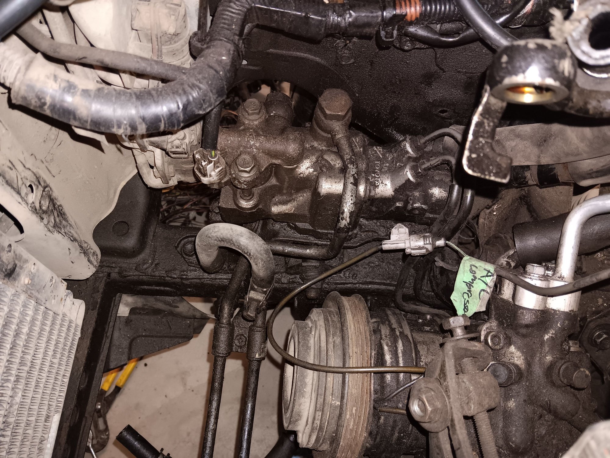

Old Mar 24, 2024 | 07:54 PM
brandt01's Avatar
Joined: Jan 2024
Posts: 26
This would be the abs servo correct? Still not sure where those extra hoses from the 3.0 pump would go. Looks like there are only the two lines that go into the servo and those ones i could connect to the 3.4 pump.

Your images is indeed of the rear wheel ABS servo.
Some PS pumps are fitted with a unit with two small (quarter inch, or so) vacuum lines that run to a setup on the intake plenum that increases idle speed when the PS box is cramped, so that the engine might not stall.
That unit is what your last image shows.
