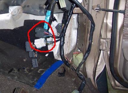

So the mechanical part is done now comes the wiring and im already lost...
first thing is in my pic what do I do with the 2 plugs that I circled?
I believe those are the 2 plugs I splice for the dash?
Also on the 3.4 ECU the is 4 groups of pinouts
My 3.4 wiring harness only has 3 plugs
is the fourth plug on the 98 tacoma the motor came from?
Any Additional wiring information would be great

As for the 2 plugs I circled where do those go?
You could just buy the plug (not pins) and then repin the plug, but getting the right plug to fit your ECU may be pretty hard unless you have a good parts guy that really wants to help you. As I said before, even Mike @ ORS who knows exactly what to order has a hard time getting them new. And there is some trick as to how the wires are held into the plug (I can't help with that).

As far as the 2 plugs you circled, those get plugged into the conversion harness you are apparently going to attempt to make yourself. What were they plugged into before?

Those plugged into the 3.0l wiring harness so I guess that they will now plug into the 3.4

Old May 23, 2007 | 04:21 PM
ORS's Avatar
ORS
Joined: Jun 2006
Posts: 141
The two plugs that you have circled go to the 3.0 engine harness. In order to make the 3.4 run you will need an adapter harness that fits between the 3.0 body harness (circled plugs) and the 3.4 engine harness. In this conversion harness you will need provisions for the OBD II port, Evap system, ADD, speed sensor, O2 sensor and many other systems. Every different year combination will have a different design of what is included in the adapter harness. It is not possible to re-pin both the 3.0 and 3.4 harnesses and plug them into each other. That is why these are such complicated harnesses to build.
The plugs needed for the harness are very challenging to get. Some of them are not possible to buy new and have to be salvaged off of donor vehicles.
Let me know if you have any questions or would like to order a harness.

Here are a couple things to think about if you are going to make your own harness. You will need to have the FSM for both the donor vehicle and your vehicle. These harnesses take a long time to design, the process of building it is the easy part. Be prepared to spend a lot of time studying the entire wiring harnesses for both vehicles. You need to take into consideration every wiring aspect of both trucks.
