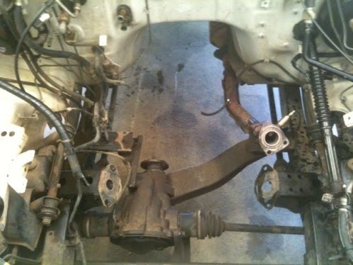

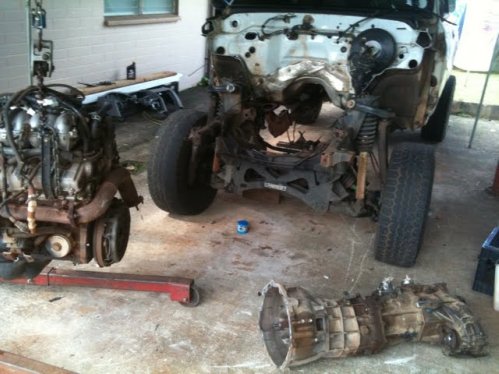

I have started swaping a 2004 3.4 tacoma engine into my 1992 Rocky Daihatsu. The plan is to do the engine swap then drive the vehicle while I gather all the parts to do a straight axle swap with toyota axles.
I have already got the engine and trans mounted in the rocky now im working on all the other stuff.
I will start posting pictures soon.
Attached Thumbnails 3.4 into my rocky Daihatsu-rocky_eng_bay.jpg   3.4 into my rocky Daihatsu-3.4.jpg   3.4 into my rocky Daihatsu-3.4-installed.jpg

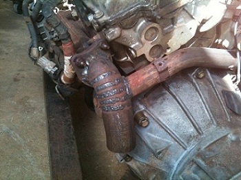

I made the crossover pipe using some scrap pieces of tubing I had laying around. I guess it came out ok, but after looking at some of the other ones on this forum I am thinking im gona make a new one. I think the 04 crossover pipe is diff than some of the older ones, it had an inner and outer shell which made it unable to be modify and reused. Any one know which years have the single pipe style??

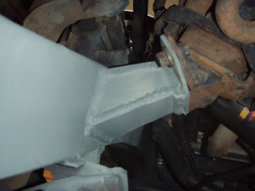

motor mounts made with 3/16 plate
