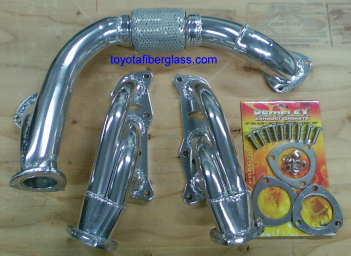

ok .. here we go
these are 1.5" tube headers into 2.5" down pipes .
These are the "kits" EXACTLY as pictured >
3 gaskets and stainless hardware included
"brite" ceramic coat set . $650.00 + freight and package .
we also have these available in a "black" ceramic coat for same pricing

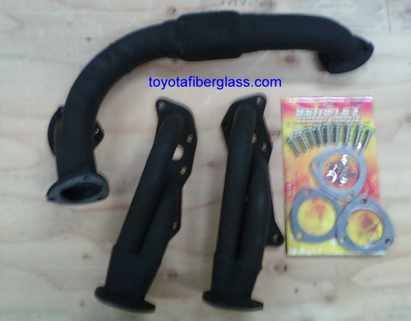

black VHT paint ... $480.00 + freight and package .
for BEST results , this coating must be "baked" either in an oven or on the vehicle - instructions will be included .

We do have a bit of a "back log " .. Obviously the people whom have submitted there deposits will get theres first ..
if you haven't sent a deposit ... SOONEST you could expect delivery at this moment , would be Aug 2014

opps , sorry , not exactly as pictured
you will also get another 3 bolt flange so you can build your header pipe to connect to your exhaust
