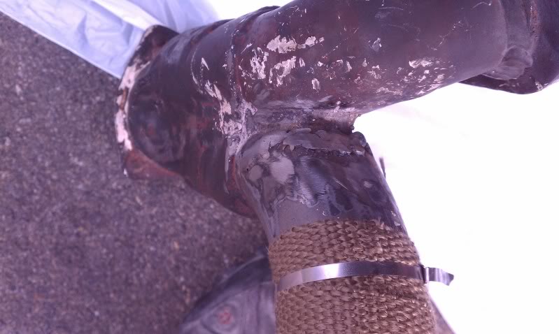

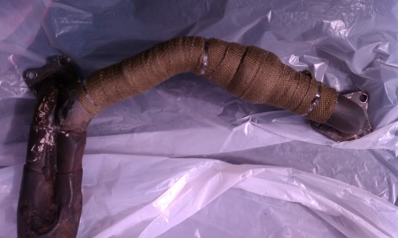

Those are sweet! I'm jealous. I just finished pulling my stock modified crossover off yesterday to intall the flex joint because it cracked where the pipes meet on the drivers side. This was not fun! had to drop the trans to get it off. I would install the flex pipe just in case so you can avoid problems later.
Here you can see where I welded and grinded the crack. I also wrapped the pipe w heat wrap but not completely. I read it causes it to get too hot so I left part of the pipe uncovered.
