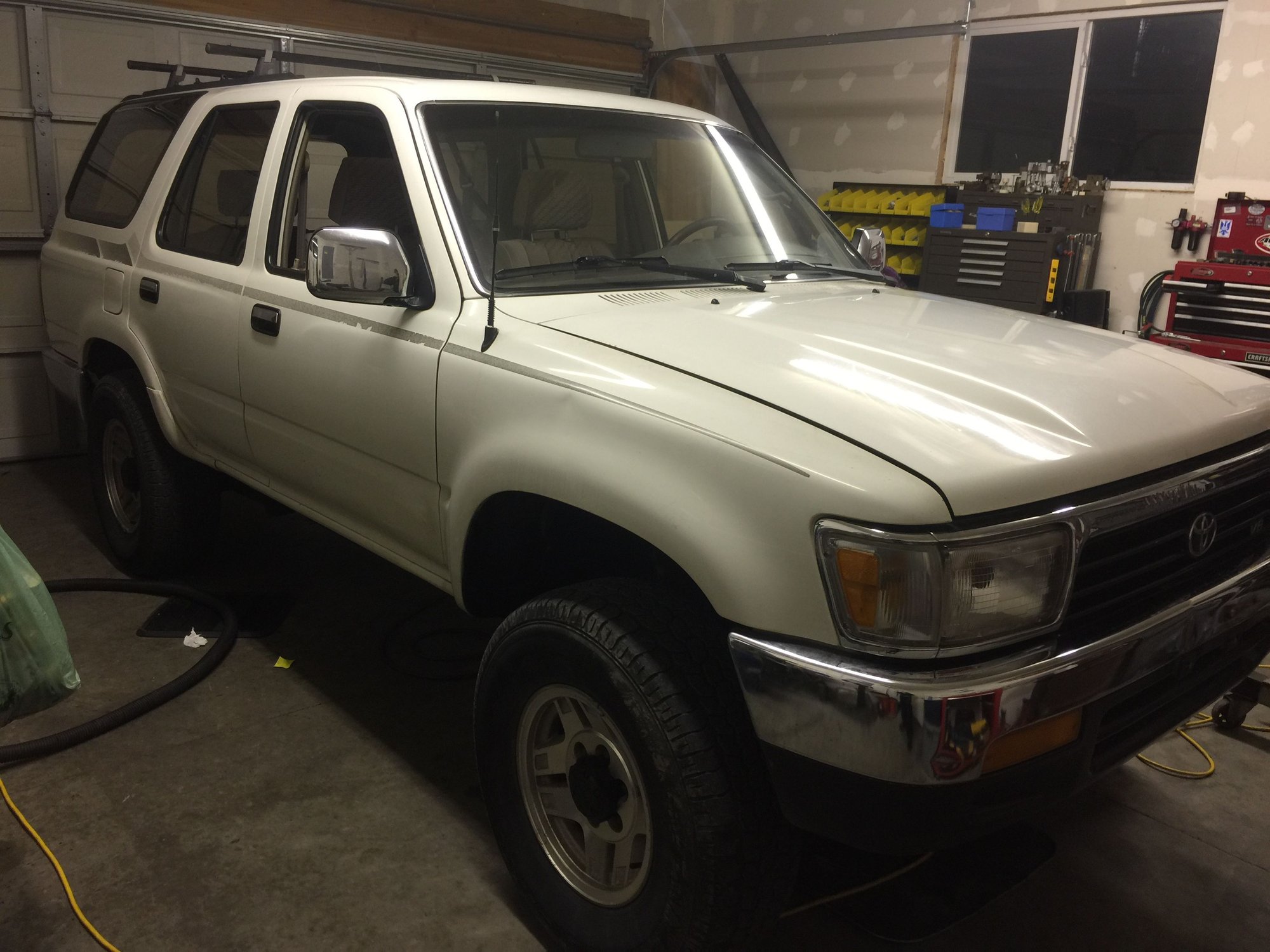

3.4/1994/g144
Bought this beauty for $500.00.
Limped her back home.
Vaccumed, engine removed, and transmission.

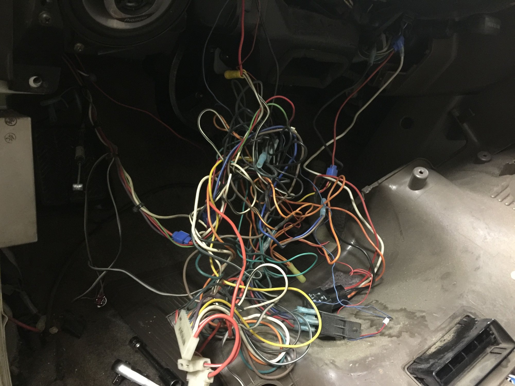

Then found this mess under the steering column. 1994 alarm system by homeowner...
Awesome...
