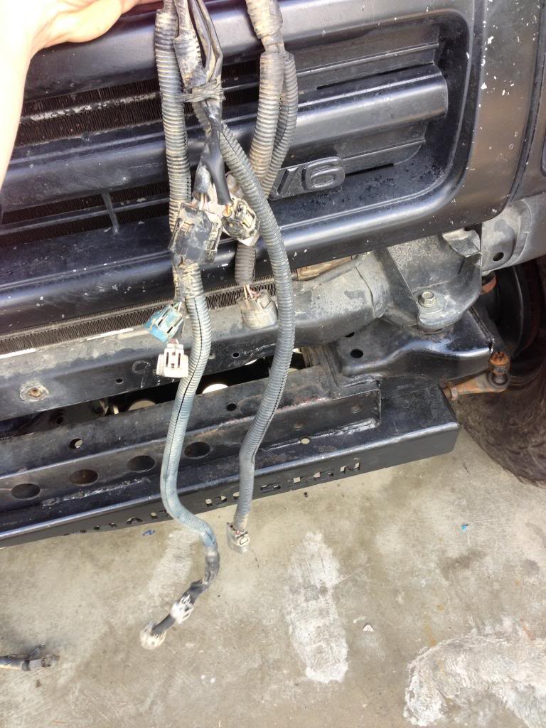

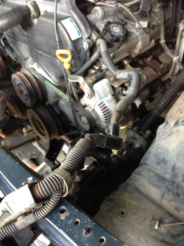

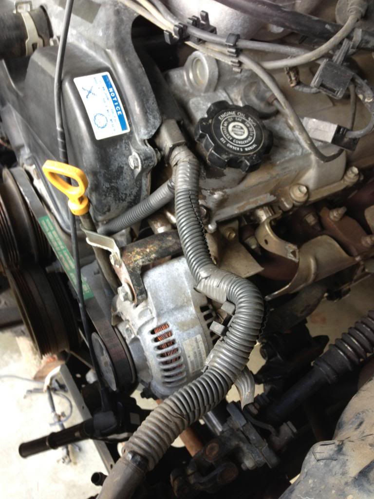

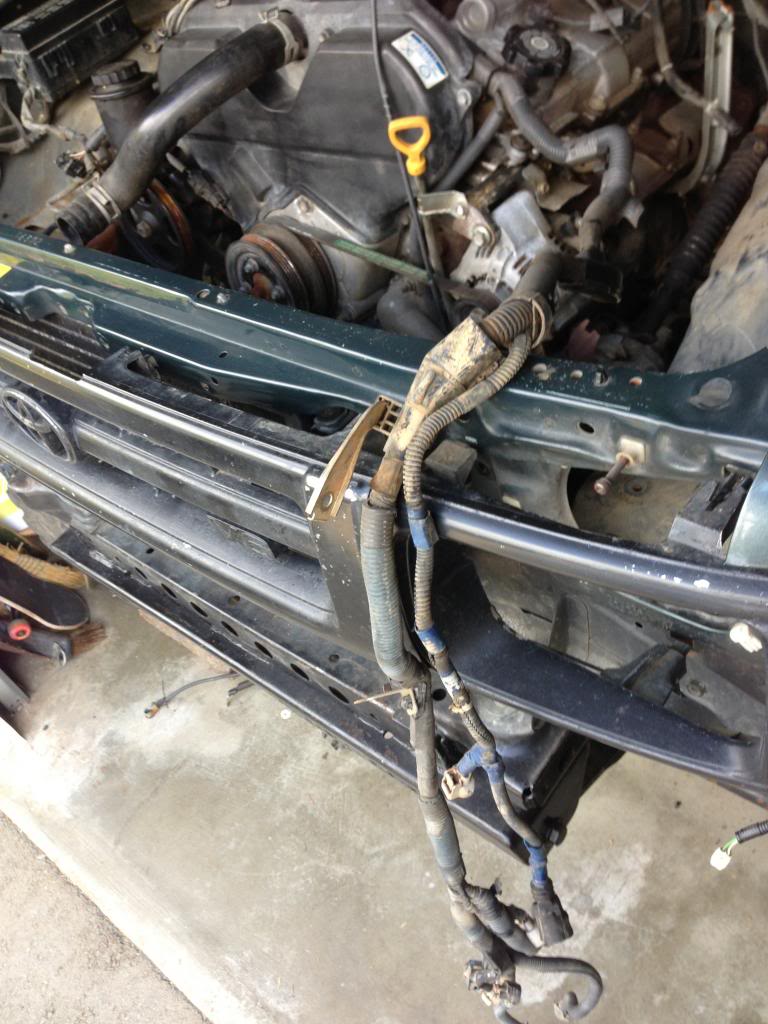

Hello i am in the progress of doing a 3.4 swap out of a 1998 4runner into my 93 pickup both manuals. So i have the motor in with the cross over built and i got the ORS harness. I have some newbie questions on this and that is i have these plugs coming from the front of the motor and i have no clue where they go? any help would be great thank you!

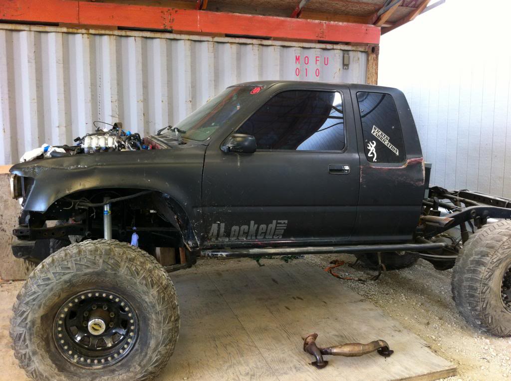

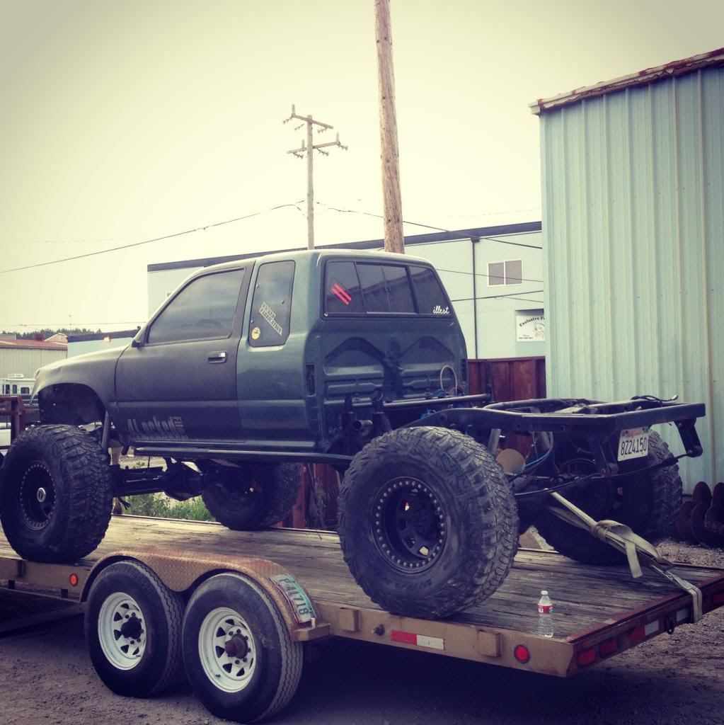

heres a couple pics of the truck also

All the plugs for the tranny, backup lights, 4x4 indicator, o2 plugs, speed sensor to transfer case, etc. a Ewd should list everything you have there. Just look at the pages that shows the plugs physically.

Thank you!! idk why i didnt think of that.haha more newb questions..What is an Ewd and where can i get one? and will those plugs mate with my tranny, transfer case's? the donor was a 5sp 4runner and my in a 5sp also? Thanks again!

EWD = Electronic Wiring Diagram
www.techinfo.toyota.com/‎
$15 for 2 days access to all the Factory Service Manuals, EWDs, Service Bulletins, etc that Toyota has produced for all vehicles since 1989 (or 1990); well worth the money to download everything for your truck and the donor truck.

why does that engine seem to be sitting up so high ?
Yea i was wondering the same thing.
Noticed that some of those plugs should be for the evap system or vacuum sensing valves.
just a thought.

Your not trying to use the 3.4 mounts are you.?
