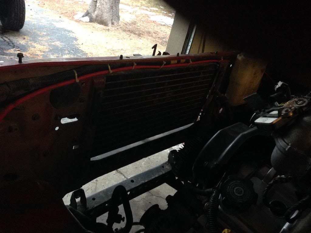

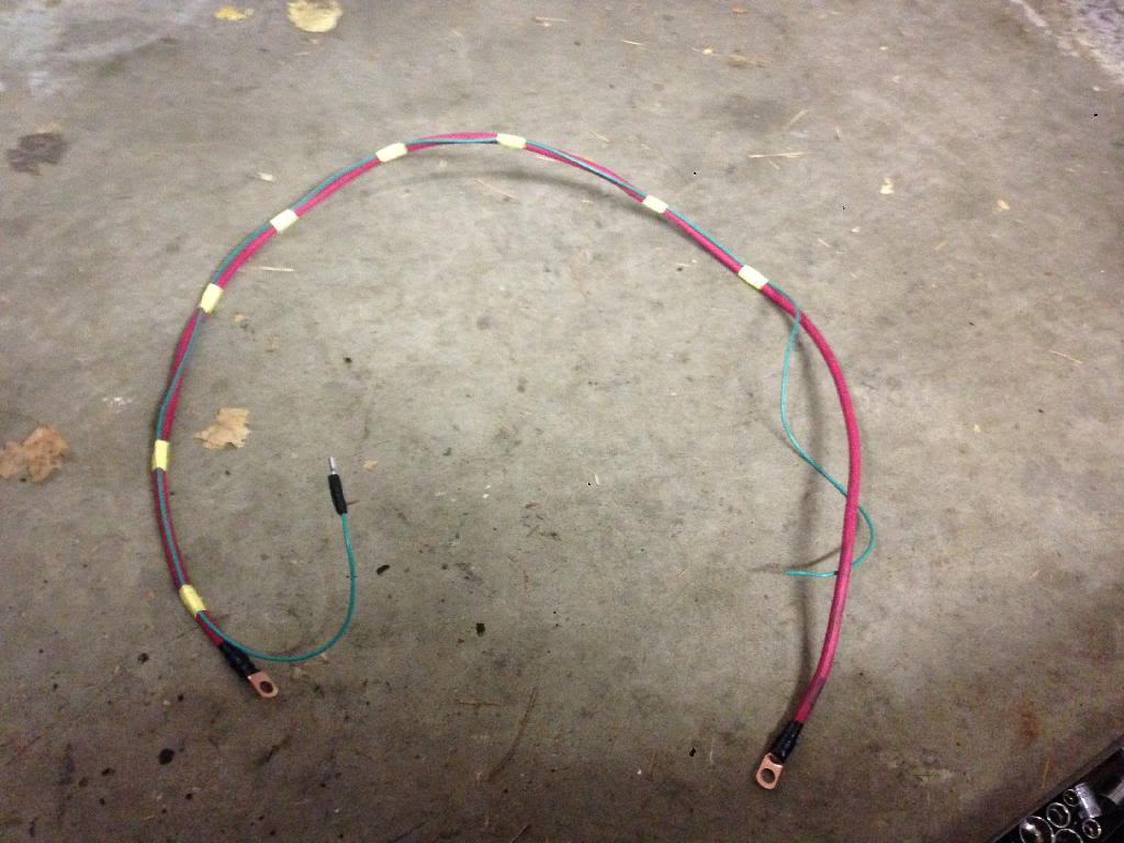

Had to build a battery harness cause all the wires in mine were carotid as hell. Name:  17641333-210E-437F-A011-04E0C9AE2C08_zps9qh4onc1.jpg
Size:  95.1 KB ran out of black tape :-P

Originally Posted by Moto260
I'm not sure of other people's opinions, but I would highly suggest running that 4 gauge wire through some of that plastic split-loom tubing (like the wires zip tied above it) just to provide a little more insulation and protection from heat/sharp objects/corrosion; it looks like that's going to be connected directly to the batter without any fuses and you'd hate for that to wire to short out (think car on fire). In my mind its just another layer of protection and pretty cheap insurance.
Overall, looks good.

That's a good idea SacRunner. I like that a lot better than what I did. Thanks for the advise :-D

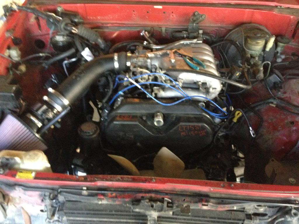

Alright here she is. Pretty much done until my wiring is here. Hopefully this week. Name:  1920F1B8-393B-4DE2-9D02-D945630779A2_zpsegnvfy3j.jpg
Here's a couple issues I'm having at this point.

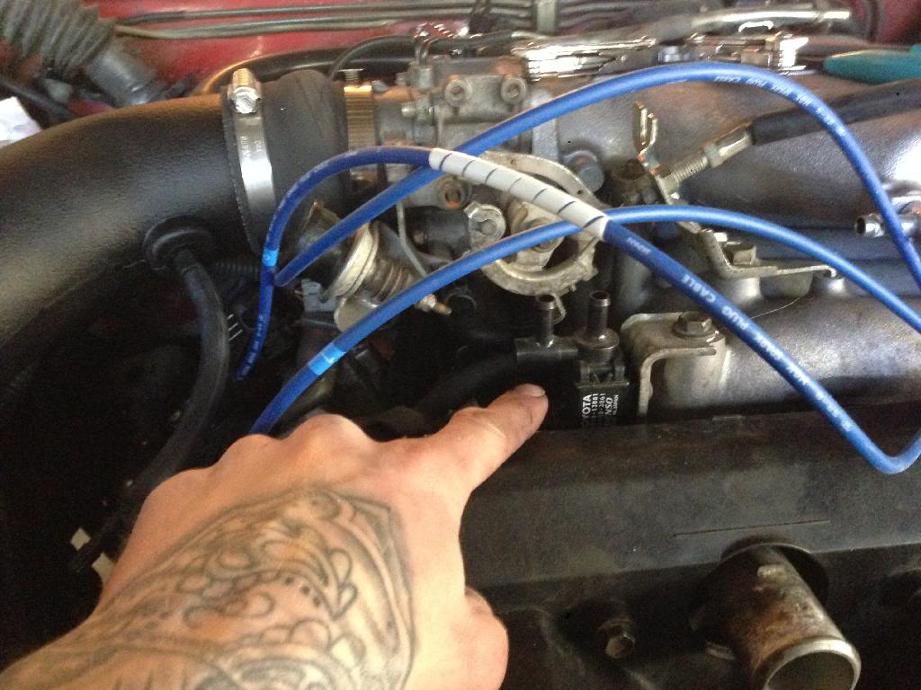

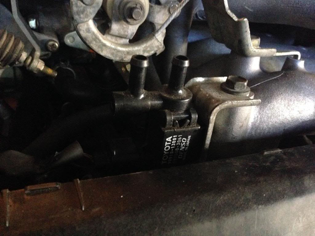

This plug under my intake manifold I don't know where to route?? Any suggestions? I know one goes to my intake tube but I don't know which one. Name:  67A4B111-06D6-4852-89AA-03386C8F866C_zpsnnt5j7wz.jpg
Size:  107.1 KB. Here's a closer pic. Name:  BBB569F3-02F8-471D-A54C-5BD22A0E76FB_zpspkaki6y8.jpg

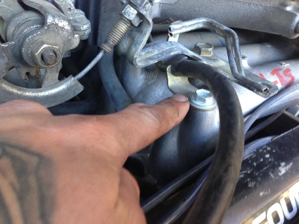

This is the one on my other 3.4 swap (no plug there) just that one line then goes to my intake system. (Hatin the little things that are different between the two) Name:  F5412F77-26CE-41C9-B014-89AB6B916B89_zpsqrmtzju7.jpg

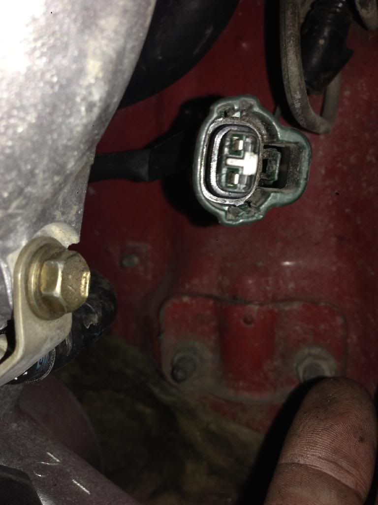

Also having an issue adding that's VSV because I don't have a plug left for it.... I have one plug left Name:  8C456338-B06D-4483-9F36-51ED863141D3_zpsuxrpzalt.jpg
Size:  58.9 KB and it don't fit... I know I got the right VSV cause I matched up the part number. But there ain't any other plugs that I could use for that. Hopefully I'm missing it and it'll pop out while I'm doing the rest of the wiring haha. Thanks for any advise guys Talk soon

Figured the port on the front out. Googled some pics zoomed in easy as that. And got my wiring today. Gonna work on that tomorrow. And hopefully I'll figure the VSV stuff out as well. Give an update tomorrow

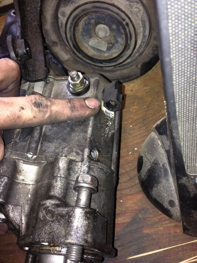

Pretty sure I know what your mystery relay is for. Once upon a time I thought my starter was on its last leg in my 89 Runner…..pulled the starter and brought it to a honest starter repair man. He informed me that my prized Original Denzo starter was strong as ever and recommended I look elsewhere for the problem. Well, after a little research I found that that my particular Runner is one in which the juice to turn the starter over actually travels thru the harness and ignition switch (I believe) and then back to the starter via the larger wire….as the years pile on and things loosed up in the ignition you can not pass enough juice thru to the starter.
Cheap solution is to mount a $7 relay under the hood…take the larger wire that currently goes to the starter and simply use it to close the relay…….minimal juice required. Then take the power lead from the new relay and connect to the starter. This worked like a champ and has functioned perfect for about 30,000 miles and 3 years. Much less than a new ignition switch and/or other problem component replacement. Now, I’m not saying that this is the best way to fix it but it is a common way to fix it and worked well for me. I am just starting to research a 3.4 or other swap and came across your thread.
Now it appears that your previous owner also included the on/off switch in the cab which would I assume break the circuit and prevent the truck from starting unless in the closed position.
The question is will this problem that likely exist in your Runner (that was bypassed with the relay) be eliminated with the 3.4 swap. Guys at ORS or someone more familiar with the wiring portion of this swap could answer that.
If you have it running then I guess it was bypassed by the swap. If you have what appears to be starter problems maybe not.
Hope that helps.
