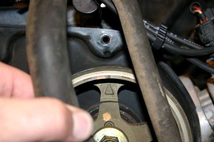

i am in the process of changing my timing belt, i have the new one on and am able to fire my 4runner up. I have the timing makes all lined up as they are "supposed to be". as you see in my pics though- there are marker spots 1 tooth back of the factory markers on one of the cams. When i fired up my 4runner, i noticed a slight smoke from the tail pipe. it smelt as if it were running rich. Are my timing marks right and my ignition timing need to be set up or what or are 2 of 3 makrs right and 1 need to be set back to that ink spot? post your thoughts.

your marks look good. what color was the smoke

what do you figure about the marker from the previous timing belt change being 1 tooth back on that one cam sprocket?
Old May 23, 2005 | 05:02 PM
DudeBud's Avatar
Joined: Mar 2005
Posts: 1,871
From: WA ,monroe
i do believe that thoes paint marks are on mine too not sure why one cam was set back a tooth maybe just a mess up from the previous owner

im pretty sure the timing was done a a dealership. I called and got records
Old May 23, 2005 | 05:09 PM
DudeBud's Avatar
Joined: Mar 2005
Posts: 1,871
From: WA ,monroe
yep thats why it was messed up and they probably did a crapy job on the headgaskets. dealership sucks unless they have techs that know what they are doing
