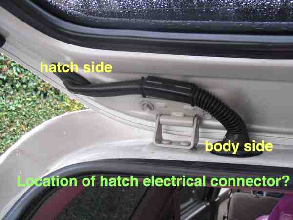

I'm the guy with the dead hatch
I've already tried the 'jiggle the wiper' thing and the fuse is good. The taillights & rear dome light work but no hatch. The dealer wants $90 just to look at it. I'm determined to figure this thing out and keep my cash for some Burtman clear corners!
First off, does anyone know where the connection is to the body and hatch? I want to make sure it's plugged in snug but can't even find it. There's a pic below for reference.

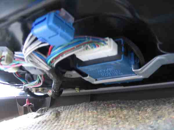

I Got It!
I figured it out!!
I decided to pull the trim panel off the hatch and discovered a few plugs. Sure enough, one wasn't seated. Turned on the car and everything works perfectly.
Here's a picture of the white plug that I clicked in. It must be the master connector because it was the only thing that needed to be seated to make everything work.
