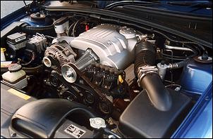

Don't have the intake tube built yet.... I am also considering getting a Holden Gen IV M90 housing that they used on the L67 powered Commodores. You can pick up a housing for around $250 or so if you look in the right places. The Gen IV had a 75-80* bend in the inlet side from the factory to clear the firewall. The engine I have for the truck is in my wife's car right now, but we will be buying her another ride in the next couple of months as long as I can get another travel job or two by then. (I am a traveling iron worker.) It already has a ported M90, 3.4" pulley, 72mm throttle body, LT1 MAF, and a few other goodies.

Hey Nash,
Is this the style housing, Your looking at?
https://www.yotatech.com/attachment....1&d=1213321829
I cant seem to get My hands on one.
