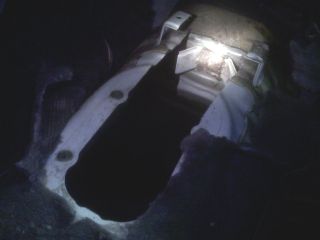

hah yeah they would, i'd like to do that swap but im pretty much broke right now with christmas and all. i called advance adapters and they said that their headers dump in the same spot as the manifolds that i have now do so they wont work. they said to try and find some manifolds out of an 80's camaro so i might hit up the junk yard this weekend. i put a 3" body lift on it and it wasnt enough. the tranny is about two inches to tall so last night i had to cut out the floor board under part of the dashboard to get it to fit. so now i guess ill get to put some sweet dimond plate in there to try and cover it up

BTW, I thought the kit says you have to cut the floor boards a little to get the tranny to fit. I'm assuming you got a kit, and you are installing a 700-R4 Transmission.
