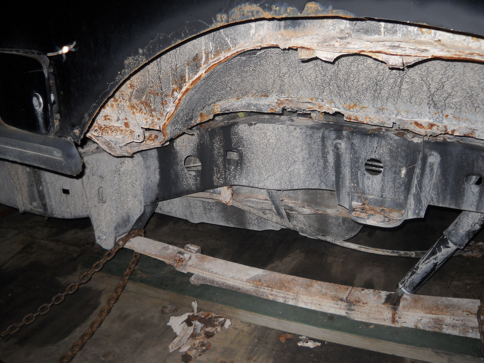

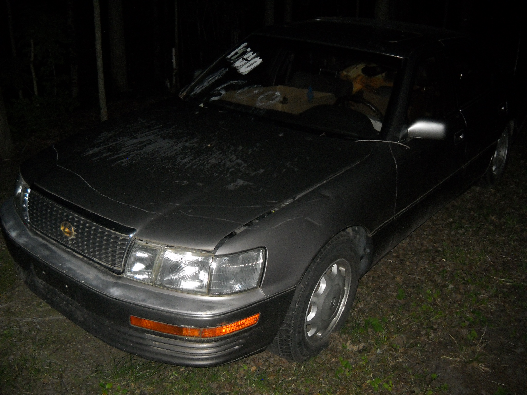

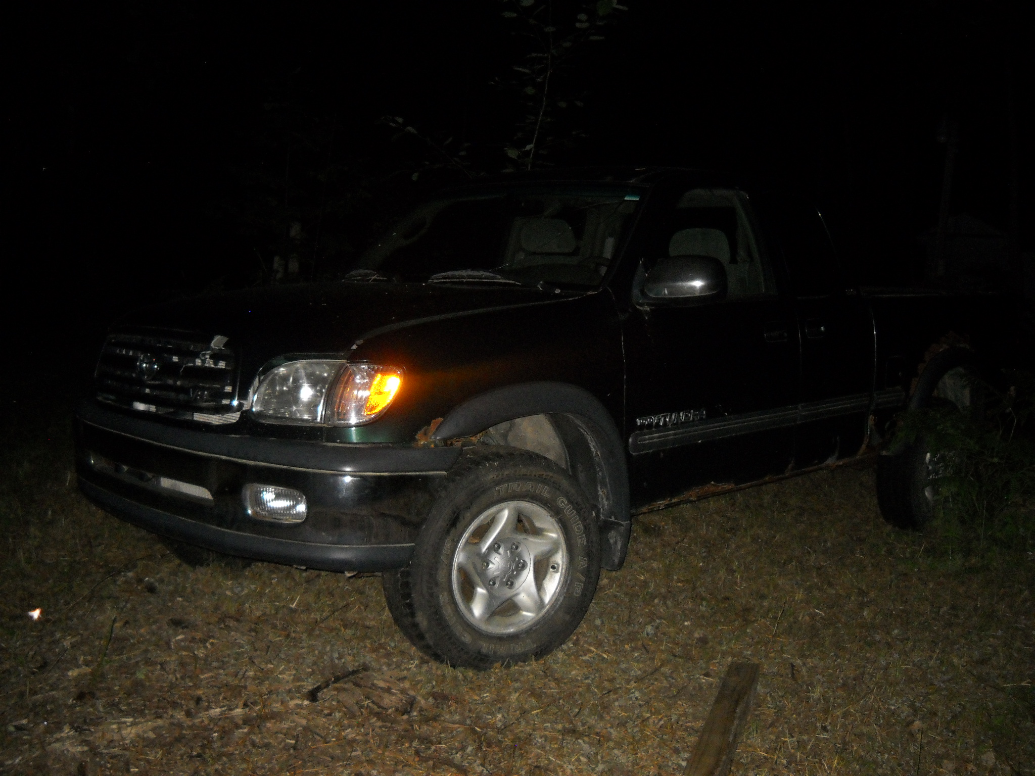

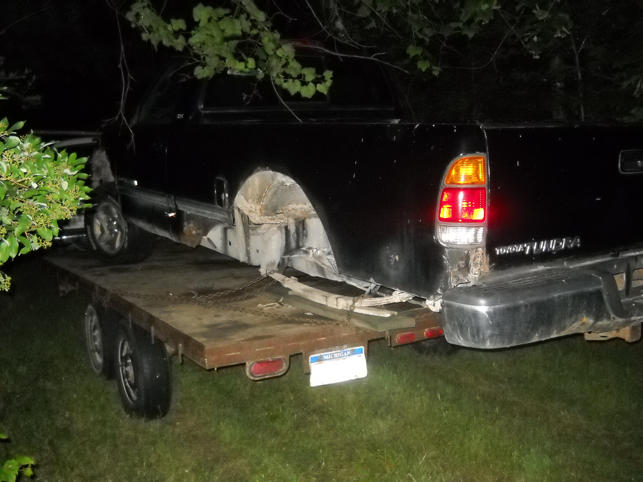

Here are some pics, dark but should show a bit of what I have. Yes, the new framed truck is a standard cab, the green access cab is the one I plan to use, and planning to build my own box since both are pretty bad. Lexus has no title or I'd be driving it (needs miner electronics to make got reliably).
Sadly the new frame truck has a lot of stuff missing, the last owner used it as a parts truck, and the other one with a rusty frame was the "good" truck which has a bad trans. New frame truck has and engine and trans, but is missing transfercase, rear axle, front axle, drive shaves, and heater control knobs of what I've seen so far. Front end is barely together, have to pull bolts and such from the other truck or buy new to make it right.
Also are windshields, doors and rear windows interchangeable for the tundras reg cab vs access cab? The reg cab will probably be parted out after I make sure all is well with the access cab (needs grill and windshield for sure). Driver's seat bottom in one of them was ripped, so I'll be using the best of the two. The access cab truck has the SR5 TRD off road package, so the rear axle should be limit slip. Other truck is just SR5 I think.
For the frame, I'm planning to take everything apart, and clean/anti seize all the bolts. Axles I'm planning to sand/paint and such too, pretty much the drive line I'm making the best I can without spending a ton of money. The cab isn't the greatest, Might cut out the bad sections and weld in some new sheet metal to try to stop the rust, but might be best to replace the cab in 3-5 years from now if/when I find one in good shape within my price range. My dad has a chain lift that works pretty well for pulling cabs and such.
Oh the truck should be 4.10 gear ratio based on the door sticker (both are A03A). even though I read 3.91 is the common ratio on these trucks.
