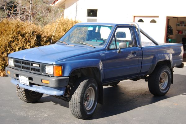

I have missed my old truck and decided I wanted another toyota. Tonight I bought an 86 turbo truck, Cleanest truck I have seen of this age EVER. The bad is that the turbo is blown and the guy said a shop diagnosed it with needing a top end rebuld/new cylinder rings (The motor will run and even drive as is, just very low on power with the turbo not working) I have a couple options, I am not very mechanicly enclined. I could get a shade tree mechanic off craigslist to rebuild it (not going to be able to afford $100/hr labor) or I was wondering if I could get a regular 22re to swap into it...or open to other ideas....
Looking forward to making some toyota friends and hearinging thoughts on which direction I should go. Thanks for the input!

The original motor has oil passages for the turbo stock, the 22re does not also different compression for the turbo, my advice save the cash and get it rebuilt, I'm sure someone else will chime in for possible other differences.
And of course save the money and do it right will be cheaper in the end, and lets see some more pics of this turbo monster
