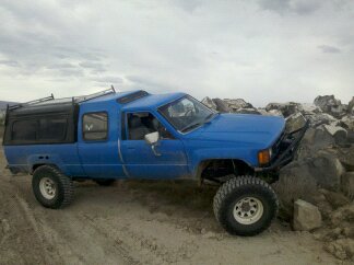

Well it started as i found it in the Washington state bush lol no craiglist. Guy sold it to me for 1000 but didn't realize it had 800 worth of parts in the bed. he told me to trash for him. so the truck was dead. i put a stroked out 22r into it and ran around on 33" tires at first. then my dad sold me the 35" BFG Km2 which are amazing. he made a father son deal that was kinda i couldn't not buy them or be a little slow in the head for the price. So 4" rough country indepent lift. Then i moved bases and with no gears took a 8hr drive to the next base into a 12hr drive. So on the look for gears i found a killer deal on front solid axle with High steer and limted slip detroit locker and rear gears and asui looker. The gear are 5.29. So i had a fab buddy in Idaho do the work and cut away the old set up and move my rear springs forward to the front and move the front axle position forward 3" and put 63" Chevy rear springs in the back. A total lift of 5" with leaf springs and 7" shackles. trail gear front and rear bumpers and 8000 pound winch. Which i never got stuck in my truck now has a blowen the 22r. I blow it up 1 mile past wal mart on the road going to pull a jeep out i mean a buddy lol.
old blue pics of it and the new camo paint job in the pic shows i need bigger than 35 because bump stops crushed no wheels in wheel wells so looking for 38.
