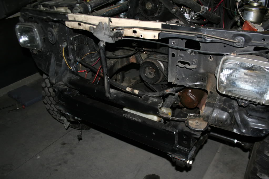

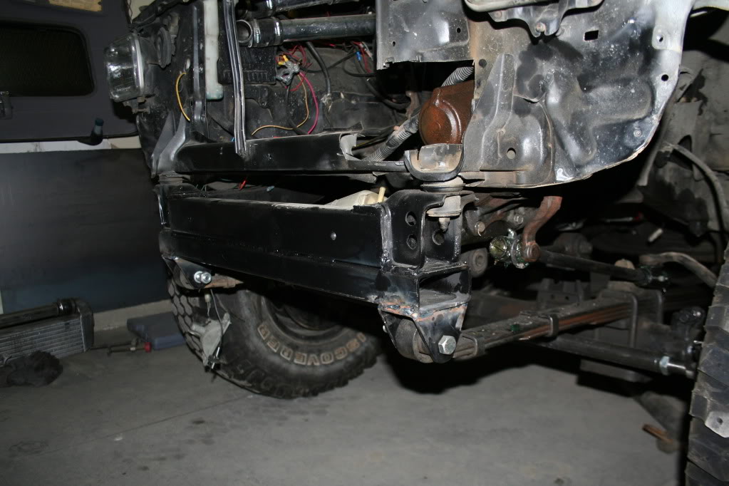

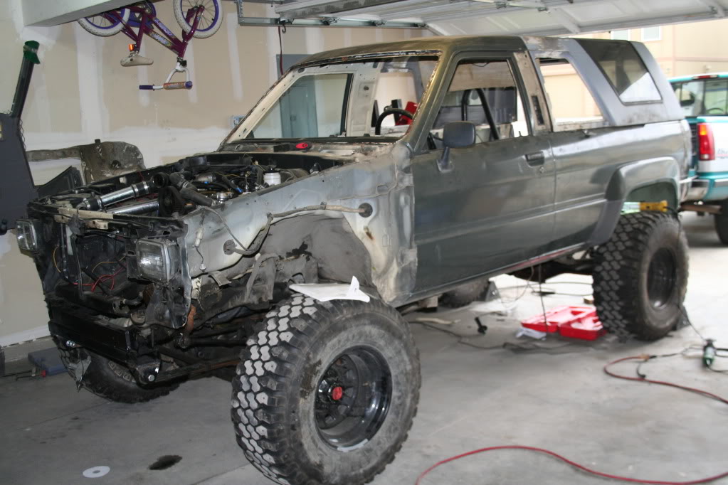

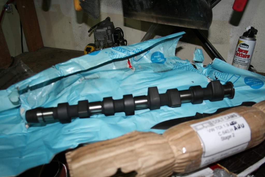

_check this out, I just got the stage 2 cam i bought in the mail, and it has a nick in the journal. should I run it or return it?

I would return it. Also, this build is so smart that it's stupid.

thx, and I got a new one coming in the mail now.

Sent that nicked cam back, should get it in the mail today or tomarrow along with a brand new aluminum dbl pass aluminum radiator. Once i get the cam, this build will take off.. slap the cam in install new balanced injectors with upgrade nozzles, hybrid turbo upgrade, 11mm pump upgrade, then just need to come up with money for my ecu tune and hook up the harness.

My cam came in the mail! Heres a pic of me opening the box with a steak knife and consequently visiting the doc... Its bigger than it looks, about 3/4" deep hehe

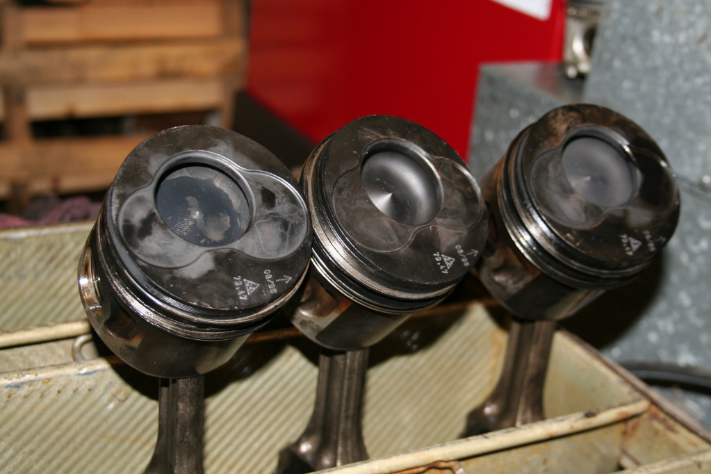

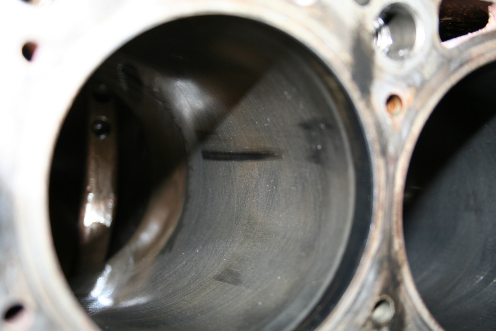

Old Oct 11, 2012 | 04:53 PM
  #58
Hardstripe's Avatar
Posts: 124
From: spokane, wa

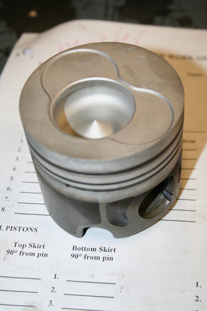

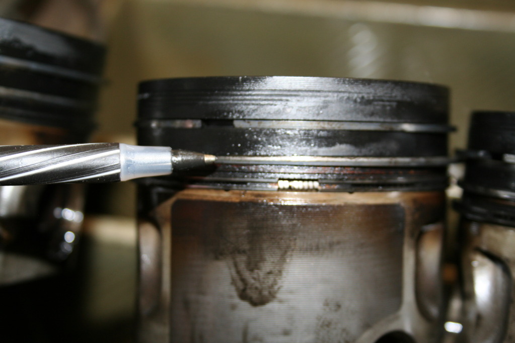

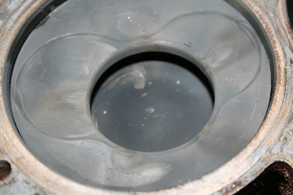

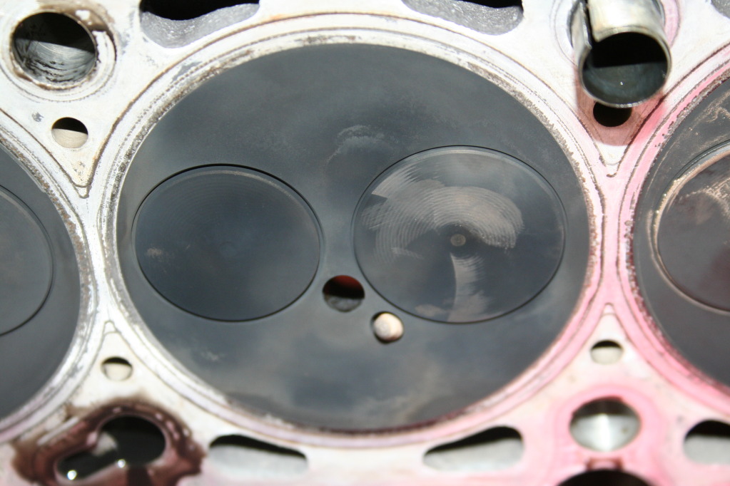

Well it is a good thing I decided to reman this engine! Took off the valve cover, and everything looked shiney and new as expected (new cam and buckets), then removed the head-
looks like the guy I paid to do my head gasket set up my timing incorrectly, the valves have made contact with the pistons. I cant wait to see what the valves look like when I take apart the head, but the pistons look fine at this point. I did however notice some carbon buildup on the cylindar wall that worried me a bit.

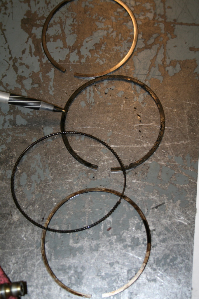

Pulled out the pistons, here you can clearly see the carbon
For the most part the pistons passed the initial visual inspection except three of them had a stuck lower compression ring! heh I wonder how long this engine would have lasted like that....

Had enough time to clean up one piston before school got out- looks perdy. I am pricing out a set of rings... better start a parts list!
