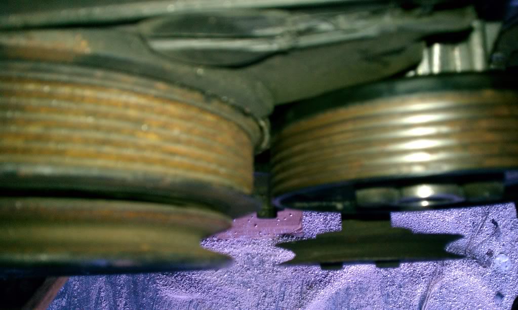

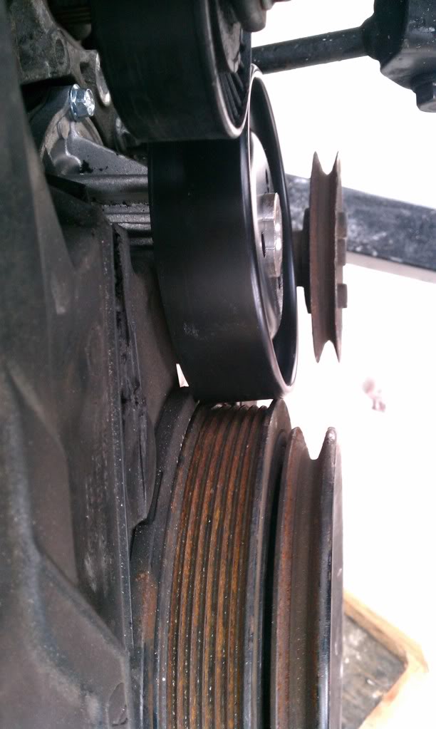

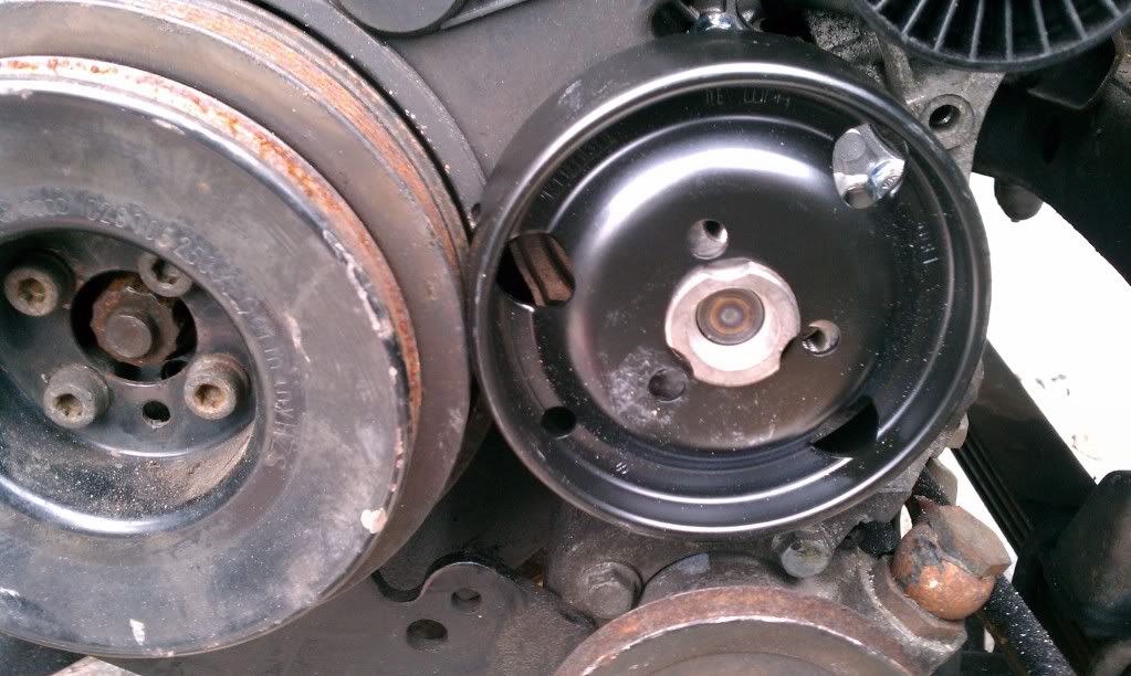

This particular pulley is the wrong one.. before this thread is finished ill be making a list of parts and parts numbers to reflect the correct parts.
Heres the correct one

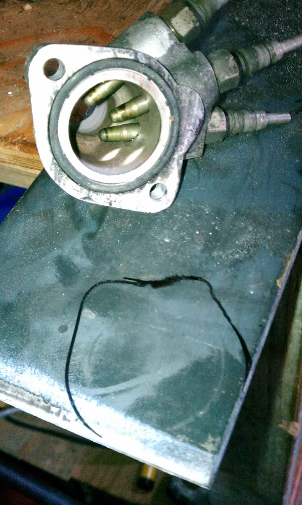

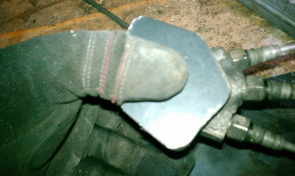

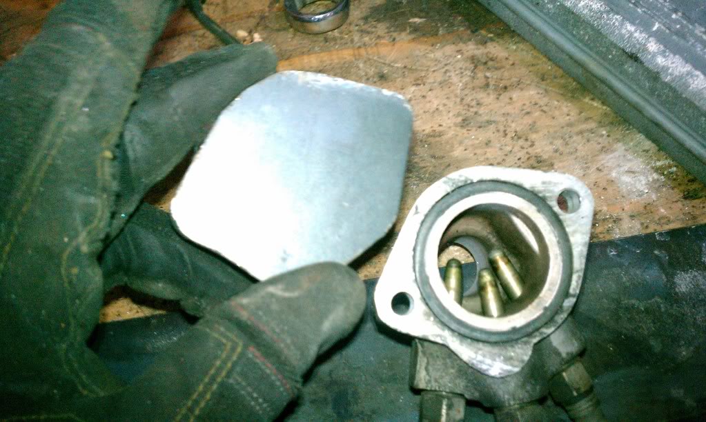

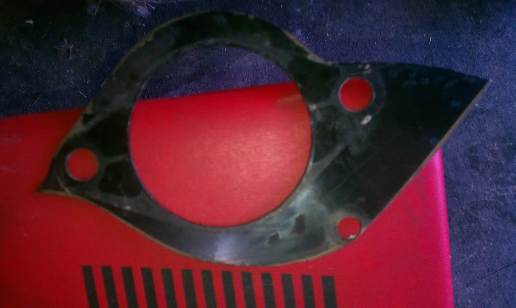

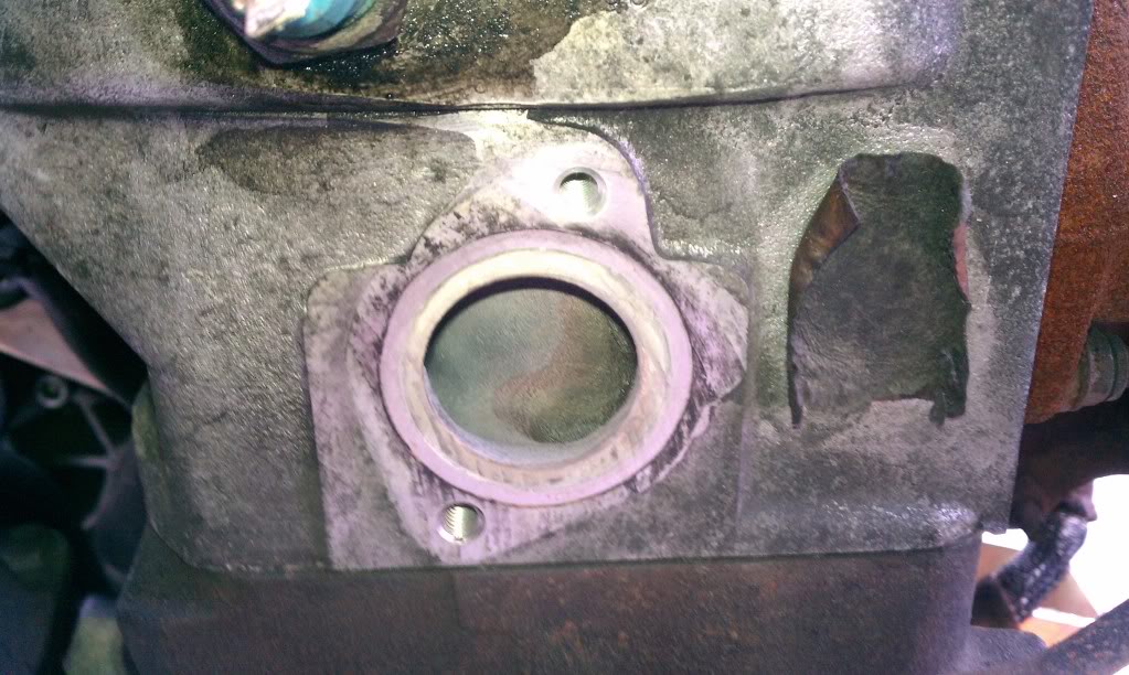

This was a glowplug port for the radiator line. It took up too much space and inhibited me from using the stock transfer case crossmember, and from what I can gather its un-necessary so I am deleting it.

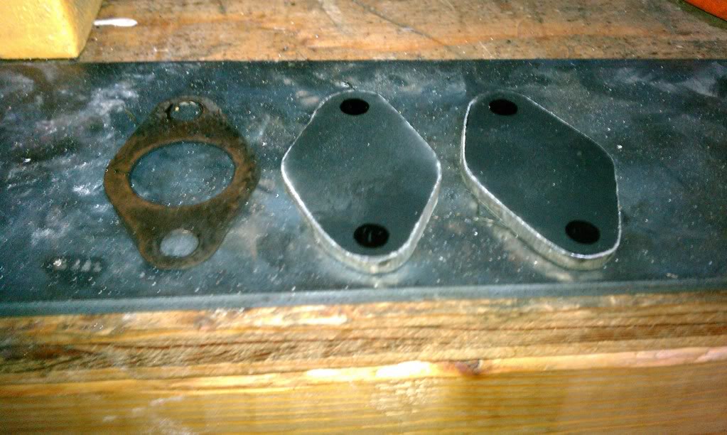

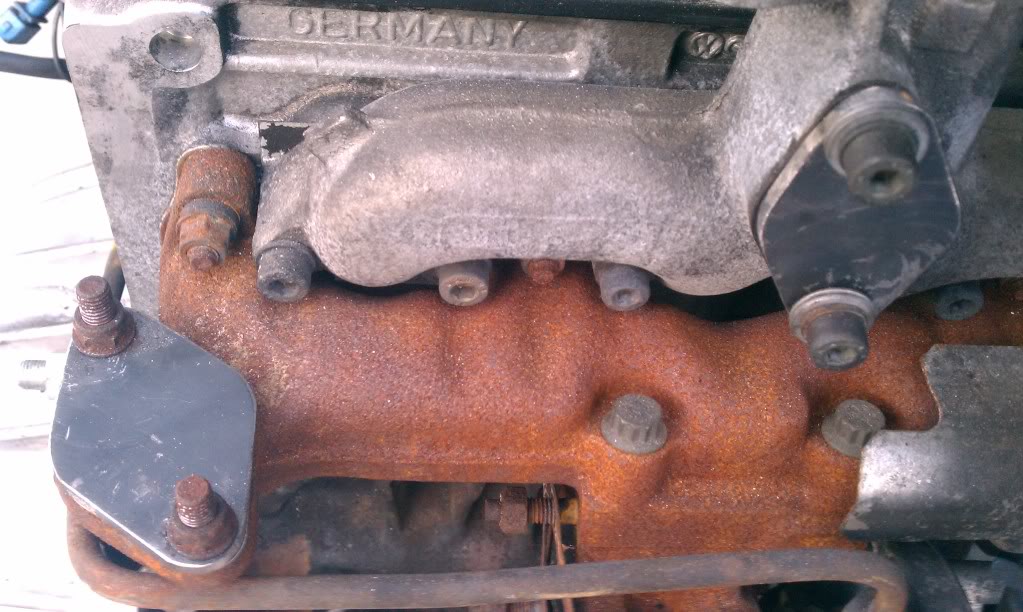

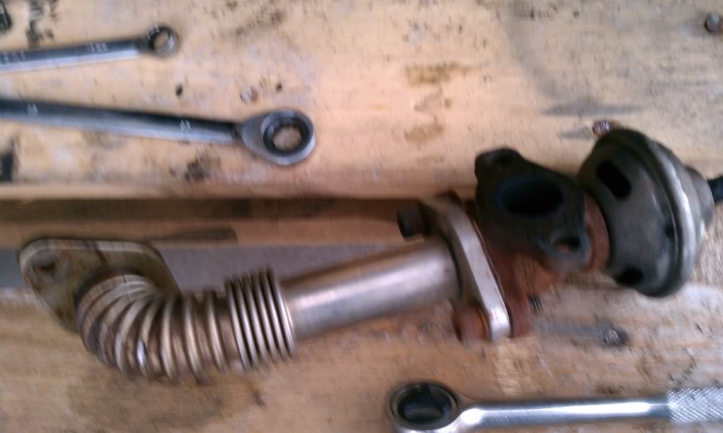

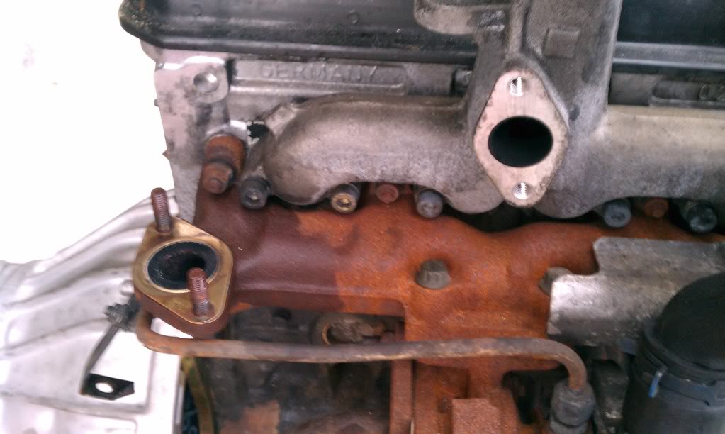

got rid of the egr too

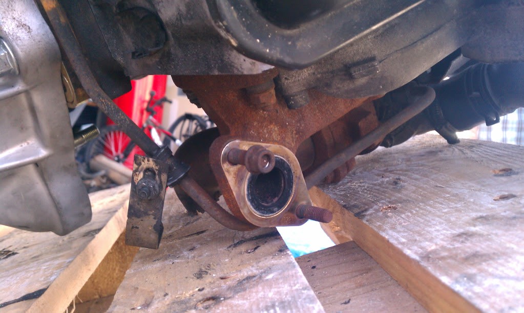

Hah I was bolting my new egr covers on and dropped a bolt into the exhaust, had to tip the engine over and fish it out with a magnet
all bolted on

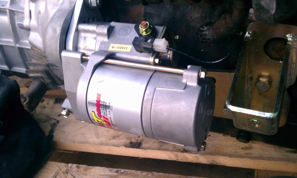

New gear reduction starter and spacer cut from the original toyota spacer

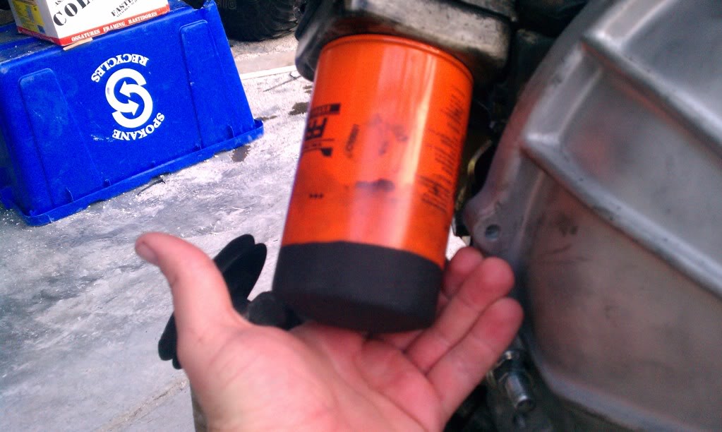

couldnt use the stock oil filter, had to get a skinner one so that it would clear the transmission

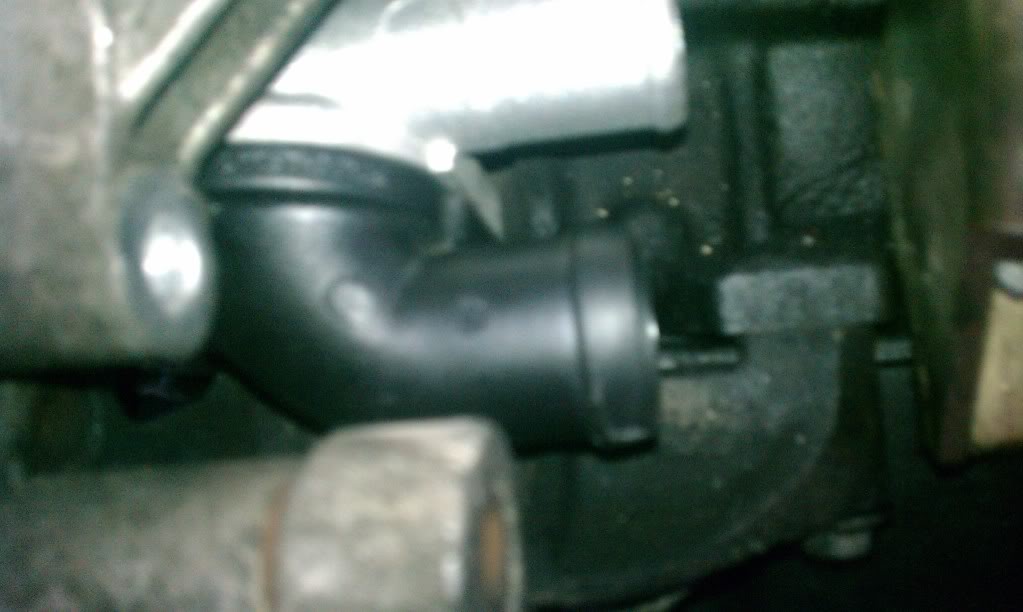

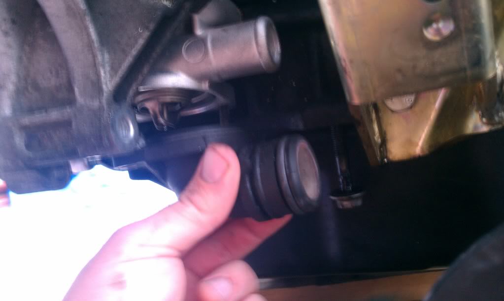

This radiator fluid hose coming out of the bottom of the water pump would not fit with the new motor mounts and needed to be replaced with an older version that uses a soft elbow
I can attach a soft hose onto this one with a bend so I can clear the motot mount

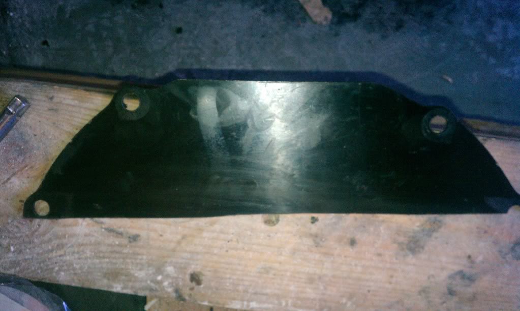

Here is the cover for the underside of the transmission, cut from the original toyota spacer. I wish I had the foresight to make the tdc mark on the flywheel align somewhere down here... next time I take the engine out I will be transfering it.

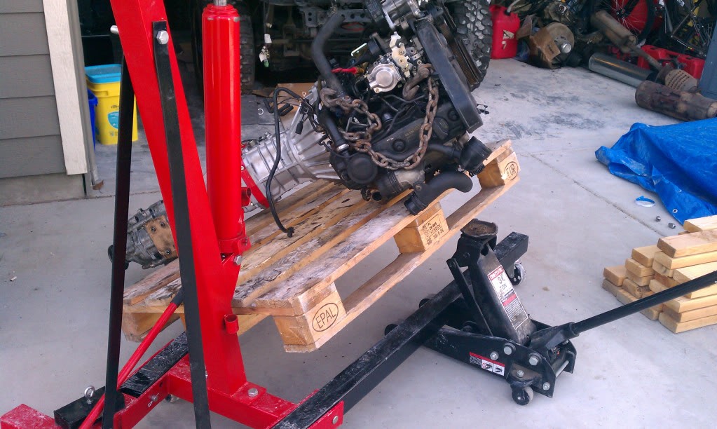

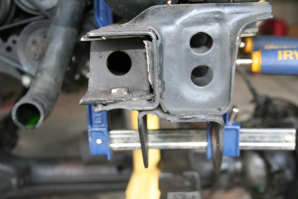

I have the motor mounts all fabbed up, burned on. The motor is in place, but there is a clearance issue with the steering arm and the alternator. I will be putting a u-joint into the steering arm so that it will clear. I still need to setup the radiator, intercooler, throttle cable, new injectors, re-time the injector pump, and run the fuel lines. I have just about every part I need sitting here, time to get busy so I can bring this baby to Naches.
all bolted on

Hey man great build, just wondering where you sourced your starter from? Im looking for a clockable one and that looks like it fits the bill.

I got my starter from acme, you can see it on his website.

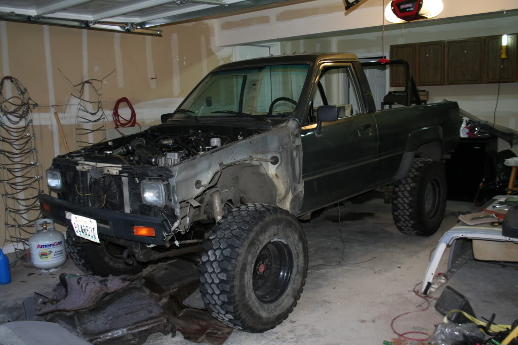

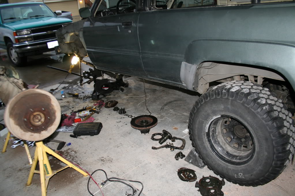

Here I am stripping the truck down for the major overhaul

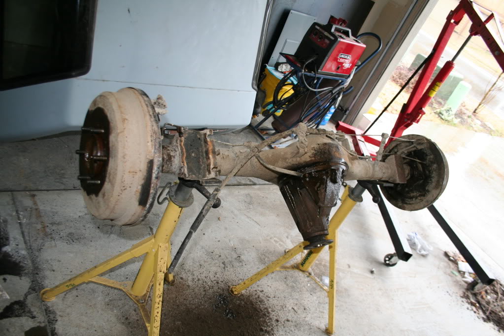

my new full width rear axle
rebuilding the front axle

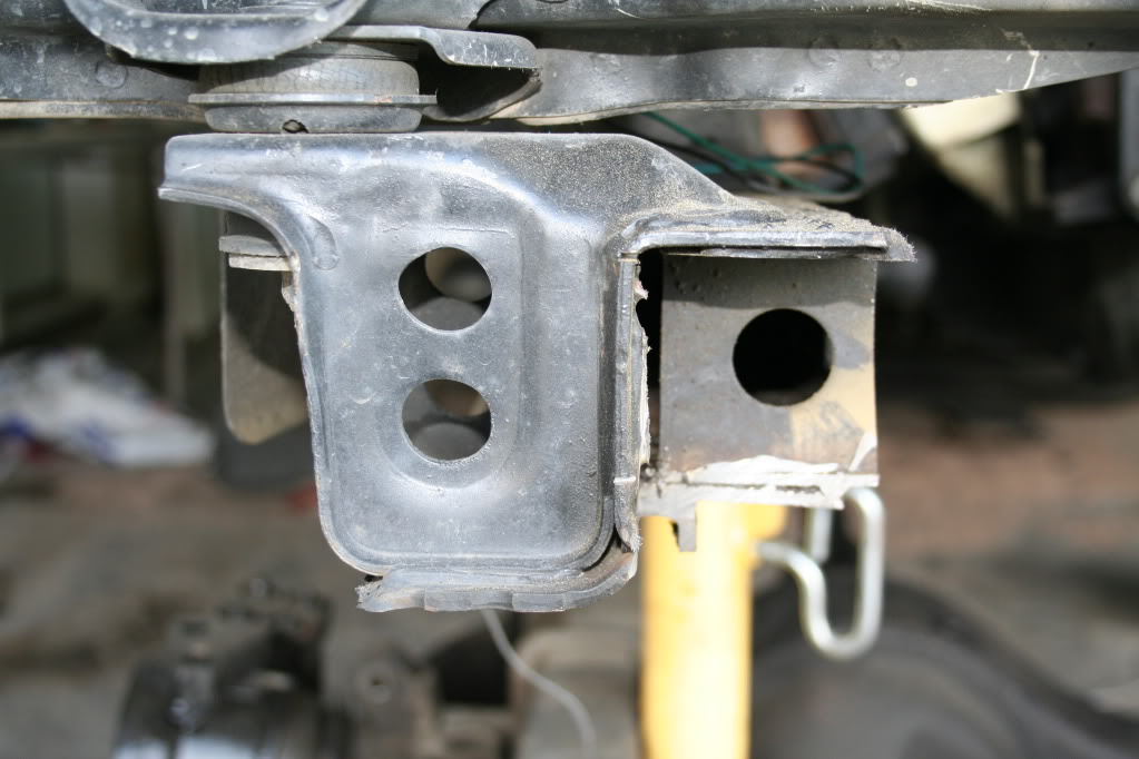

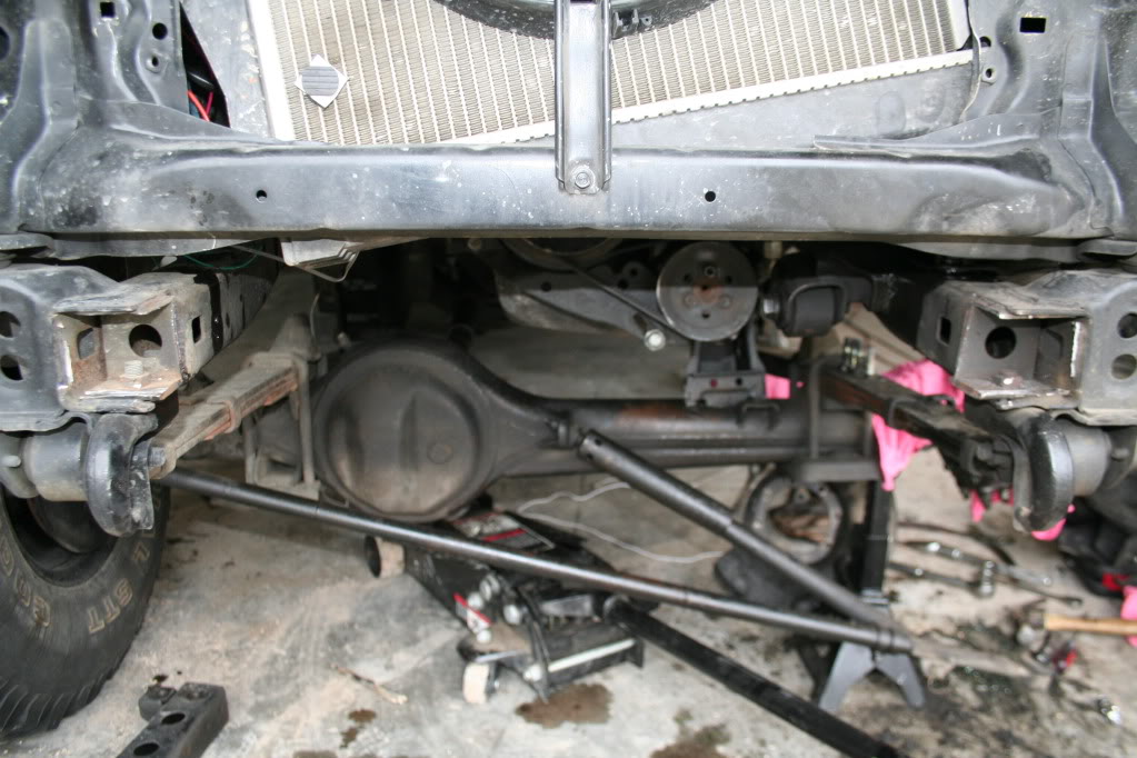

cut out the front crossmember- it was weak and bent, and I needed extra room for my new histeer

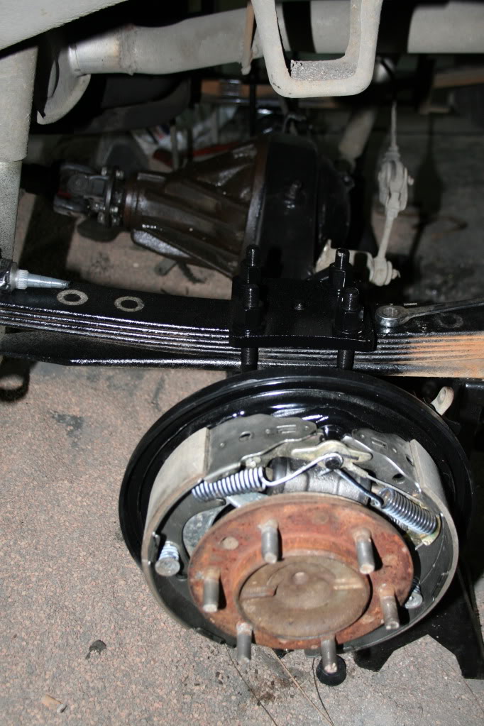

rebuilt rear axle from hub to hub, props to Jeff from Suncrest Auto Parts for finding me the goods and having the backing plate sandblasted/painted
cleaned up the frame for the new crossmember
welded nuts into the crossmember so I can later mount a bumper
all welded on and painted

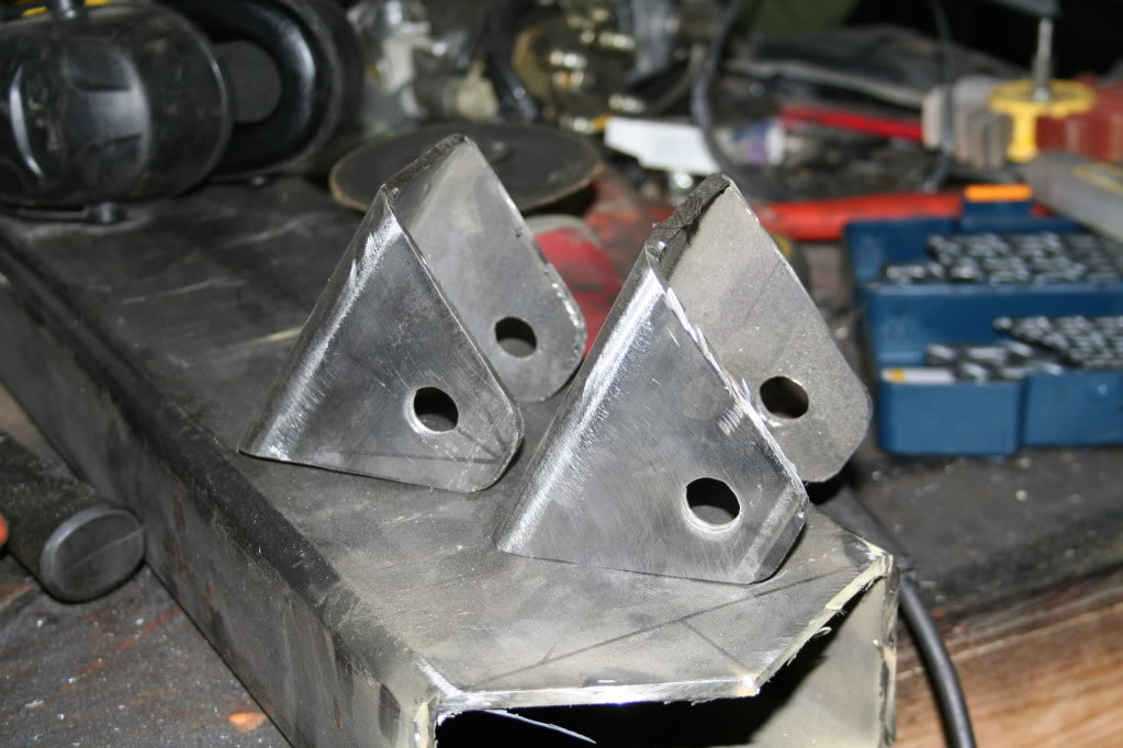

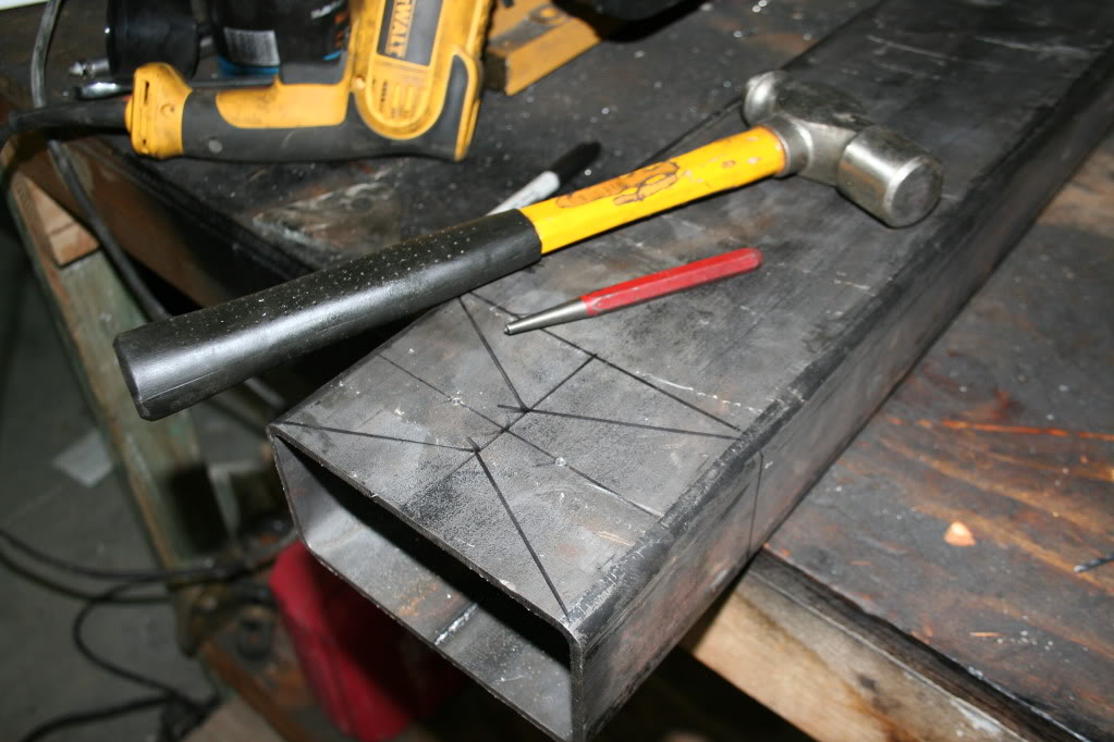

cutting new hangers
I actually have the hangers on now, with the springs attached- trying to work out the crossover steering but running into some clearance issues. Ill need to have a piece of tube bent to give more clearance between the engine during articulation. Ill post more pics soon- hoping to have this thing on its wheels, steering, and braking soon.

cutting new hangers

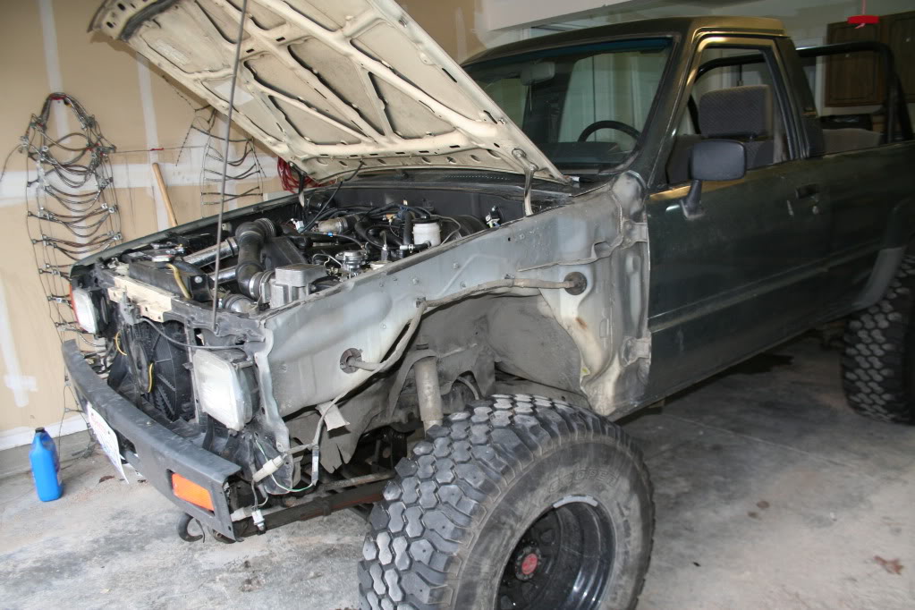

Hey, nice looking tire cables on the wall. Where'd they come from?
#38
I dont remember where I bought those- some parts store. Yea, I have plenty of project left haha, I just hope I finish it by winter or the ol lady is gonna be pissed she cant park in the garage for a 6th year since i bought the house.

Im looking through and I see you had some clearance issues with your coolant GP flange. If i am correct this is now blocked off?
I read in one of the TDiclub toyota swaps the guy was planning on doing the same until somebody stopped him and said NOOO no no. Apparently that takes heat directly from the head and puts it into the heater core and it is ESSENTIAL.
