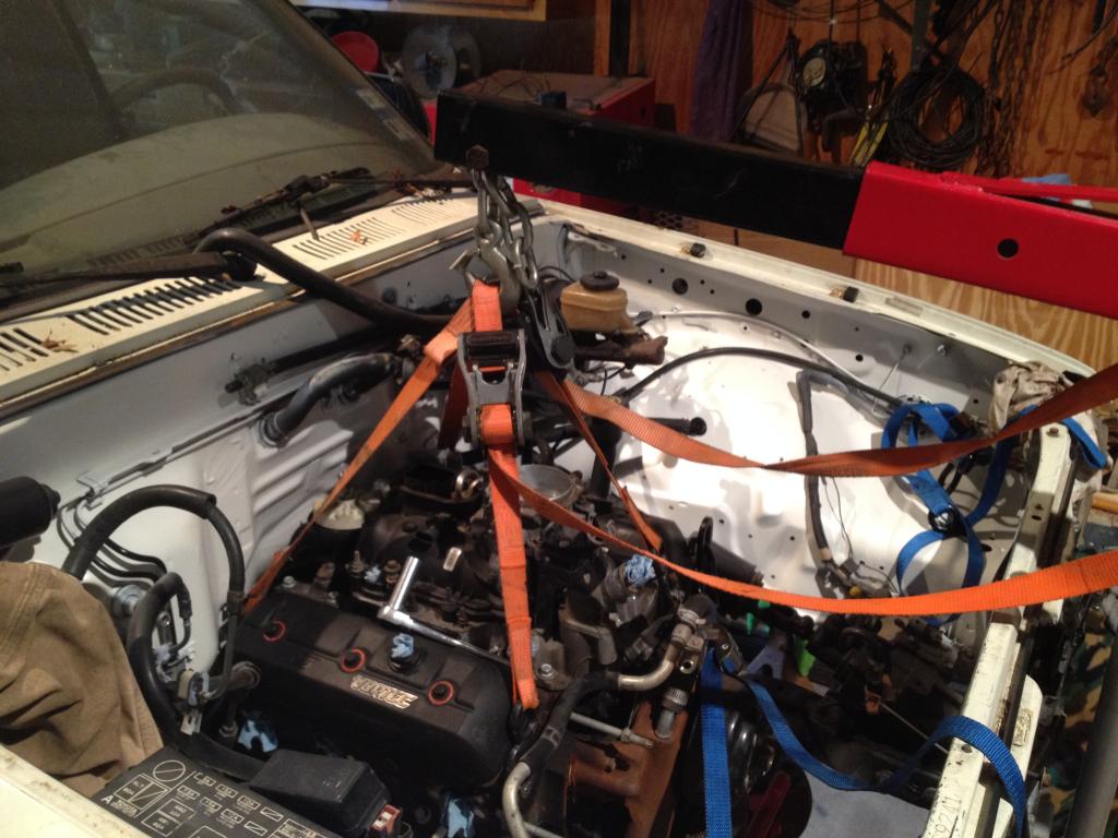

im doing a 98 4.3 swap in a 95 4runner and would love to see some pics. of what had to be done and how it sits. As bad as I hate to say it im using the hei dist. so everything is going to be close to the radiator soI can run propane.Im going to run 2 electric fans and would like to see some set ups like this or something simular.

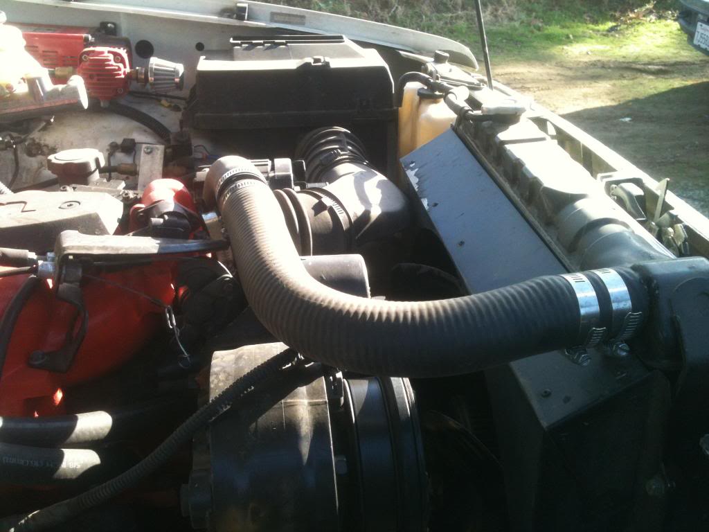

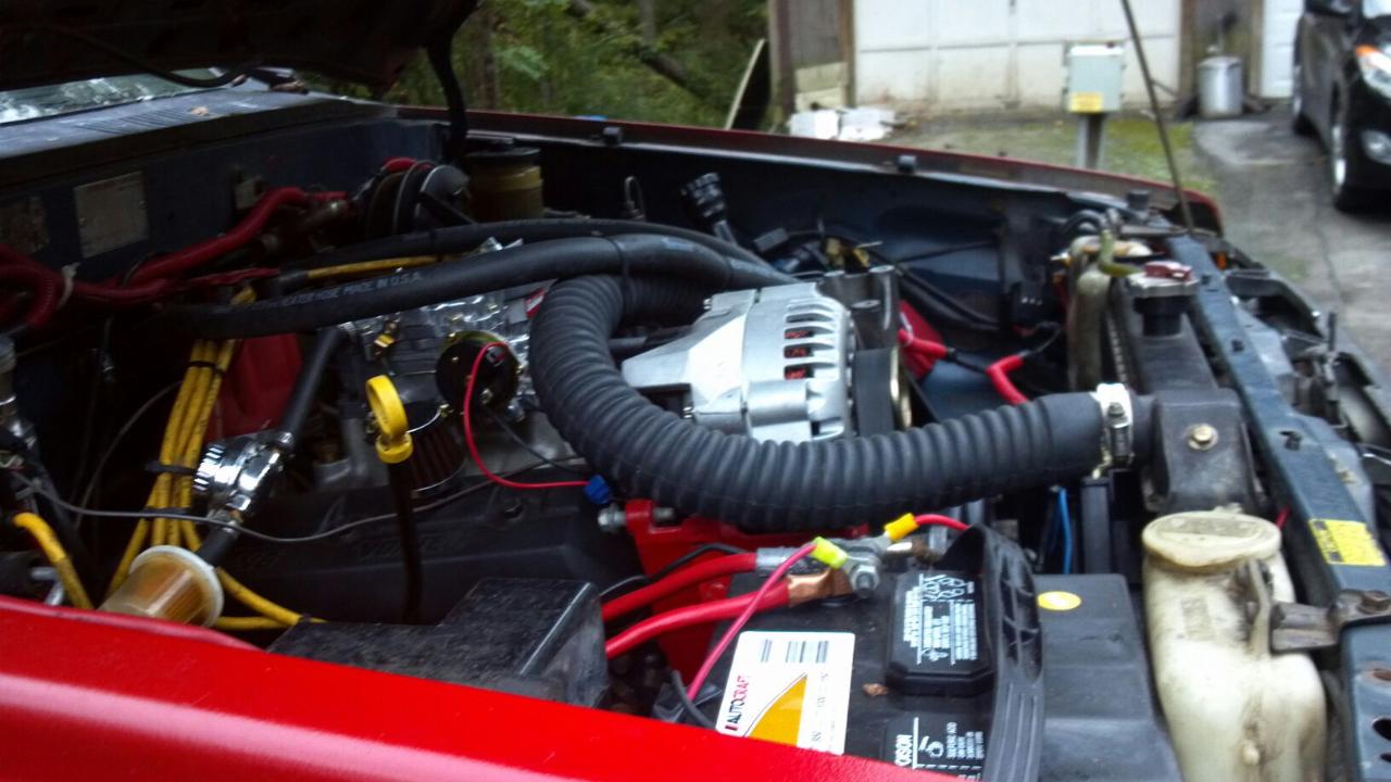

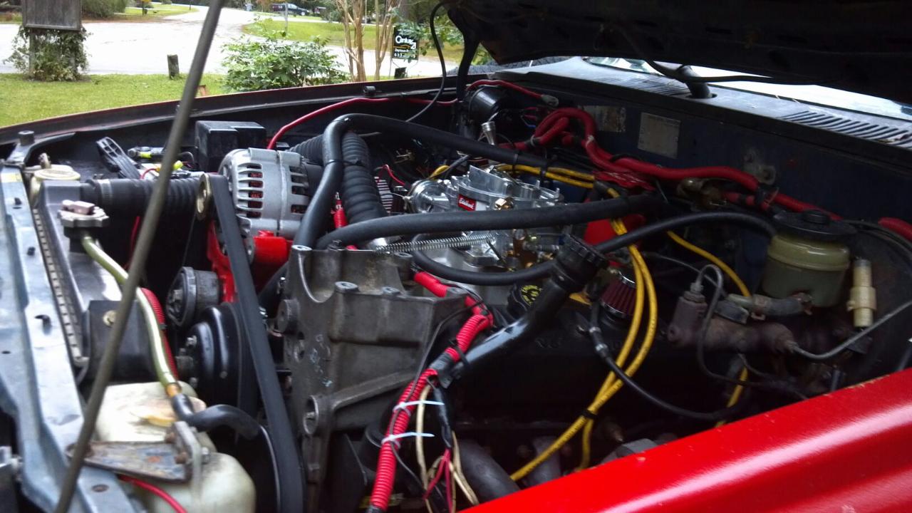

few pics of my 4.3l swap
I did a swap with the 4.3 its tight its a 96 vortec switched to carb I would stay efi if you want to deal with the wiring I have shorty block huger headers edelbrock carb msd ignition msd distributor edelbrock intake ect for engine. 700r4 with adapter from advance adapters for the Toyota t-case to attach to 700r4 lokar floor shifter ect. hope this helps a little

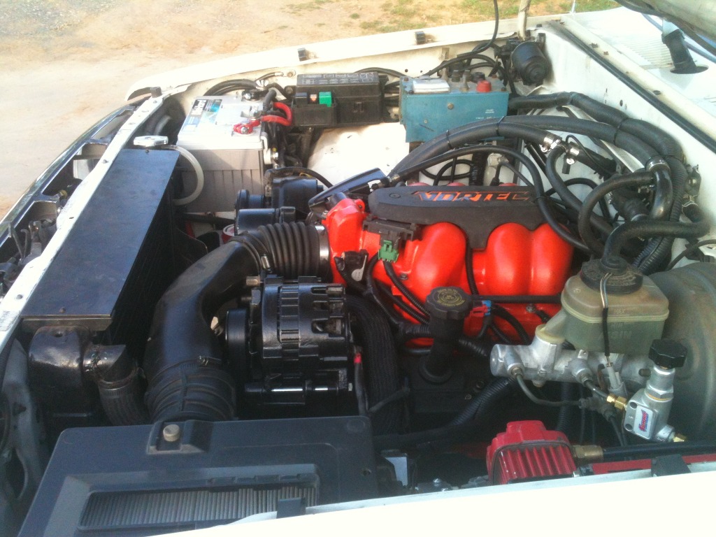

Hey I did a 4.3 swap in my 88 yota it is carbureted and runs off propane. Here is a picture of what it looks like.

how is yours sitting so low in the engine bay?? Gabef88yota
Old Jun 11, 2014 | 12:48 PM
Gabef88yota's Avatar
Joined: Apr 2014
Posts: 2
4.3swap.
What motor mounts are you going to use? And I also have a Chevy tranny ant case. I also have a 2'' body lift so that might be what you see.?

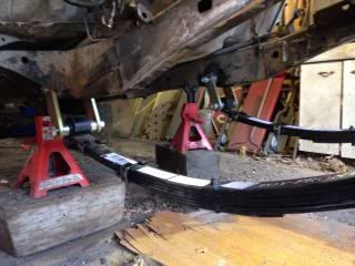

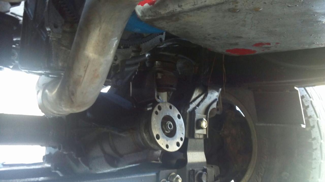

The 2" body lift makes it look like its sitting lower.Im in the process of doing a 95 4.3 mpi in my 87 truck thats getting sas'd now. Im waiting to finish the sas before i start the swap. Im staying fuel injected and keeping the engine stock as possible. I have a advance adapters bellhousing and fj40 slave with a centerforce clutch and flywheel also from advanced. I bought this 95 jimmy as my donor which i drove home so that way im the one doing the dismantling not some wire choppin fool.
heres the sas. Should have plenty of clearance for the vortec!

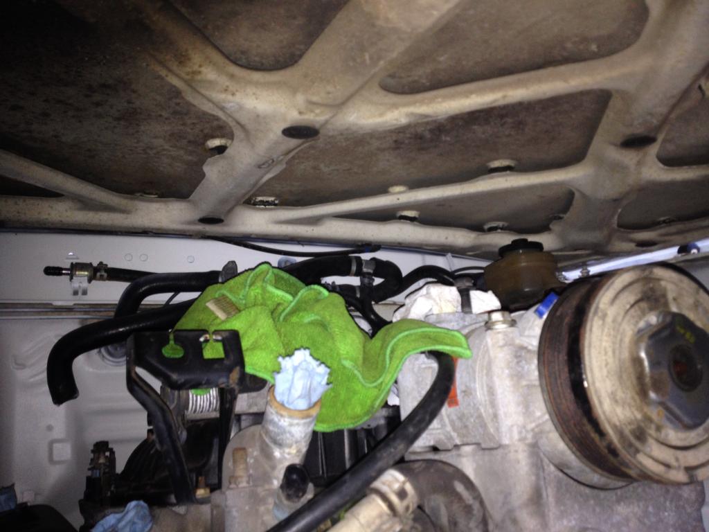

This is what I got to work with I'm just trying to get it back on the road and reliable
