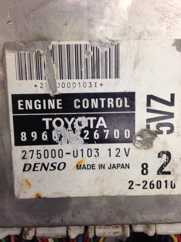

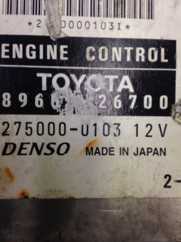

It's a shot in the dark, but could you post the part number (with an X for the unknown number), or a picture of the ECU?
Is there a part number tag on the engine harness still?
The other thing to try, is that I've heard that there's a VIN tag on the motor somewhere behind the timing cover, that could prove useful.
Old May 29, 2014 | 01:57 PM
Yotav6power91's Avatar
Joined: May 2014
Posts: 22
Ecu 8966xx26700. I'm taking the timing cover off now to see what's behind there

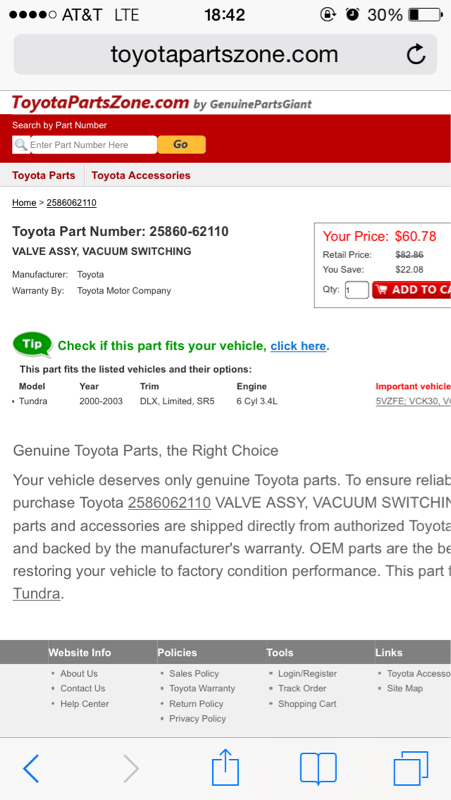

This is what I got when I search this part number

So based on the part numbers for the ECUs I was looking at for my swap, it looks like you're only missing one number, 1, which would give you a part number of:
89661-26700
Looking around online for that part number, it looks like it's from a 2000 2wd Van that doesn't look like it was offered in the US.
Does this look the same as yours?
http://www.ebay.com/itm/00-TOYOTA-GR...-/370803491119
If it is, you may have a mess on your hands.
