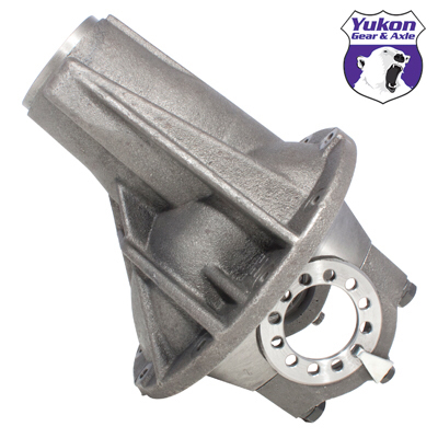

I feel like I'm crazy here but is that a high opinion diff installed upside down? It looks to me that you have a mini truck axle with an 8" high pinion installed like a low pinion.

Your crazy or maybe drunk? You couldn't flip a high pinion diff, or any diff for that matter unless you can figure out how to make the front driveline rotate the opposite direction. Your front tires would spin backwards. Dont feel too bad, I thought I had this genius idea too, flip a diff to make it a high pinion. I presented my idea to the legendary ZUK where apon he schooled me on basic physics. One of those "oh duh" moments.

Dude i realize that completely but look closer at the picture it looks wrong. And he says it needs a new locker and gear set. I have never seen a diff hang lower than the housing like that. And I can't find a comparable housing that looks like that in a low pinion. I know how this stuff works I have gear swapped myself to 4.88s.

I'm pretty sure the bottom of the housing has been "clearanced". I know why the front diff is bad. My axles and all that when in and out just fine multiple times too. Its definitely a 9.5" R&P as well. I just wasn't sure which model FJ it was. Guess ill never know haha

that's what I was gonna say, someone really really really wanted another 1/4 inch of ground clearance! I would weld some flat bar on there to at least make it flush with the flange, catch that lip on a rock and its gonna crack and leak, and most likely be junk at that point. Youd have to weld cast iron which is always tricky, then machine the flange face flush. Prob cheaper to buy a new diff at that point.
