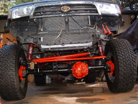

i have a d44 in the front of my 97 4 runner and it is a 1979 waggy drivers side drop and i love it........I also have a ff D60 in the rear
