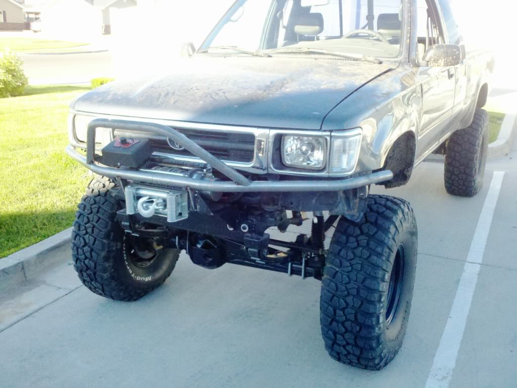

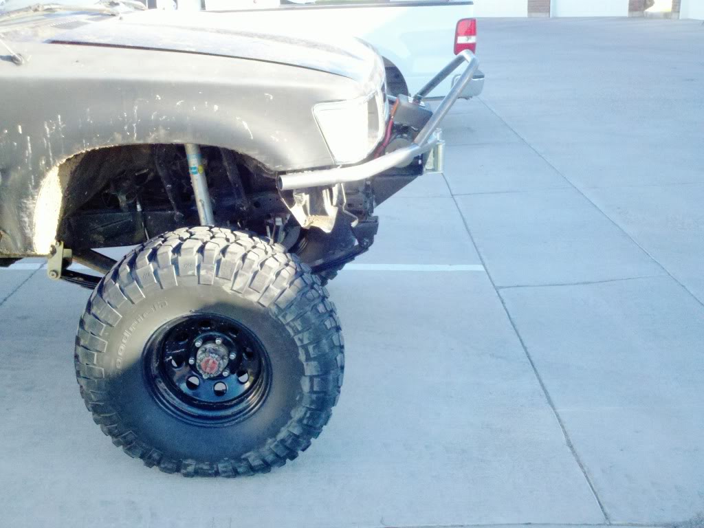

Bumper that a buddy and I made. Had access to a jd2 bender for a little while. Used a trail gear winch plate.

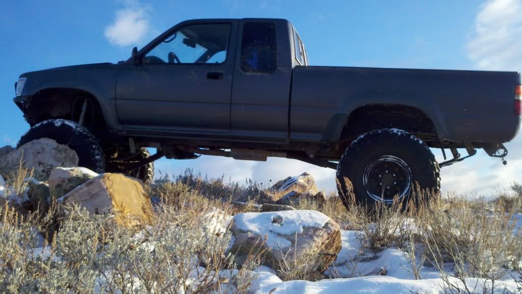

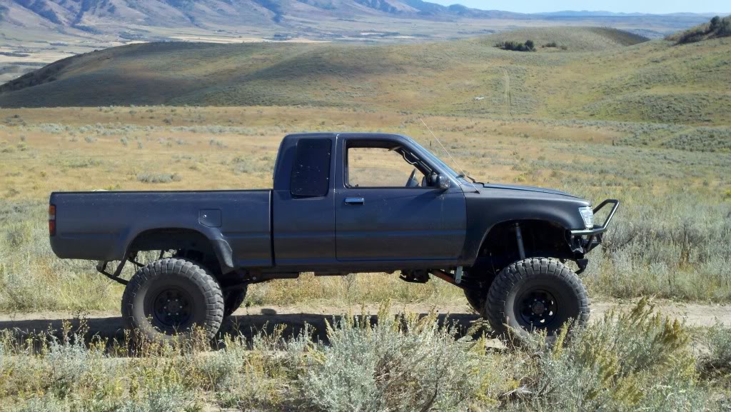

this summer in idaho

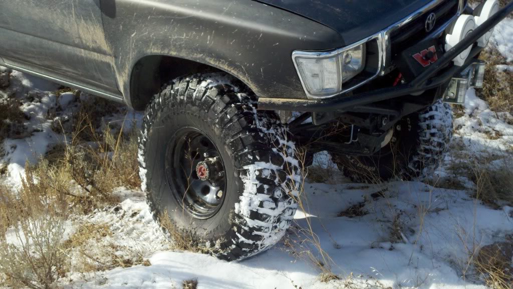

this is on the bump stop in the fron, I def need to get those 37's

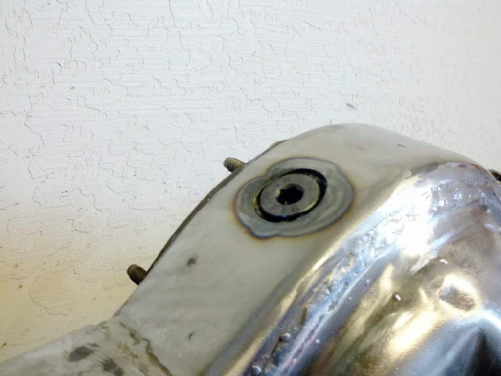

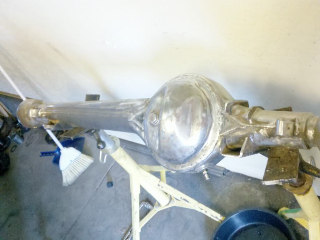

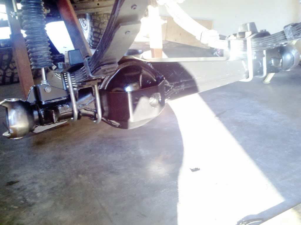

flushed in drain plug and trail gear front diff cover

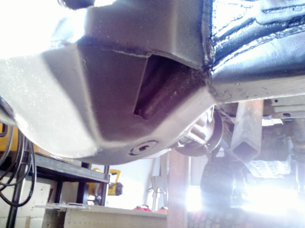

I cut down the pass side mount on the under side of the housing

I have the same truck. 92 ex cab, 3.4 swap, 5 speed, dual cases 2.8/4.7 and have just about everything now for the SAS. I will be using the 4" HD springs and wondering your thoughts about the hanger. I have the Marlin hanger and have always heard to mount it 1/2 up with the 4" springs. You said that didn't work for you and mounted it flush.
My question is, after you changed to the HD springs, any ill effects of having it flush? You angles look good but I don't know what springs you have on in each picture.
Thanks
This picture has the hd springs installed on the truck. I think that the hd springs and the regular springs are the same length, although I never measured. With that said, once my regular springs broke in, the shackle angle was a little more kicked back from where it is now, which I thought was better. I think the hd springs will come down a little more but I probably won't notice it.
I don't know if the marlin hanger is the same as the trail gear hanger, I assume they are very similar, but I think i would still flush it up in the front, and maybe look into sliding the frame tube jigs as far forward as you can get them instead of centering them, to get a little more shackle angle.
If it would help I could measure the distance from the center of the front hanger bolt to the center of the frame tube jig, this way it would not matter if the hangers were the same or not. Just a thought.
