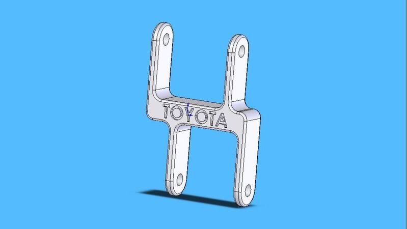

Well I kind of want to make a lot of the stuff on my SAS myself just because.... So I was wondering if you guys think this shackle will work for the rear of the front leaves? I think it is going to hit the frame when it starts to flex a good bit.... It is offset because i'm going with a chevrolet front axle and the spring perches are 31.5" wide. Let me know what you think, i'm trying to improve these things as much as possible before I cut steel. I'm a beginner Shackle builder/SAS guy so don't flame me too much if some of my stuff looks insane.

Oh yea and to give you an idea of how big those are the distance from eye to eye is 5.75".
