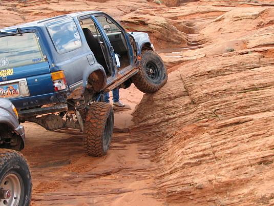

Keep in mind that when doing a sas kit, 4"s is more like 6". so 6" springs plus spring hanger and a 6" shackle. You will be closer to something like 8-9" or whatever. I did a 3" kit on my runner and go about 5"s of lift. I had to lift the rear about 5 and half to match.
I also could run 35x12.50 no problem with that set up. I currently run 33x12.50's right now.
