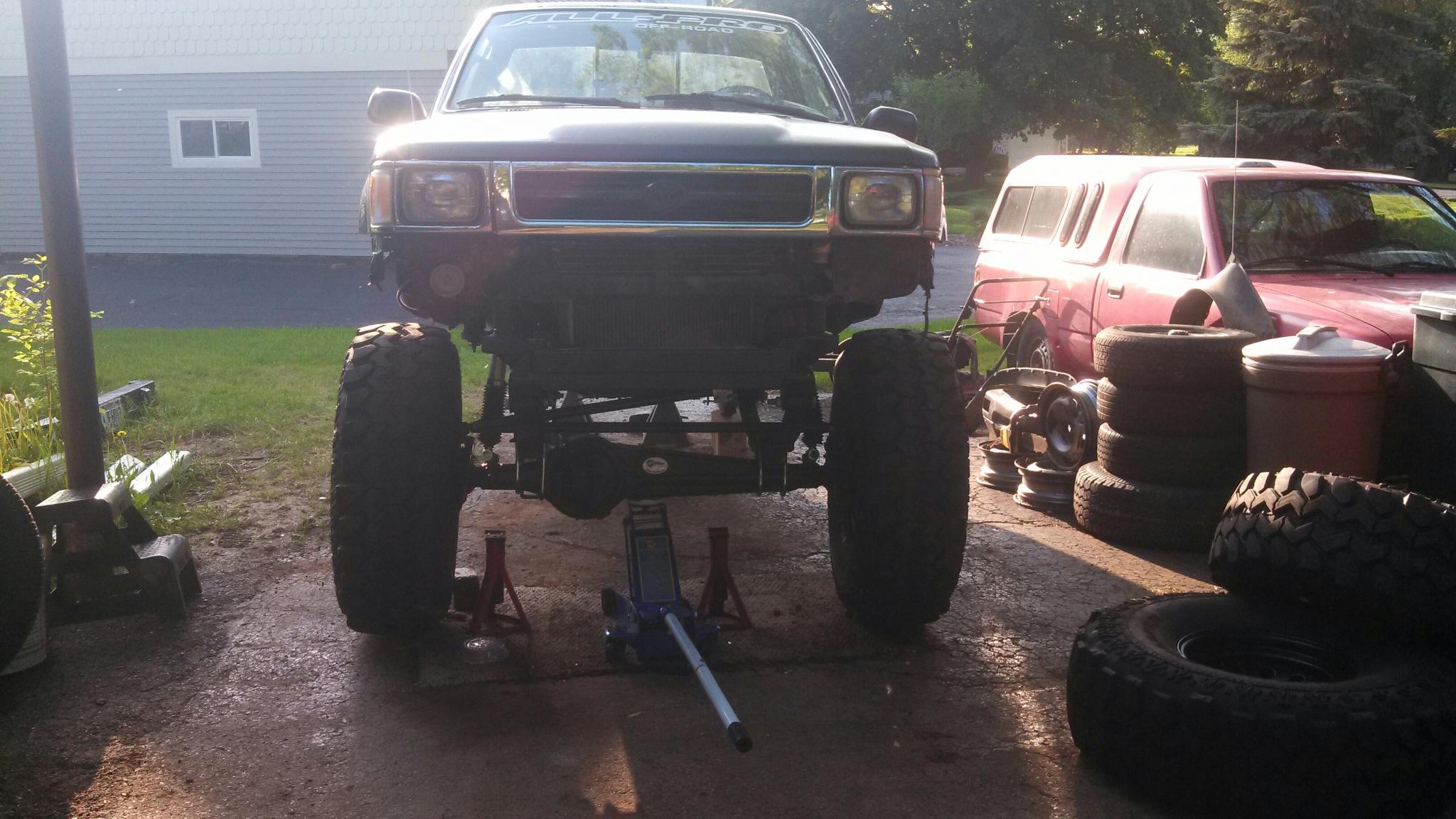

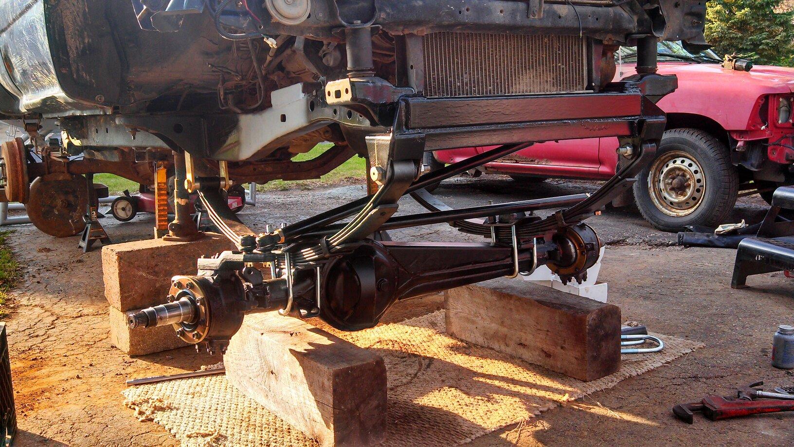

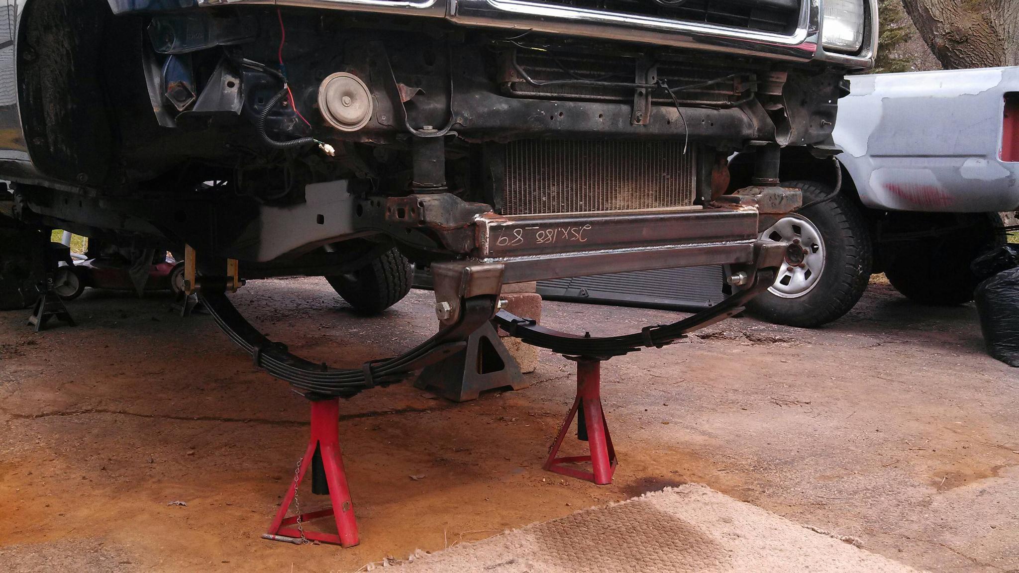

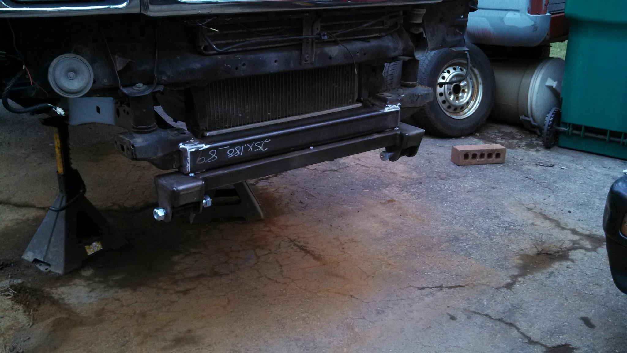

some of the progress. the pictures with the front hanger tacked 3/4" forward aren't where the hanger is now. ended up welding it flush with my homeade frame crossmember... stock one was bent.. when the hanger was at 34" forward the shackle angle was way vertical.. but as of today the front is pretty much done, axle is bolted in, steering on, shock hoops welded shocks in, brakes, new bearings, and lockouts are on. all i need to do is throw some more paint on it and the wheel spacers and the front is done. along with a front driveline... then onto the rear---63" chevies

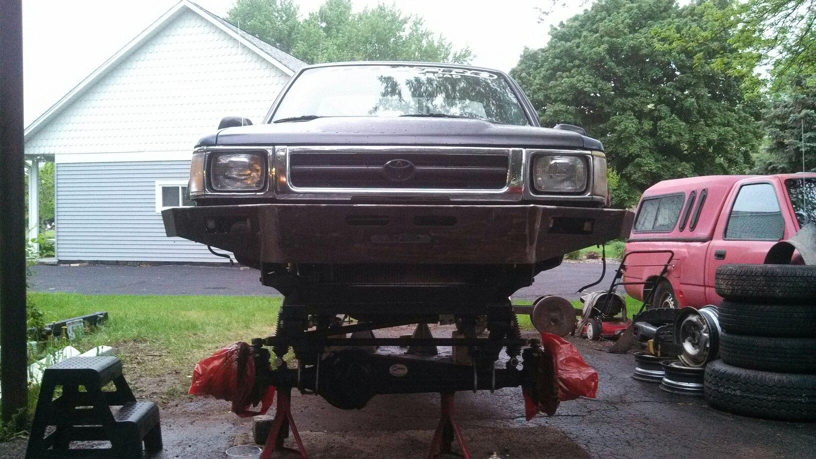

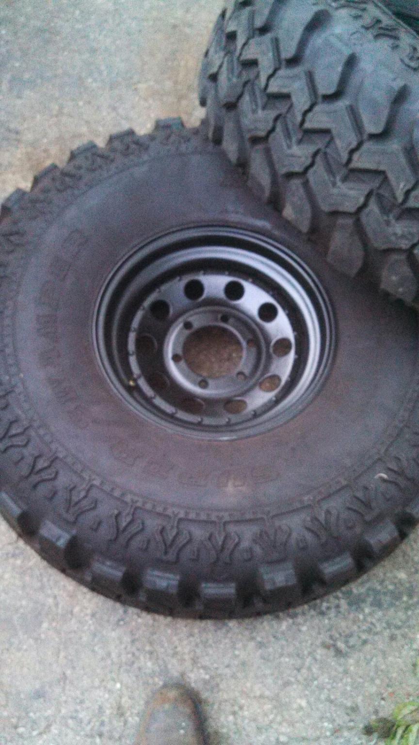

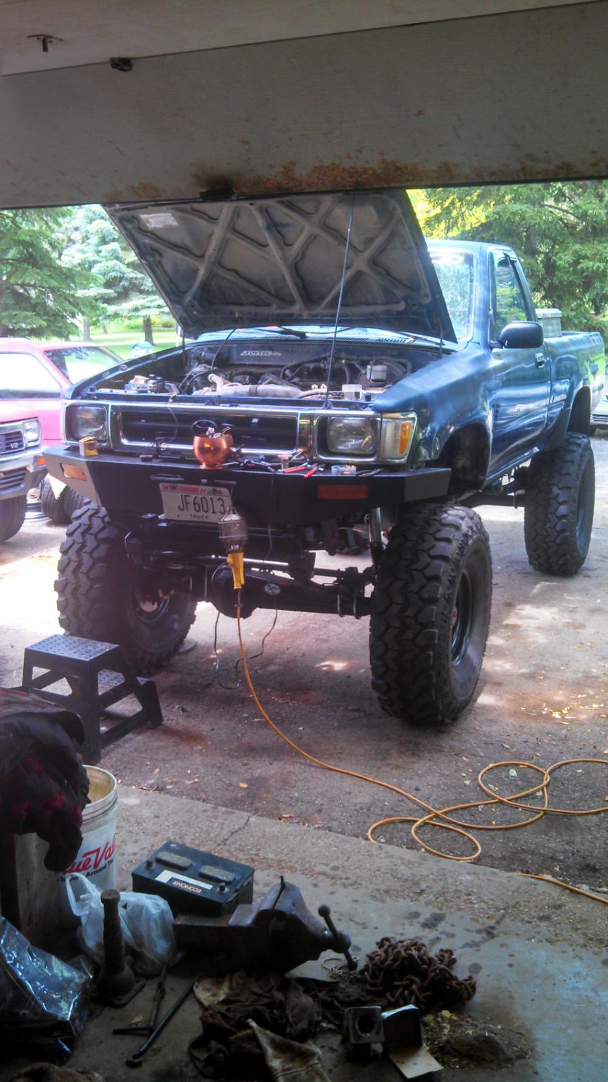

Picked up some 37x12.50x15 Super Swamper SSR's for cheap like new tread and mounted them on some freshly painted steelies I had. got the front on for a mock up stance as well. Also I am just about done with my front bumper

I think Its a tad too tall for my liking so I'm thinking I'm going to drop the body lift completely or lower it to a 1.5" body, we shall see. coming along nicely though. Should be rolling by this weekend. just got my rear diff back and already bolted it in my housing so then I can mount my rear axle and do some other odds and ends and shes done

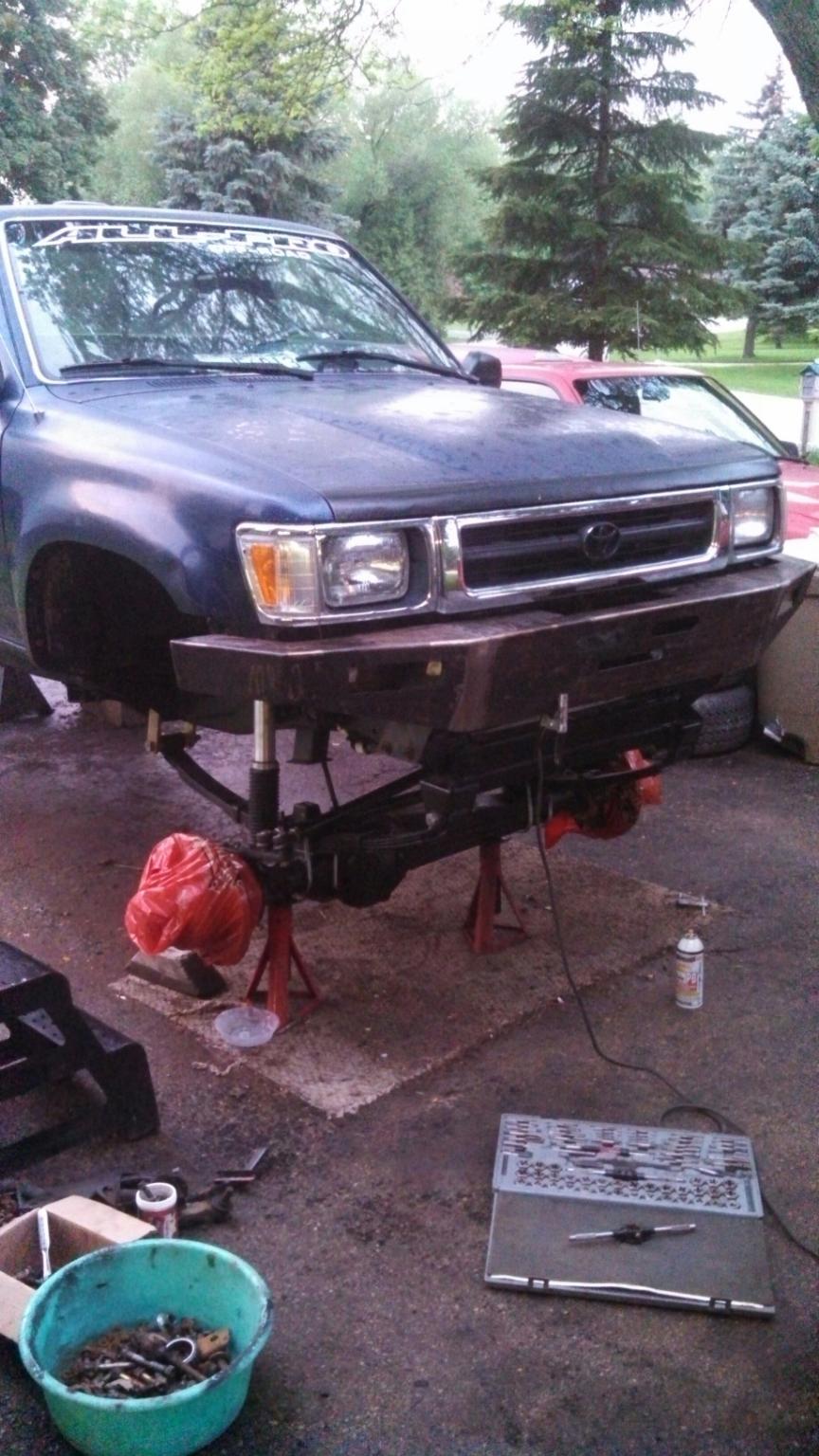

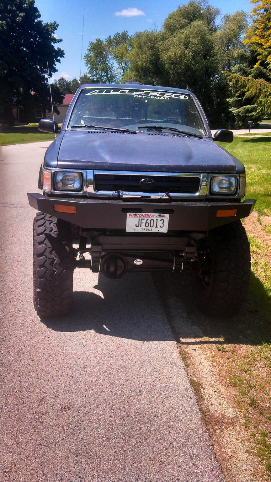

nother picture of my front plate bumper I built

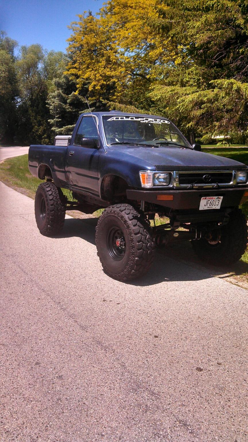

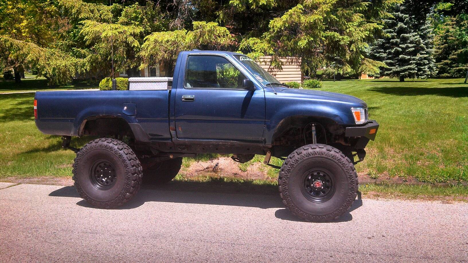

Some more pictures of the truck running and driving and SAS done. Already put 75 miles on it since yesterday and I'm very pleased! tracks straight as an arrow, absolutely no bumpsteer, and no vibrations even up to highway speeds!

If anyone wants more specific specs or questions let me know but its a 4" TG SAS springs up front, trussed axle, 5.29s F&R, open front detroit rear, bilstein shocks, 37" SSR's, 63" chevies and a 2" block in the rear... really happy with te chevies too! flex like crazy!

Did you say you made the front part where the leaf springs hook up?
Old Jun 11, 2013 | 07:11 PM
  #54
95yoter8's Avatar
Joined: Dec 2011
Posts: 117
From: Wisconsin
Well I made a new frame crossmember. Bought the TG spring hanger. My stock front frame crossmember was dented due to me slamming into a boulder with IFS so my spring hanger wouldnt sit flush to the frame to be able to weld So I cut out the stock one and replaced it with a 3x3x3/16 beef square tube and welded it tight. lot better than stock!
