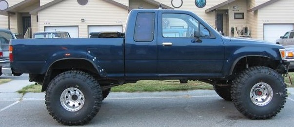

I have 3 in front springs and 4 inch rears in my PU. Running 33's. I could probably run bigger tires too.
The oil pan interferes with the crossover/hysteer. easily fixed with a 2wd oil pan. Dude this has been covered so many places. "SEARCH!"

I', at 5-6" with a dana 60. I am going to swap some leaves out soon to flatten the packs some more to get back to a flatter pack. I'll find a pic later of mine with a 2.5" drop hanger and packs that were slightly negative which gave about 3-4" lift. The key is to move a axle and steering box further forward than 1.5" (more like 2.5") if running a toy axle and high-steer. That will keep the tire rod clear of the 3vze oil pan.

Yea that a nice setup you got there. Moving the diff forward also makes for a better approach angle. One of the reasons I baught a SWB was so I could move the front axle forward without having a ton of space between the wheels. I can see this will be a long drawn out project for me lol.

That's funny Marc P... they almost look the same as well.
Mines the bigger one.
