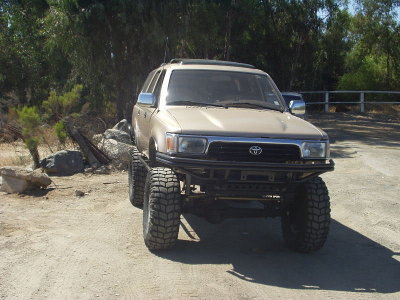

First of all AxleIke that is a sick 4Runner.

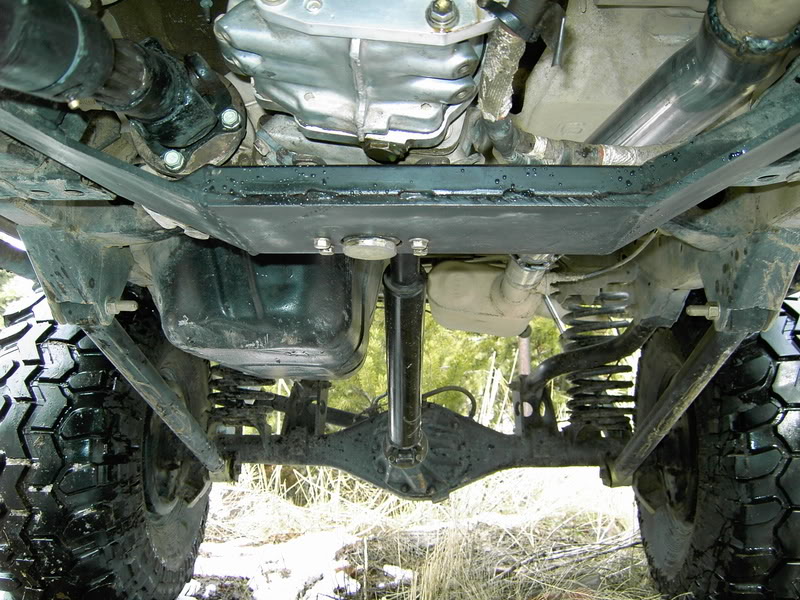

Here is a really nice looking rear link setup on a 4Runner. Looks like he was even able to keep the gas tank stock by bending the lower links:

That is a sick 4runner.....I need those links.
More info here:
Are those the stock coil buckets and like FJ80 coils? That looks like it could def work for my rear, instead of cutting all the brackets and doing the geometry...

Yes... I thought the way he did his links was very clean.
