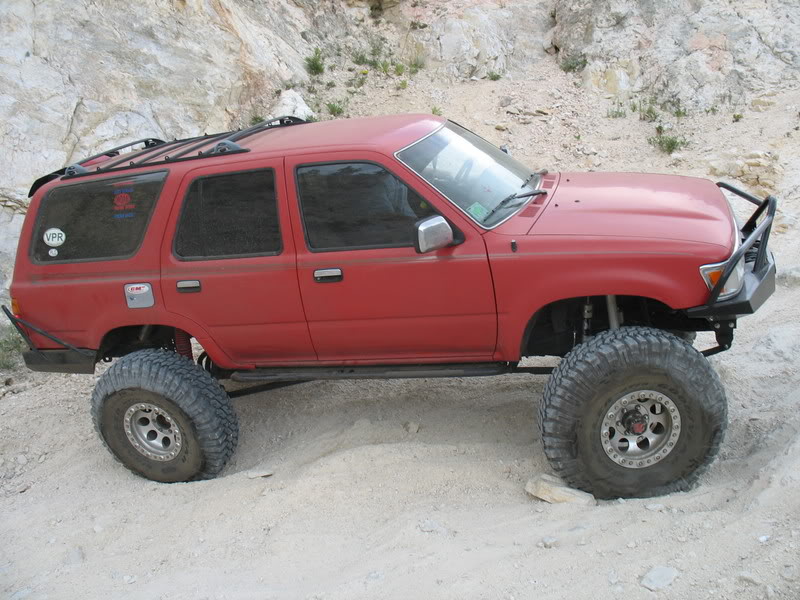

Here is another. This truck sits lower than Lysmachia's truck. Mollys has a traditional leafspring SAS, and 35's. This truck is on 37's, fully custom SAS, is on full width diamond axles, and is fully beadlocked.

67" WMS to WMS.
Those are 37x12.50 GY MT/R's. They sit almost completely outboard of the fenders. That truck is the most stable thing ever.
