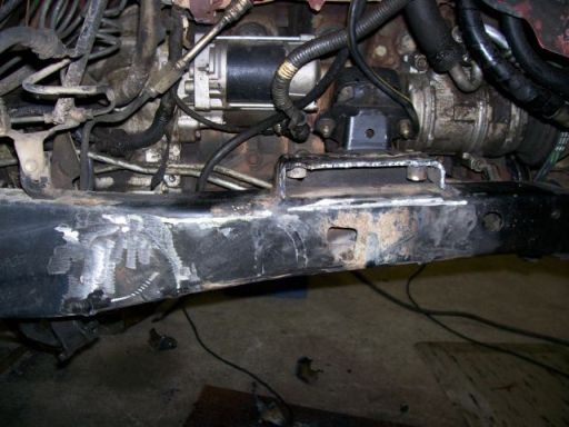

Yea well you need to leave enough for support for the motor mount too...I would cut them pretty much flush with the outside edge of the frame

As dirtytoyboy sais I cut mine flush with the frame so when you cap them with the plates supplied you get a nice flat surface with the frame rail.

We cut it to where the plate sat on the frame.how much to cut from the motor mount-toyota-sas-067.jpg
