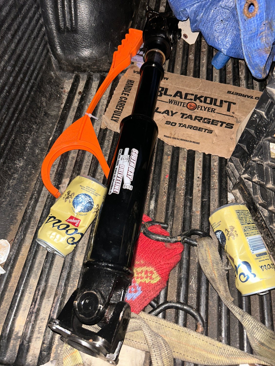

I just did a SAS on my 89 pickup, the truck drives great in 2wd. However when i put the truck in 4hi, i cant go over 15-20 mph without a violent clunking noise from the front accompanied by excessive vibration. I rebuilt the front axel myself following the manual. Everything is torqued to specs, new bearings everything is brand new. it has a welded facebook market place 4.88 v6 3rd member that didn't have excessive play and spun smooth when it was out of the truck. I jacked the truck up on all fours and had it in 4wd hubs locked, it sounds louder on the passenger side. It is a rythmic, rubbing sound, and the sound and vibration seem to get worse when im at speed and push the clutch in. it sounds almost as if the burfield is rubbing in the knuckle. The Shafts are brand new RCVs, there is plenty of grease in the knuckle and the burfs. At first i thought it was my driveshaft out of round, so I got a new driveshaft.Then I thought it could be the hub, so i rebuilt a spare hub i have and installed that. Still no change.

Sounds like u-joint angles on the fr driveshaft......also, is the driveshaft just uj's on each end or do you have a double carden on the transfercase end? If it is double carden then is it binding up? Most of the double cardens have a limited angle they can cycle thru without binding.
Pictures of the driveshaft would help. ZUK

driveshaft spins free no issue there. I just posted an edit on the initial post with the solution. Knuckle Was just incorrectly shimmed and the transfer case was making a noise that was adding to my confusion !

Pictures of the driveshaft installed with pics of uj angles at both ends. It's common to have a steep angle at the transfercase.....and that could cause a hum at 20 mph.
noise is definitely seems internal. Putting a screwdriver up to the transfer case and then my ear up to the screwdriver sounds internal. But I’ll look into it. Would definitely be a lot cheaper than new t case or duals
