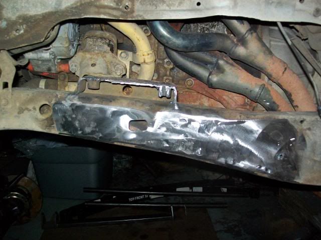

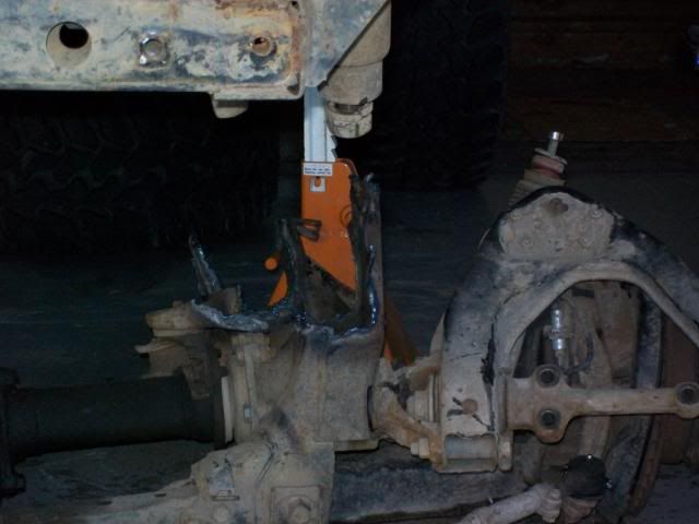

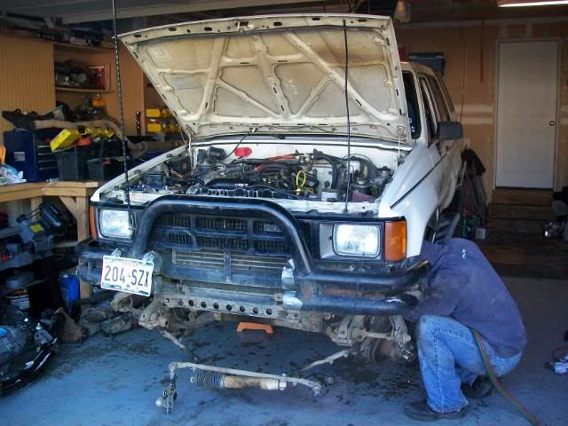

Me and a goodfriend, started the actual cutting portion of the SAS today. Been collecting parts for over a year.
Wanted to stay as low as possible so we'll see.
-FROR hanger kit
-Allpro 4" springs

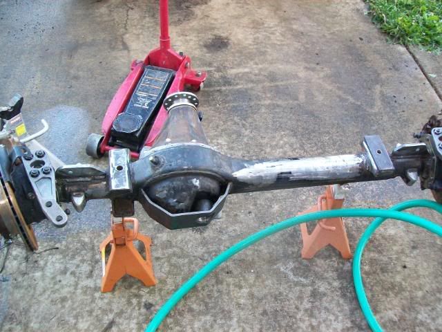

-'85 axle, 4.88 Aussie locked, with Marlin ball gusset, LC rotors, TG front diff armor, Timken/SRK bearings
-Allpro high steer
Got all the brackets ground down, most of the frame prep is done. Not to shabby for a days work. Should have axle installed tomorrow if all else continues to go well. Still waiting on parts, ordered shock hoops from Marlin. Of course they were missing some other parts of my order so won't ship them till next week. They were an impulse buy some may cvancel the hoops and go with F250 towers.

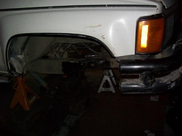

Lots of primer, will get stuff painted soon.
The rear has 4" Allpro springs as does the front so I may have to stake steps to raise the rear. I had to do this in steps put the rear springs in when I installed the dual t-case. Still had IFS and didn't want the rear really raked with 5" springs. I'm not going to do anything with it till the winch is put back on and the springs have a chance to settle. A combination of longer shackles and steel lift blocks is what I'm looking at.
I like the shackle angle.
The bumpstops aren't installed yet I haven't flexed it either, just put shocks on tonight. Decided on Procomp ES3000, I like them so far. I mounted them with the body on the top, running boots on them and didn't want water and mud getting trapped in the boot and sit right on the shafts seal. If anyone knows of a reason I should flip them post up.
The puddle is not from truck. My welds are ugly but no pourosity and good penatration. I did initial pass over gap and hanger, channel ground it the ran over it again. Sometimes twice just cause I didn't like the shallow look. Don't think you can tell by the pics but the bolts that hold the winch to the factory crossmember were a hard pull away from pulling through. The upper most left mount is torn on the left rear side. I've got a FROR reenforcement plate to install. Am leaning toward cutting out the factory bolt mounts on the crossmember and going with some grade 8 on 10.0 metric bolts with the nuts welded to the reenforcement plate. Will have to on the upper most two mounts, plus place some heavy gussets. Any suggestions are welcome.

The FROR front hanger is not as tall as my buddy's TG or Allpro front hanger. We used an allpro frametube jig and that was a mistake. So one of the parts we had to get was a set of frame tubes as the FROR tubes have a different OD than TG or Allpro. It costed more to pick out the pieces I wanted from different venders but I did it my way
