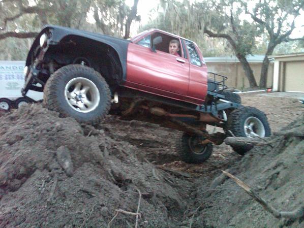

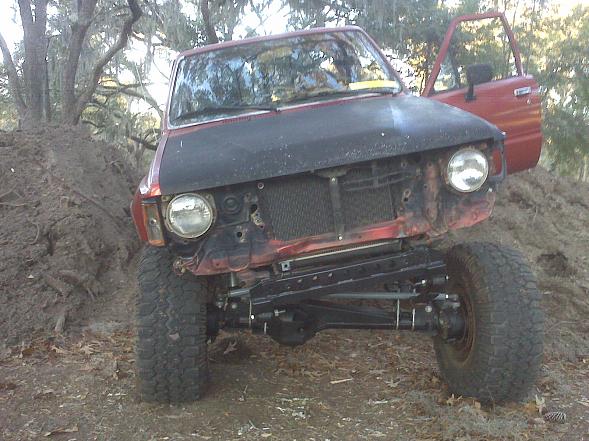

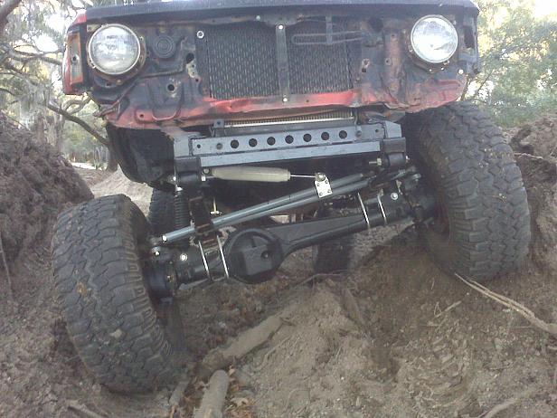

Here is a few pics of the toy recently. I found some dirt hills to play around on and try to flex it alil bit. Ready to get out back on the trails.
