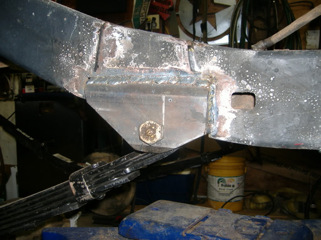

found these on Pirate:
Frame cut for hangers
French hangers
