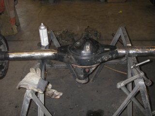

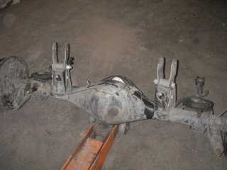

axle pulled then cleaned up
Attached Thumbnails another coil to leaf swap-rear-swap-009.jpg   another coil to leaf swap-rear-swap-017.jpg   another coil to leaf swap-rear-swap-023.jpg

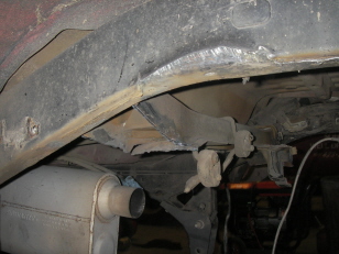

then clean everything off of the frame
Attached Thumbnails another coil to leaf swap-rear-swap-019.jpg   another coil to leaf swap-rear-swap-020.jpg   another coil to leaf swap-rear-swap-021.jpg

do some measuring and hang the springs
Attached Thumbnails another coil to leaf swap-rear-swap-025.jpg   another coil to leaf swap-rear-swap-026.jpg   another coil to leaf swap-rear-swap-027.jpg

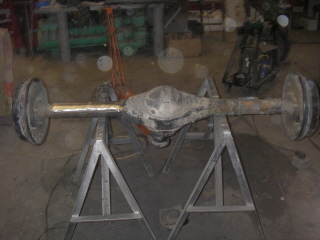

axle hung and perches tacked on
Attached Thumbnails another coil to leaf swap-rear-swap-028.jpg   another coil to leaf swap-rear-swap-029.jpg   another coil to leaf swap-rear-swap-030.jpg

prches fully welded and axle painted

its done. the rear didnt end up being too much higher than the front and once the springs settle it should sit fairly level.

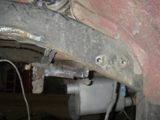

heres some pics of how i mounted the shocks. the lower mounts are the ones that came with the kit and the upper ones are made out of some rectangle tubing and square tubing and they are welded to the stock x memeber.
the shock angle seems to be working pretty good so far they are angled back and a tiny bit inward

heres a pic of the shackle angle which also turned out to be exactly where i wanted it. im not positive on these but im pretty sure the shackle hanger is 5 1/2in forward of the very back of the frame and the front hanger is 3 1/2in toward the rear from the square hole in the frame. if you need these measurements i will go and measure to make sure they are exact.
