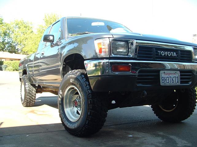

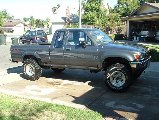

I've had and wheeled a stock 1991 toyota xtra cab pickup for 3 years now and its time for an upgrade. It does pretty good as is, stock with 31 muds, but I want to advance my wheelin.
I picked up a front axle of a 83 yota this weekend, and I'm buying some 35's off of a buddy for way cheap. I think you see where I'm goin with this.
I'm a poor college student so money is limited. Whats the best/most affordable way for my truck to be solid axled and sitting on 35's? (By the way, I have access to a full fabrication shop full of equipment and tools)
-Thanks
