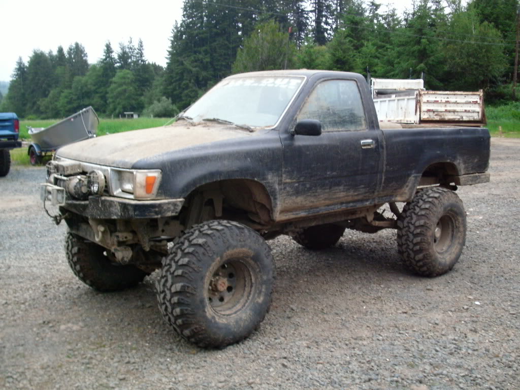

heres an old crappy pic after my ruf swap..

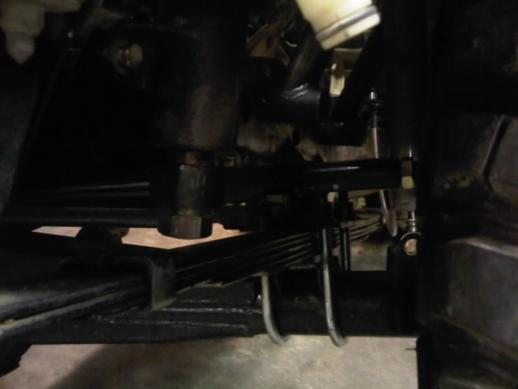

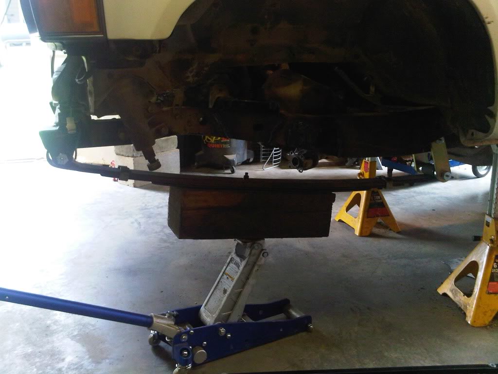

I can't run the box in the factory 3 holes. You can see in the picture where it was close to hitting at ride height. The setup I have right now works great though. The flat pitman arm helped out alot. I plated the frame somemore since these pics were taken. Sounds like a good idea though Wabbit. I could cut those sleeves off and it would prolly work good. I'll look into that.

With the spring flat it has good clearance.
