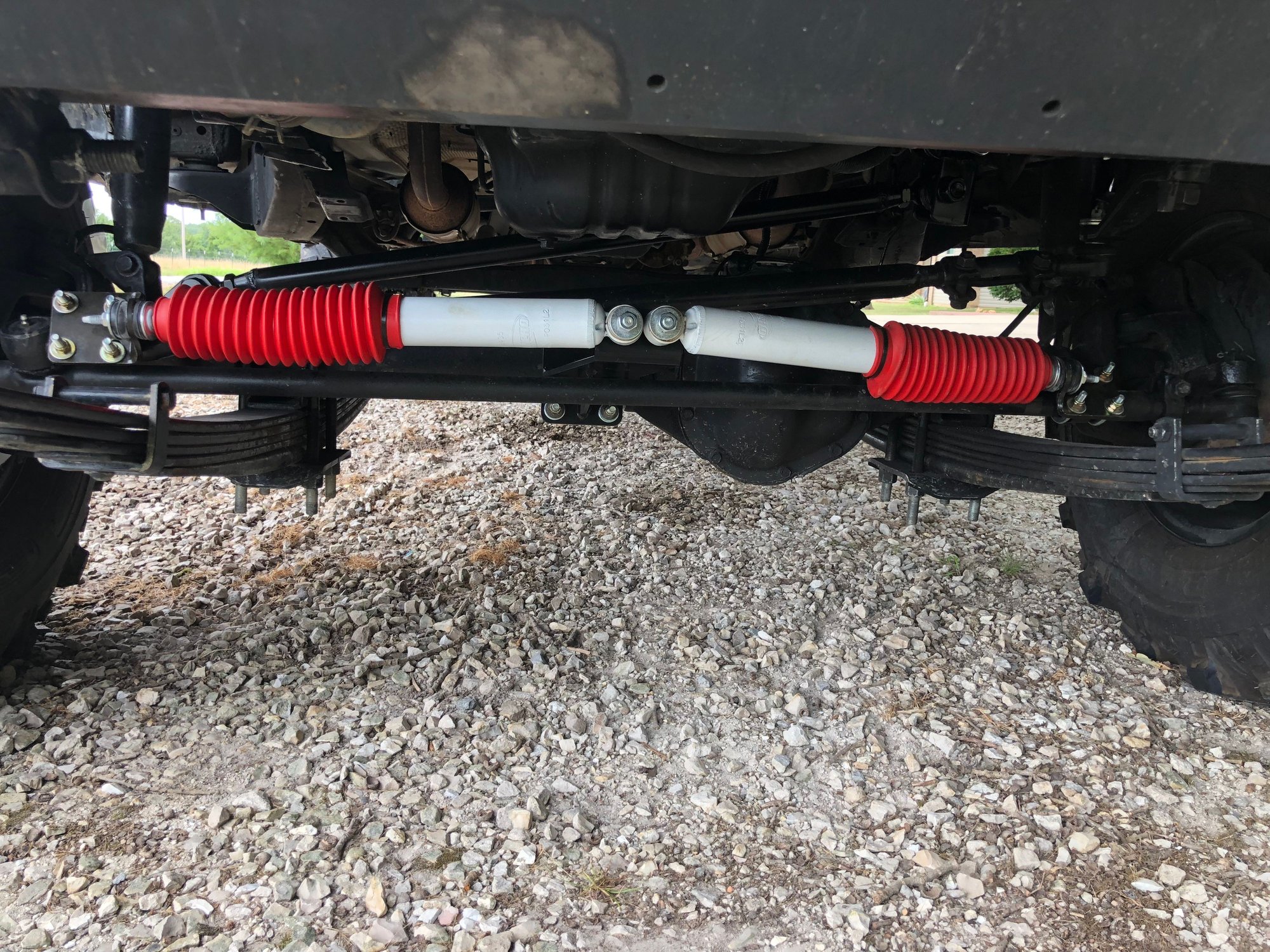

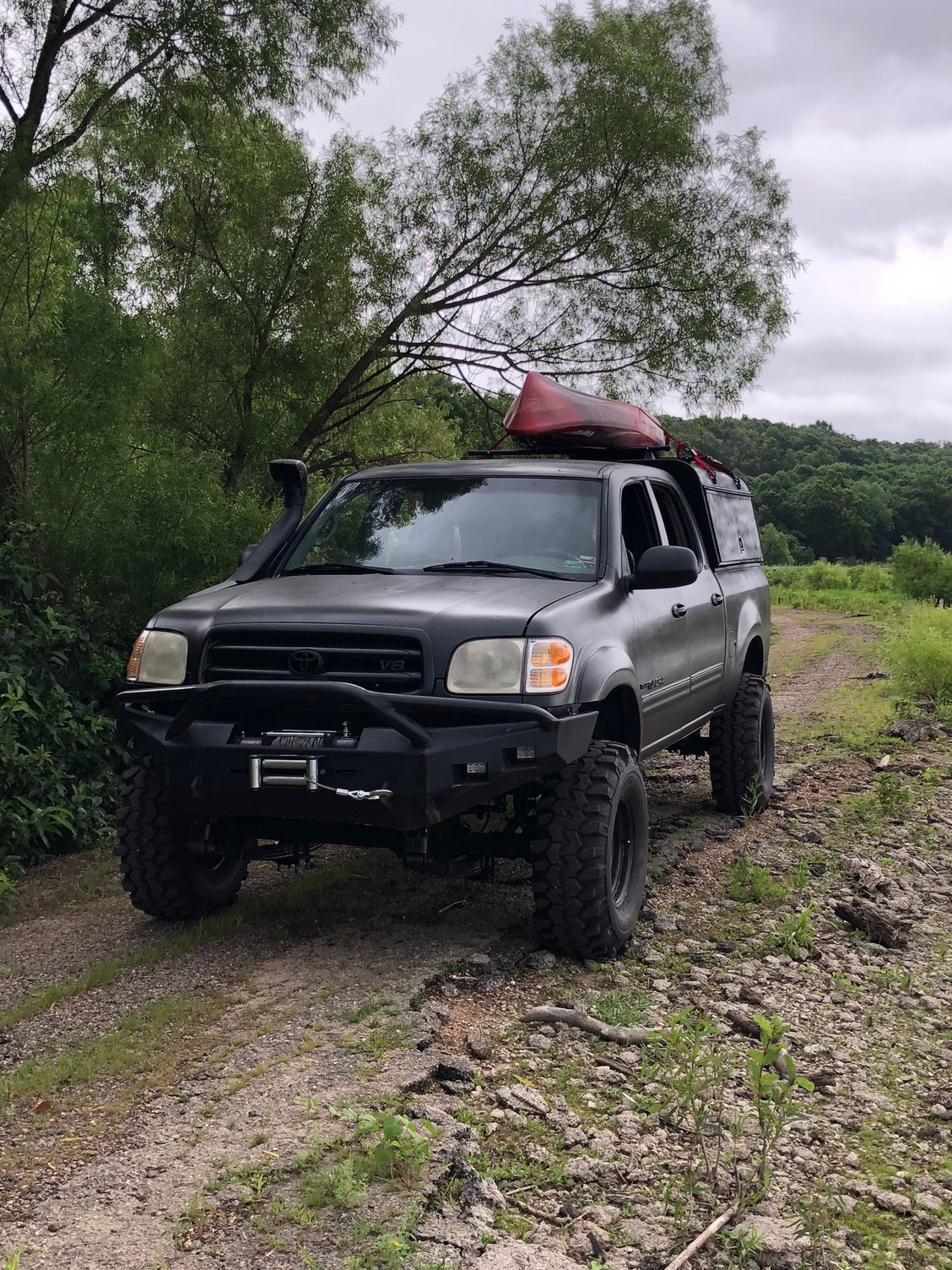

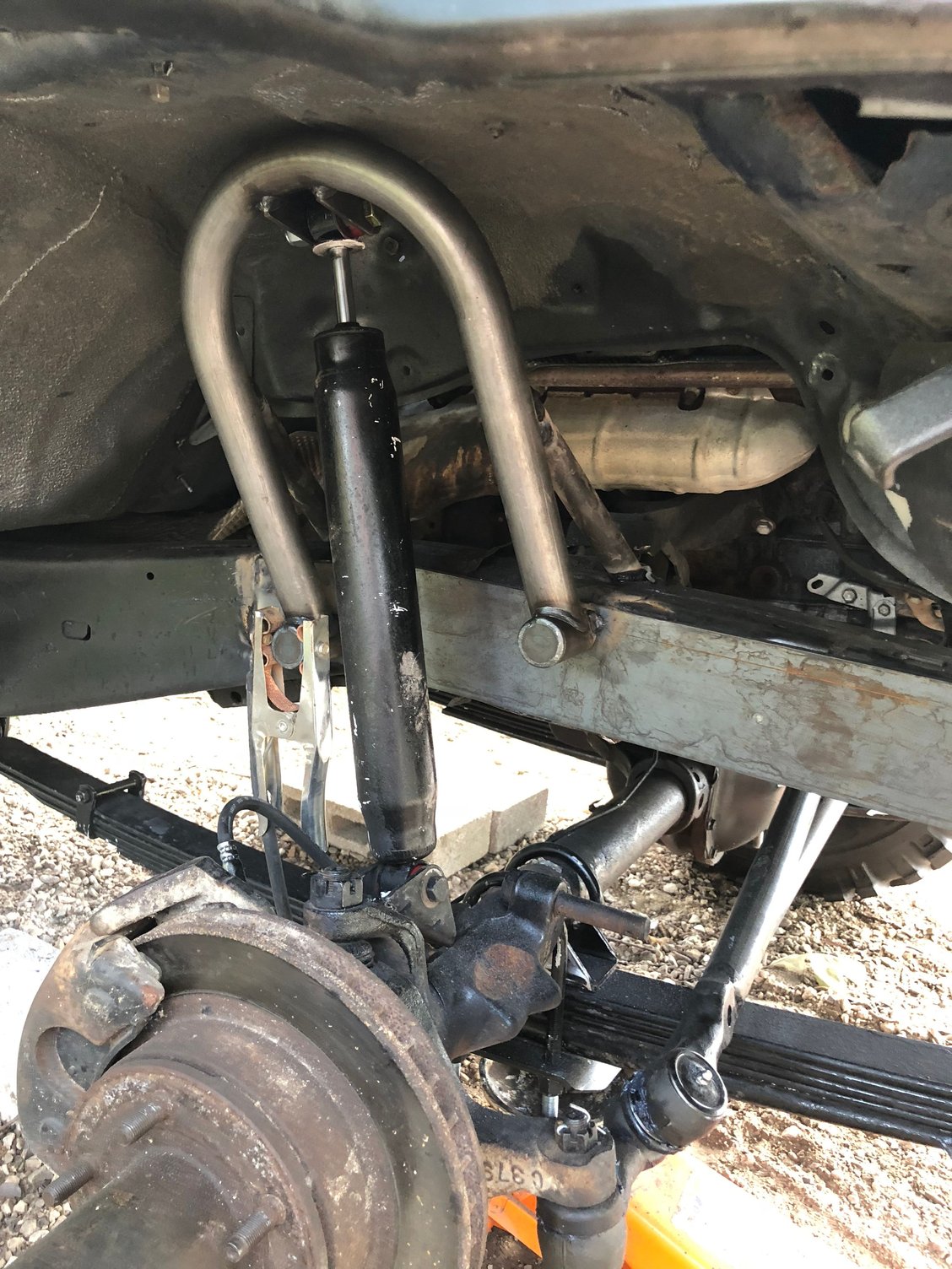

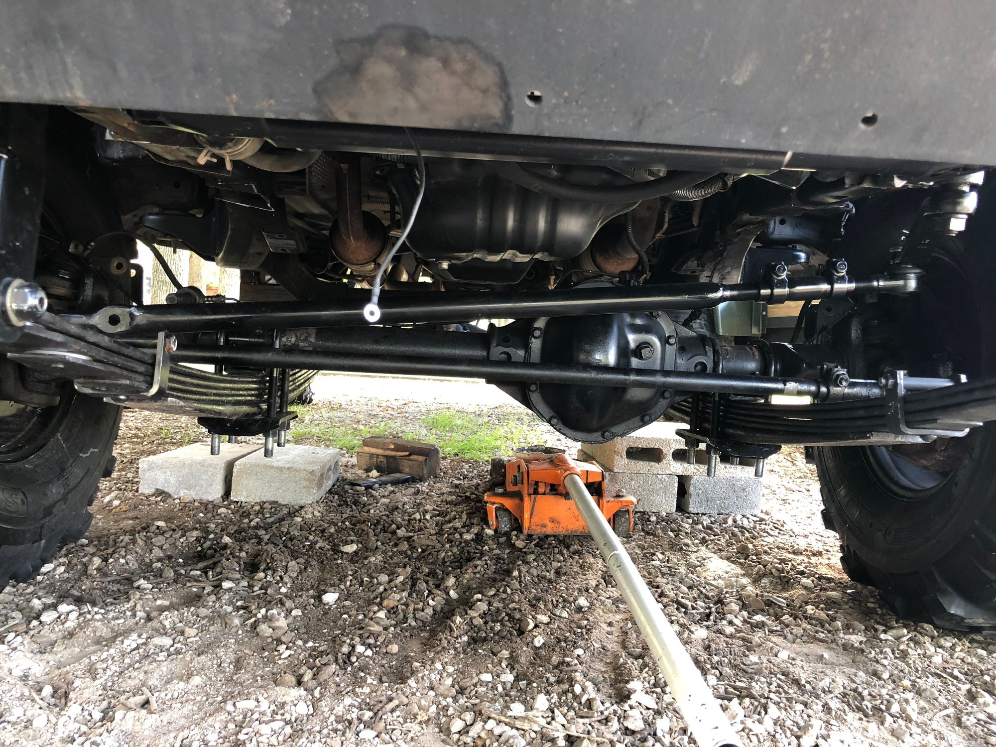

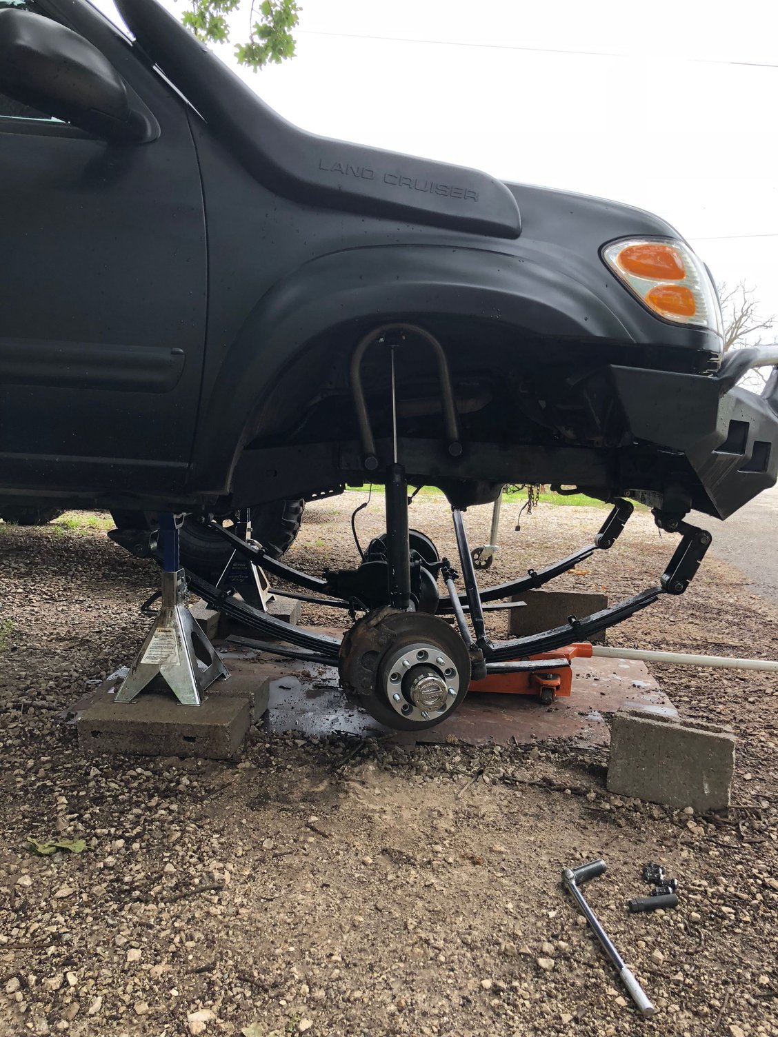

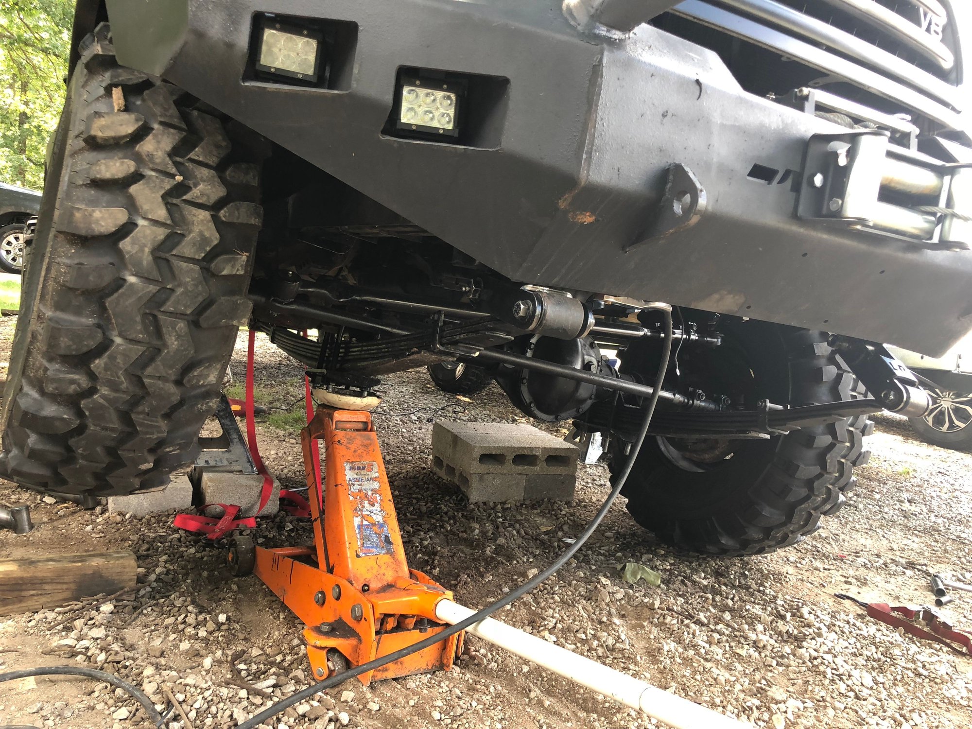

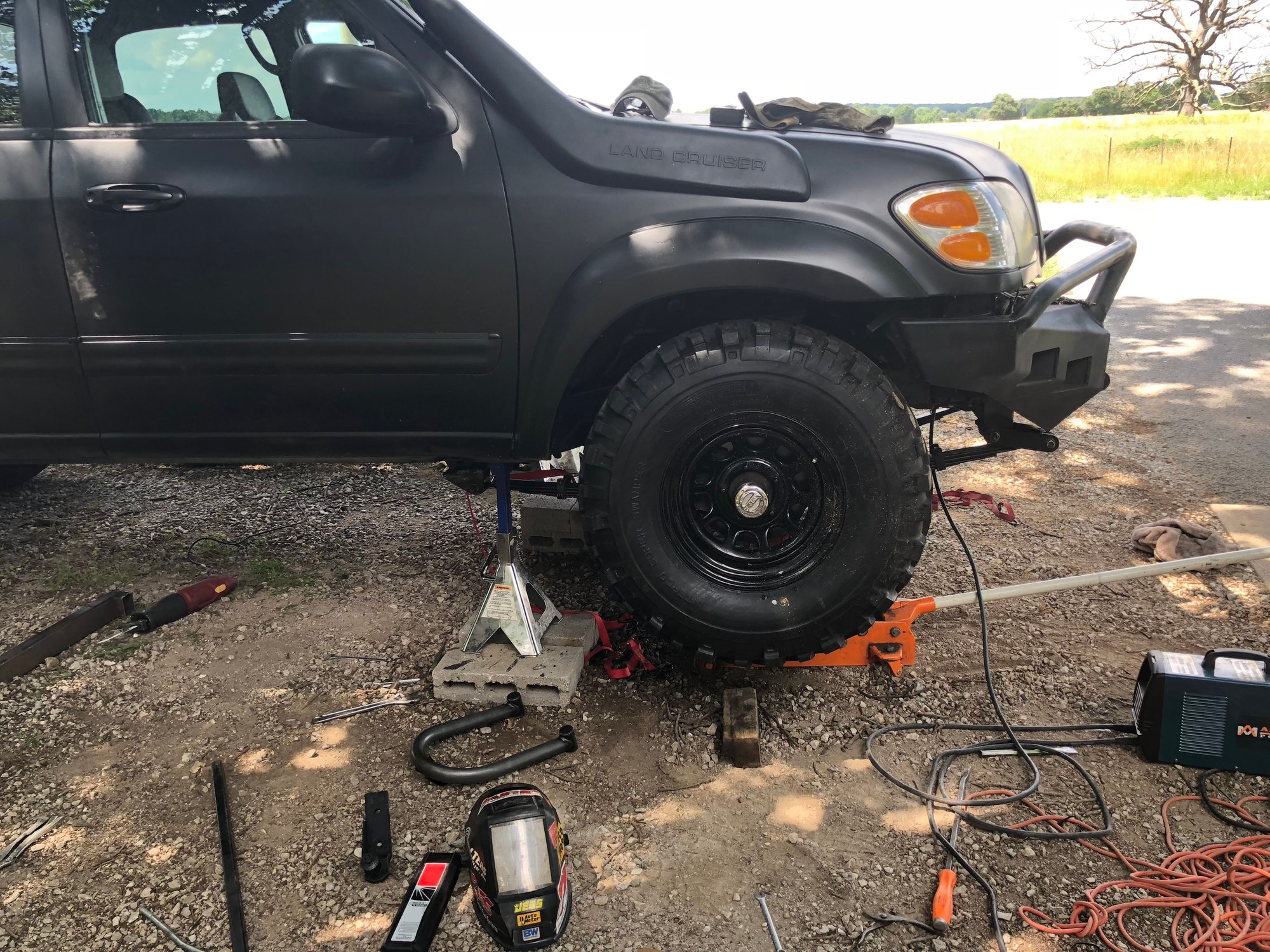

Here’s a bunch of pictures of the sas I did on my tundra it’s a Dana 44hp from a 79 bronco, 4.10 gears, and 63” Chevy springs

Surprised this got no love. I dig it man.

Thats freakin wicked. Cool truck, and loving the spring under.
Whats up with those front shackles? Do you pin the upper shackle to the frame when on the road?
