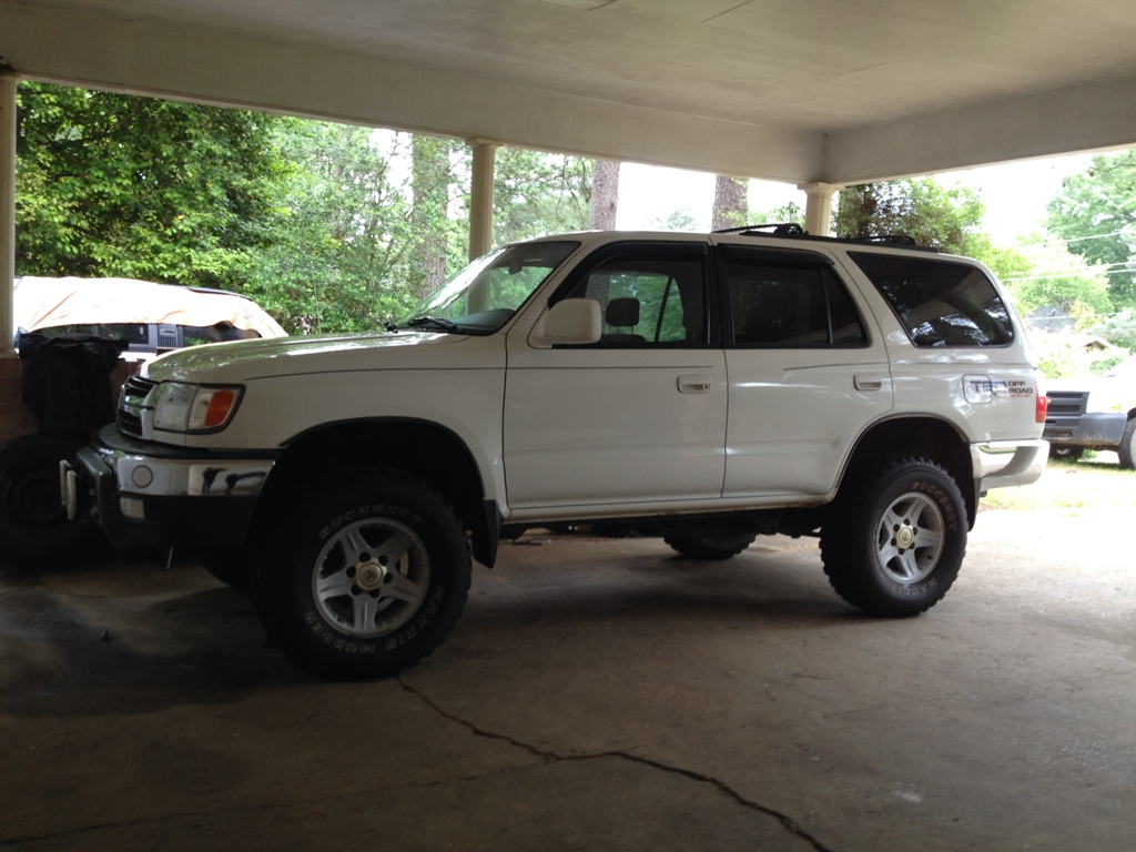

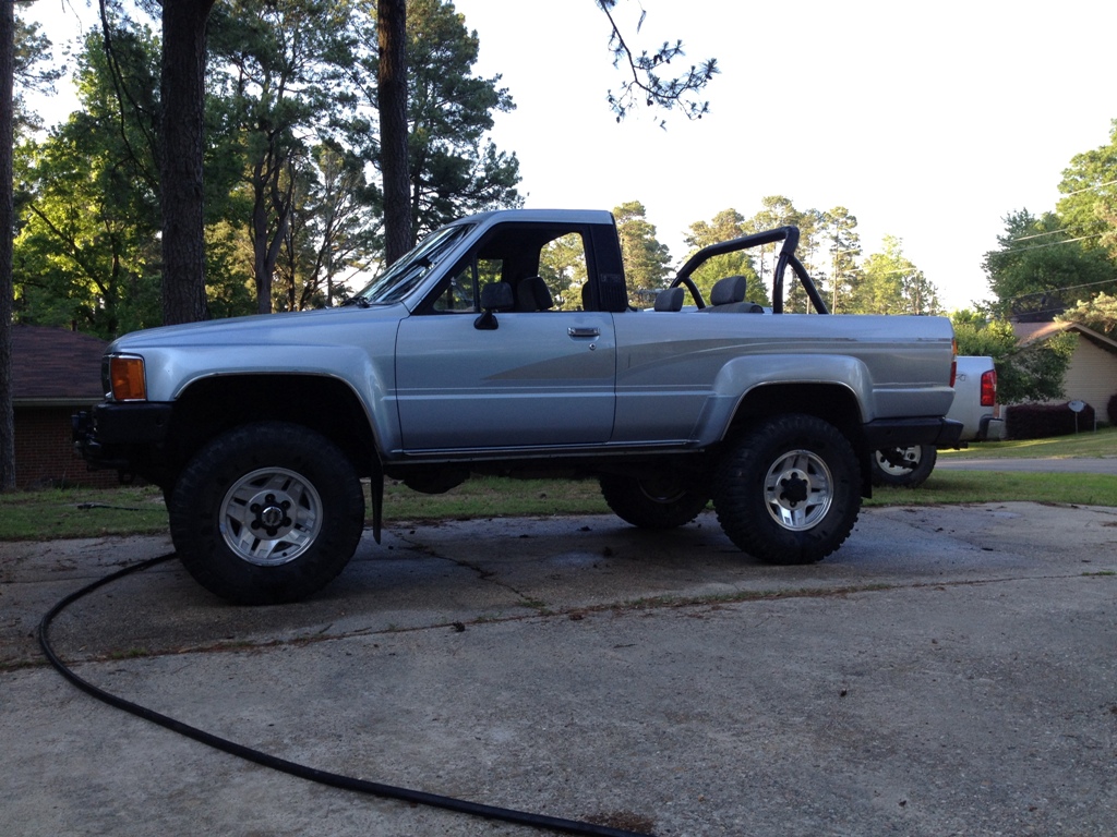

I think you may be thinking of the 3.0L as far as reliability. The 3.4 is the V6 in 96-2004 model trucks and 4runners. Pretty bullet proof motor with good fuel economy. 22RE is arguably the flagship of Toyota in last 30 years. Just I thought I'd throw the option out there. Search 3.4 swap on this forum if you're not familiar with this popular upgrade. I haven't pulled the trigger on my swap yet since my old 3.0 is still running so good but I've been planning it for the last couple years. I bought a wrecked 2000 4runner a couple months ago with 150K miles on it for $225. Good powertrain and lots of parts for my 2002 Runner as well. Good deals are out there if you have what you want in mind and a little cash in your pocket. I have $4800 tied up in all four of these. Bought the 89 for $300 and put another $300 in it. Bought the white 88 for $150 for parts. Sold the rear end and paid for it. Got the white 02 for $4000 and the gray one for $225 for parts. Sold the seats and some interior trim and paid for it. The blue and white one are now in great condition and I have a TON of great parts to use or sell.
