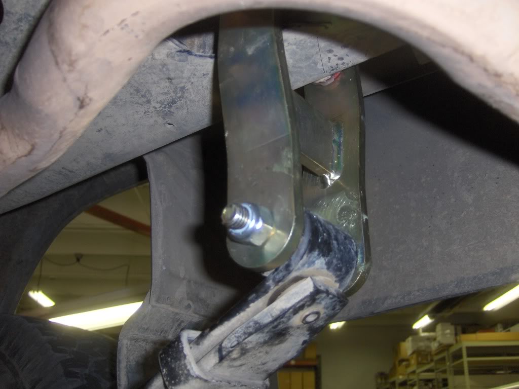

Originally Posted by funnyguy44444
I have the exact same truck as you hartzog, I'm gonna put 2" ball joint spacers in the front and add a leafs in the rear to get some more clearence this summer, toytec has a kit with the parts to do all this for $200.
Just a word of advice, I did the kit from toytec on my truck, then ended up removing the add-a-leaf after about 3-4 months, in favor of shackles. I also got them from toytec. They are the 3 inch lift shackles for the 95.5-2004 tacoma, so it equals out to about a 2 inch shackle on the T100.
It flexes much better, and doesn't have nearly as harsh of a ride.
Like I said, just my 0.02 funnyguy.
