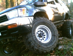

because you dont wheel on a regular basis it is a waste of money unless you are a regular rock crawler, or technical trial runner or trailer your rig they are a waste. Here are pics of my truck before I added the last 2" these are 35X15.5R15 lift the truck more then get big tires
