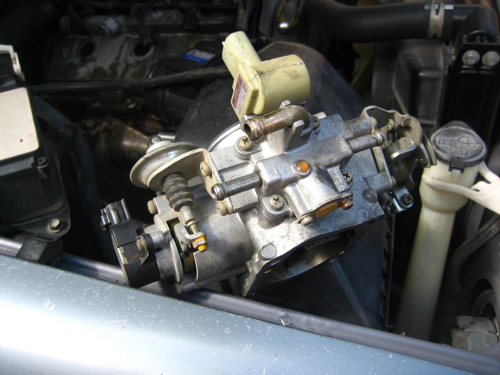

Pull the timing belt cover and check the timing belt. There should be about 8 bolts that hold it on. You might have to move the upper radiator hose clamp to pull the cover forward enough to see the cam gears/alignment marks. Snap some piccies of it and post them.
The IAC should be under the throttle body. One wiring harness connected to it and 3 hoses (2 coolant and 1 vacuum air). The shutter valve should rotate around 90°. The electric motor is covered in a greenish plastic cover. This is what it looks like under the throttle body...

Throttle body flipped over...

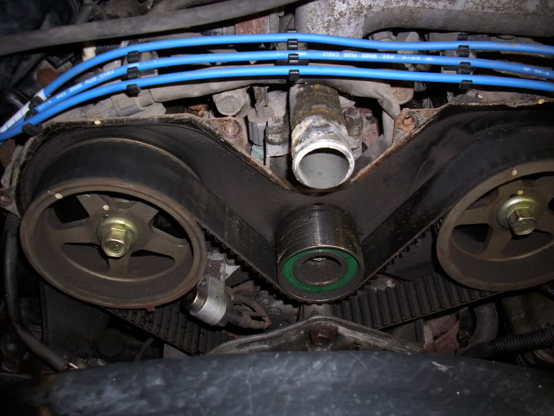

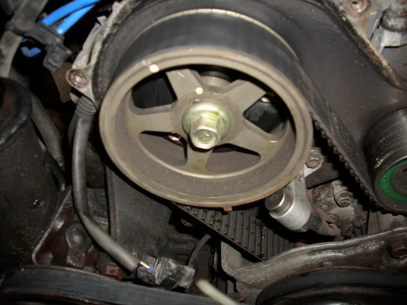

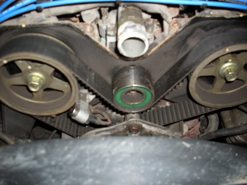

pics as promised:

Dave...snap some piccies after you rotate the engine so we can see if the timing marks on the belt and the cam gear line up or not.
