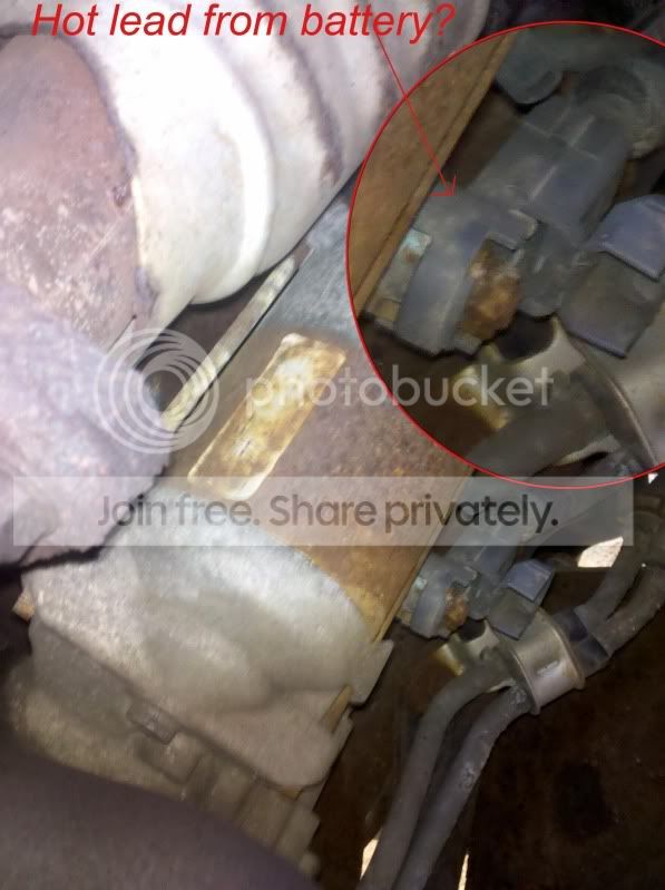

Here is a pic of the starter. I am guessing that the large gray terminal is the hot lead from the battery and I should see 12+ volts there. As Stated previously I am only seeing 9.5V.

Yup...that's the thick positive cable from the battery. You should be able to clean up that connection, too! If the cable is corroded (usually up near the battery connection), yer gonna have to replace it.
