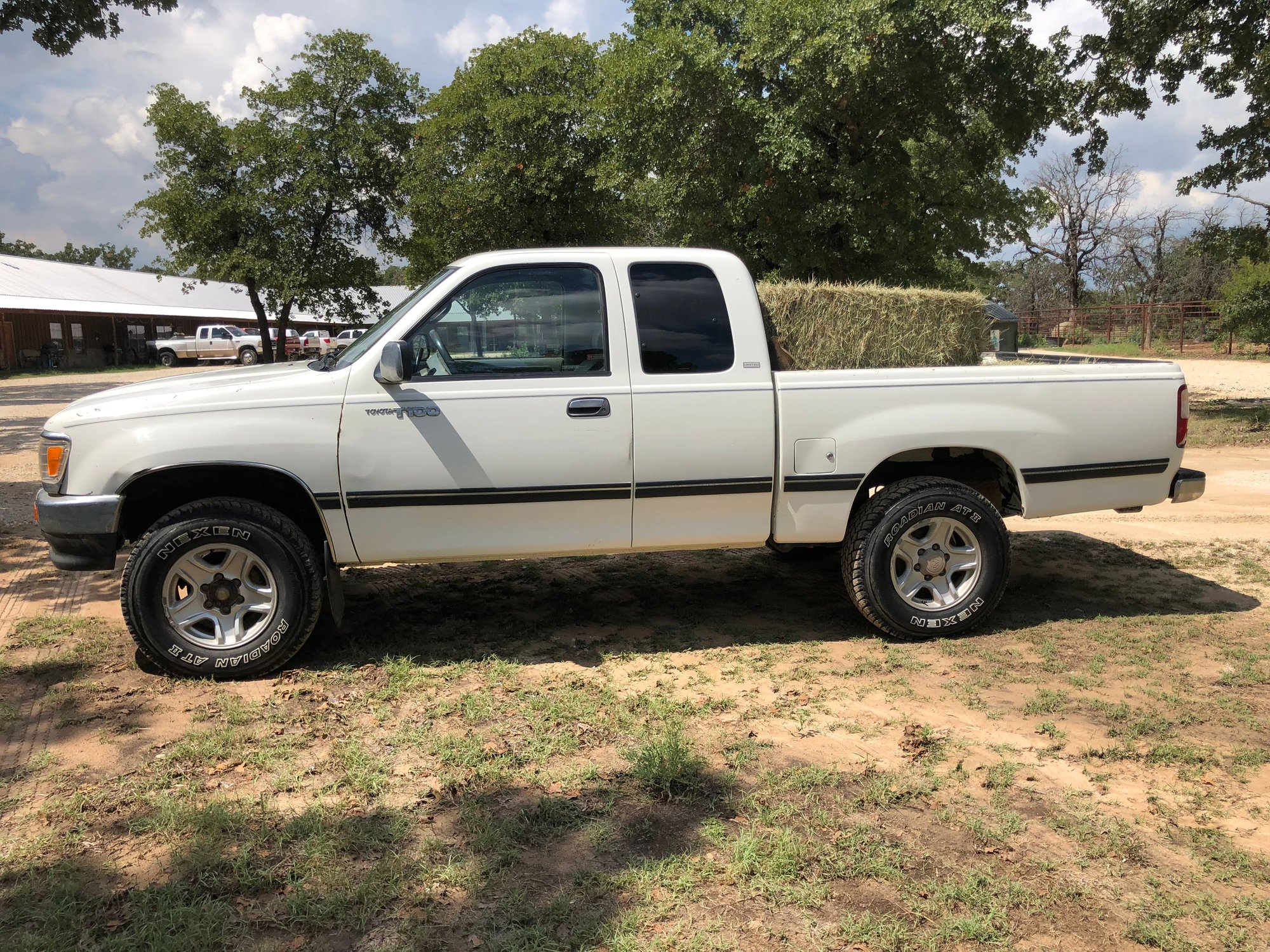

Hey everyone new to the forum here. I just got a ‘97 T100 3.4l auto 4x4 and have been trying to breath life back into her after being parked for 8 years. Lots of little things as you can imagine but I’m stuck on a couple last problems and the local shops have been less than spot on so far. So far have done the following: battery, fuel pump and filter, spark plugs, injector #6, security shutdown relay, coolant temp sensor, downstream O2 sensor, coolant flush, thermostat and some AC work. Everything is stock but for a hollowed catalytic converter(which might be part of my problems). When I first got the truck, the tailpipe was pointed up too high and the exhaust had melted the insulation off of the taillight wires and had begun to melt the actual taillight assembly. Had someone comment that it was really hot just standing back by that part of the truck. Figured a clogged cat was causing the extreme heat so I hollowed it rather than buying a new one. Truck spent many years as a ranch/hunting truck then was parked for 8 or so years.
1. Truck starts and runs great, until it warms up then looses a ton of power at higher rpm. Runs ok around town and at lower rpm but falls on its face when you ask it for anything more. Seems like a temp sensor of some kind that changes timing/fuel mixture based on engine temp. Maybe running good with a cold start mixture and it never changes causing it to run too rich at higher temps? Anything over 2k rpm I get a hollow rattle not and engine rattle or knock just maybe a loose heat shield or something but it sounds terrible. Haven’t been able to drive it much but it seems to be using way too much fuel. Would like to avoid a new cat if the O2 sensors can be tricked like the older style can be but I know I might be better off going back with a new cat to fix O2 codes.
2. Cruise control doesn’t work. Green cruise light comes on but nothing happens. Cruise motor? Engine code that disables cruise? I believe we had to bypass the security cutout relay?? it was in a anti-theft mode when I first got it running I think.
Thanks in advance any tips would be greatly appreciated.
