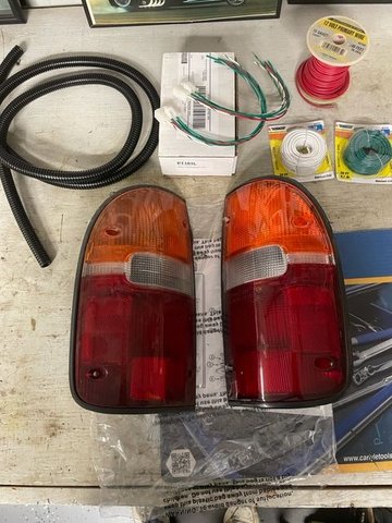

Started splicing in the harnesses tonight, these are well made.

Thanks for the feed back. If you plan to solder the connections, you'll enjoy the wire I use, it's high temp wire intended for fuel injector harnesses, so the stuff basically doesn't melt unless you really try hard. That's why the wire is a little stiffer than stock besides possibly being a larger size.
Good luck with the project, hope all works out well for you.

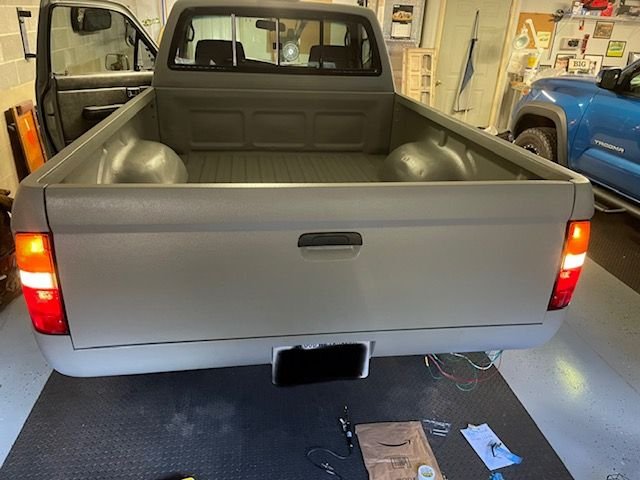

Got the tail lights wired up, the correct color coding on the connectors made it really simple. I did solder all the connections and the wire held up well.

Nice, glad all worked out well for you. Also good to hear the wiring colors matched, I don't get much real life feed back on that, but the wire diagrams tell me the colors, so I hope they are right lol.

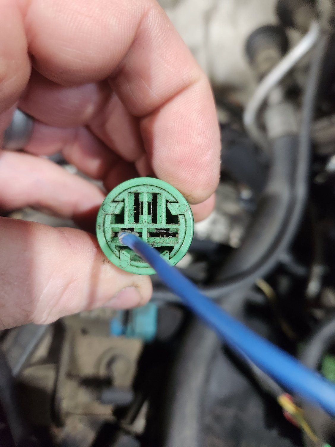

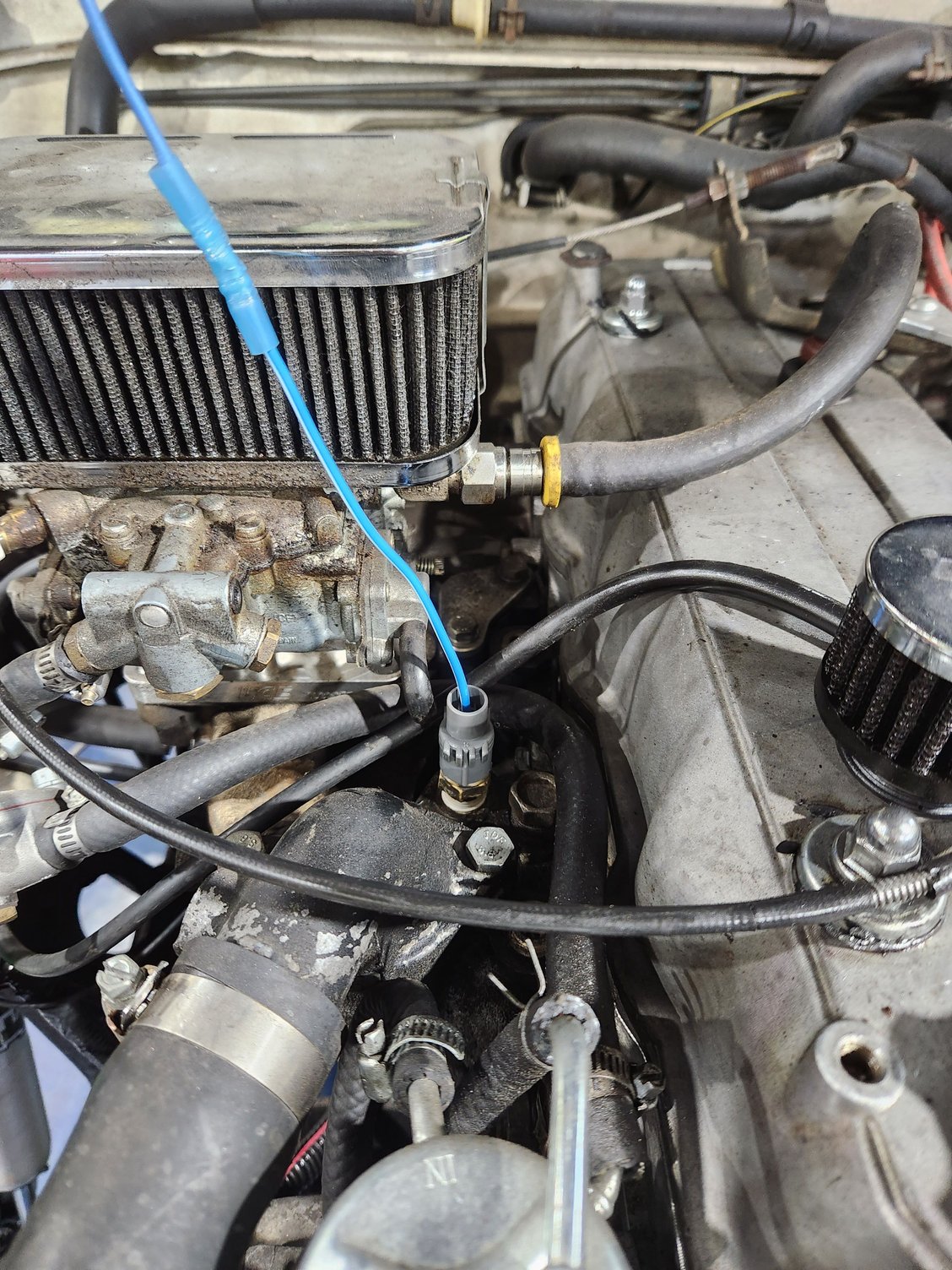

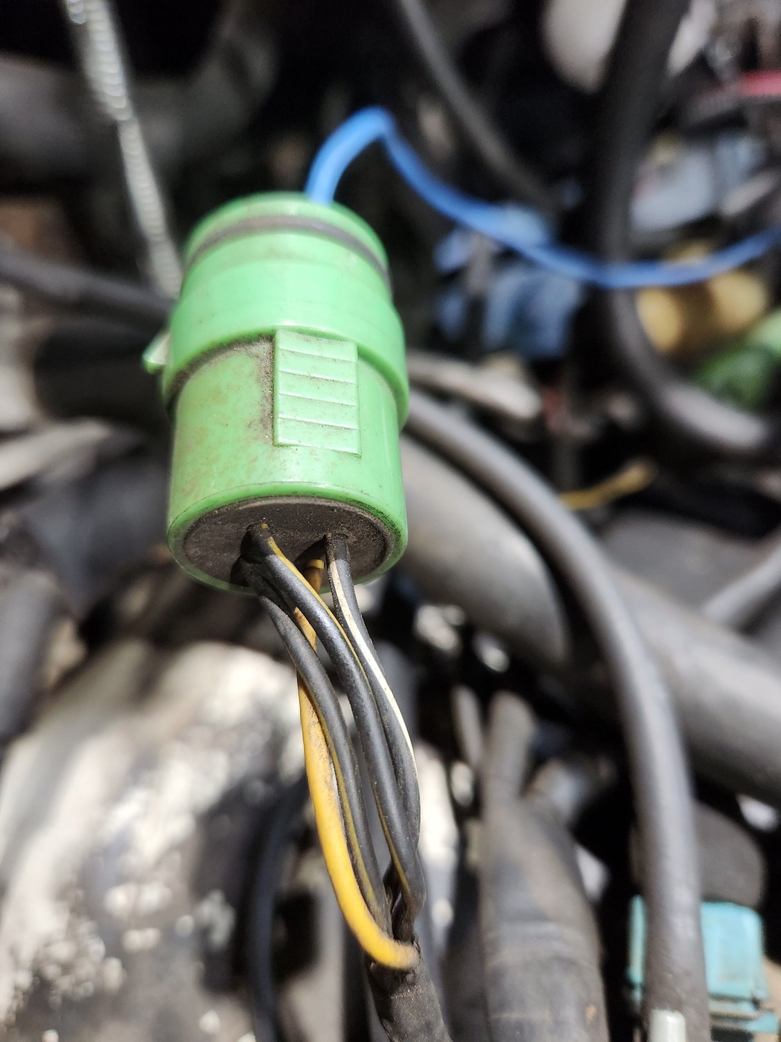

My name is Jeremy and I am need of a wiring harness for the passnger fenderwell of 1985 Toyota 4x4 Pickup with 22R not 22RE. Should be a harness that connects to the temp sensor for the gauge and the temp sensor for the a/c. I attached some photos of where the harness I need would plug into. Is this something @atcfixer may make?

It's been a while, but if I remember right I was trying to get the details on that harness but couldn't find someone with it to help me check pinouts, wire lengths, and connector types. If I had all the info to build the harness, I probably can get the connectors and make them.
